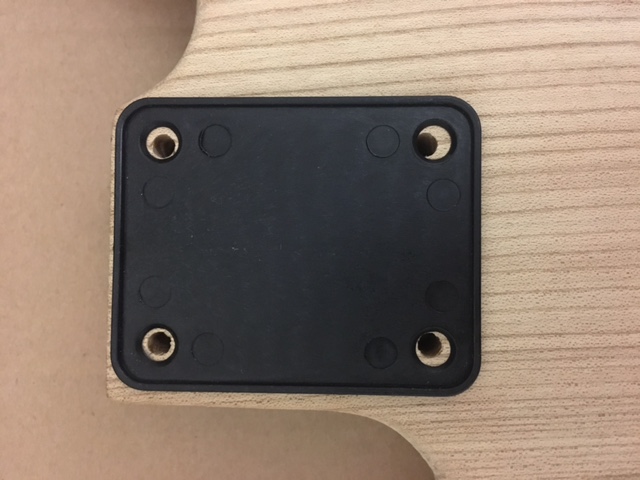

    Ive done a fair amount of sanding to get the neck to fit the pocket, and I'm finally happy with it now, but i do have an issue with the pre-drilled neck cavity. Somebody who drinks more than me had their way on this one in the factory. The holes do not line up with the neck plate. And even if they did, they are too far off centre for my comfort. On the bass side I only have 5-6mm from the edge of the neck to the centre of the screw, which i fear may lead to the wood splitting etc.
    So Im going to have to plug the holes and re-drill. Given I have next to no wood working experience, and almost no tools, can some one wise please suggest my path forward? i.e. where can I source 4mm dowels? is PVA wood glue sufficient, or should I use titebond? Any other tips and tricks I should be aware of?

    Great to see another JMA build. The holes for the neck mount on mine were slightly off compared to the back plate. But doing up the screws from corner to corner and a bit at a time it centered up ok. If yours are a long way out plugging and re drilling is an option. I would work out which one or two are the worst and just do those. Can we see a pic with the plate over the holes? A bit of dowl and pva should do the trick, I realigned my tuner holes using that method. If you are in Australia there is a big green shed that will stock what you need.

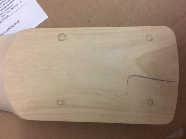

    re neck pocket holes - i need to plug all of them i feel. I could use two and plug two as you suggest but its not just the alignment of the four holes relative to each other. More concerning is the the fact that they are out of alignment to the neck. When you look at the pic of the neck heel where I've market the screw positions you can see 2 spots are far too close to the edge. 2.5mm to edge of screw for one and 4mm for the other

    Bummer.....definitely too close on the top side.
    Hmm yeah, agree. That's a shame but not unfixable.
    I usully plug mine with a bit of oak dowel from Bunnings and timbermate and redrill.
