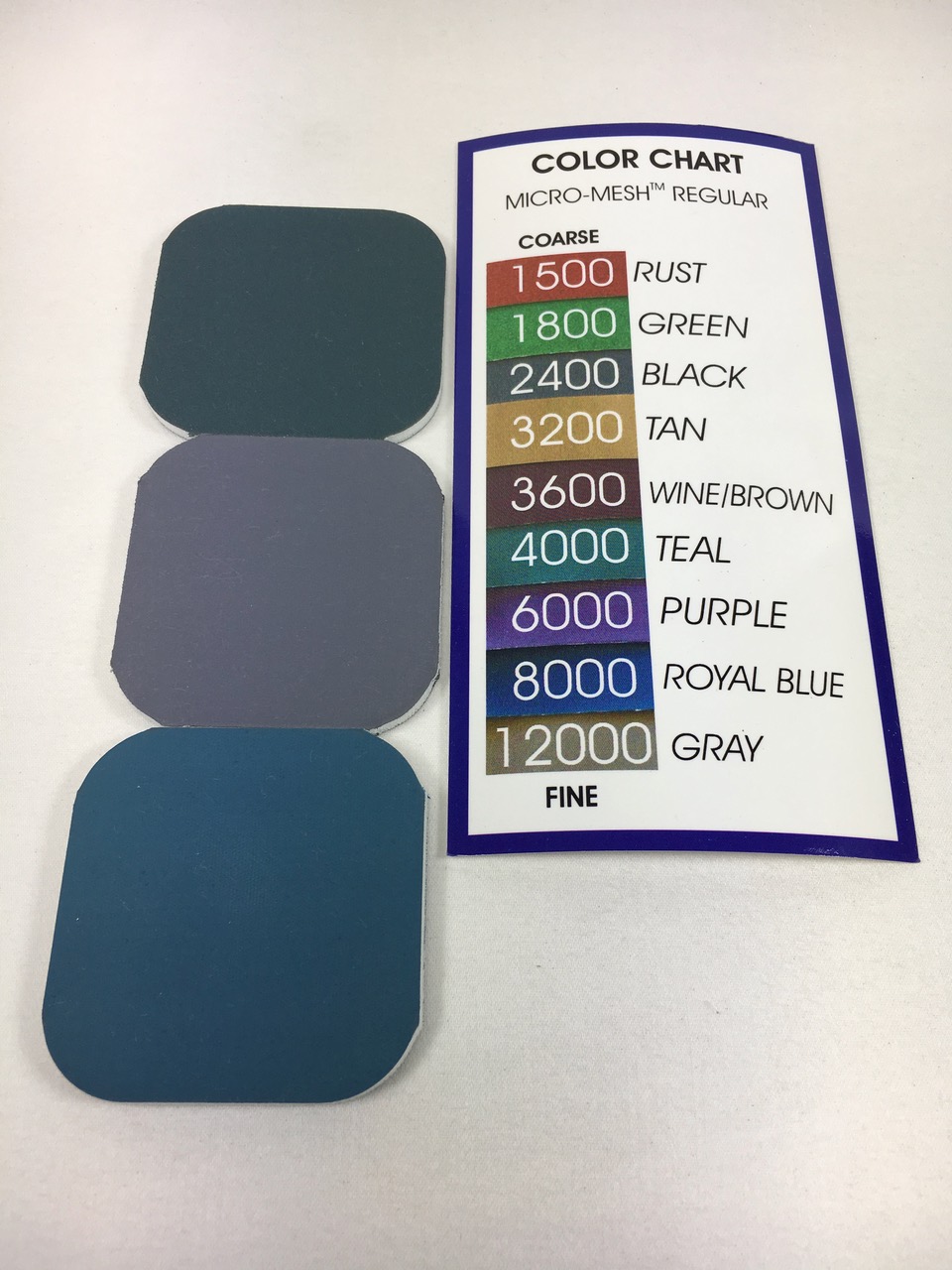

    Is it just me, or does anyone else struggle to tell which coloured MicroMesh pad is which?
    The ones I'm really not sure about are the 4000 and 8000 grits - which are described as 'Teal' and 'Royal Blue'.
    I've just done the guitar in what I think is the 4000, and it has a lovely reflective finish.
    Switched to the 6000 ('purple') pad, and started on that, and it seems to be making things less reflective, more of a satin finish. I'm worried that I might have started with the 8000 by mistake? I may have to get the scrap piece out again to try a few combinations, just to check I've not got the colours confused.

    Here's a photo that the sandpaper people sent me when I checked with them... I assume the one on top is 4000, then 6000 in the middle, then 8000 on the bottom of the photo.

    Which one did you think was the 4000? If your finish is thick enough, it shouldn't be a problem to go back and continue through the grits to the gray.
    I'll check with my pads that I got but haven't used yet and let you know. I think you have the order right but lighting can play funny tricks on the eyes.
    Quote Originally Posted by mjg View Post
    Looks to me like the 'black' on the chart is more like Grey...and explains the result.
    So from top to bottom Teal 4000
    Black (grey) 2400
    Royal Blue 8000
    cheers, Mark.

    Thanks guys. I started with the one that looks like the top one in the image above. According to the instructions the 4000 and 6000 should be satin finish, with 8000 and 120000 high gloss. Not sure how I've ended up with a reflective finish with just what I think is 4000 then.
    I know the purple one I have is definitely 6000, because it's got '6000' stamped on the back in ink. Why they can't do that with all of them I don't know. :-)
    Each of the pads in the 2 kits I have ordered did have the numbers on the pad.
    In your pic it looks like 4000 Teal, 6000 Purple, 8000 Royal Blue from top to bottom.
    Where is the Grey 12000 as that one does amazing things once you have done a solid job with 8000.

    I've had another look at the guitar inside under internal lighting, looks completely different compared to outside in full sun. So I suspect it's all ok...just got a shock when it went from reflective to satin when I went up from 4000 to 6000.
    Next weekend I'm going to double check it all on my last bit of scrap, and also probably just do one quarter of the back of the guitar right through 4000, 6000, 8000 and 12000 to confirm I've got the order right before doing the whole guitar.

    Thanks Mark. I'm pretty sure it's not the black one, as I ordered a kit with just the finest four grits. But goes to show how hard these things can be to identify without the context.
    IRL, let me know if you check out your kit and find anything different. I'll have another go at this next weekend and let you know how it turns out.

    I had a look today in the sun. The teal has a more green/grey shade to it. The blue is... well....blue.
    Looks like you have them in the right order.
