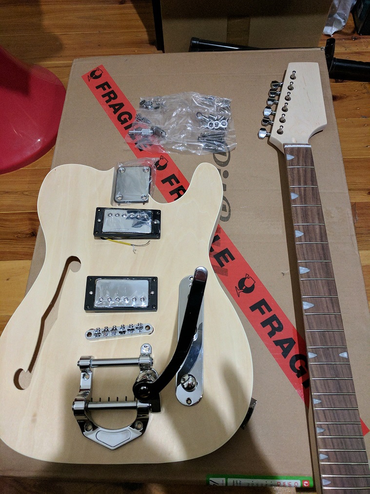

    Just bought a TL-1TB kit recently because of a 15% discount on eBay
    I put together guitars before from finished parts, but never done any sort of finishing so this will be a good learning experience for me. Expecting to make mistakes, in fact the more the better
    I've also bought some amber and brown wood stain to try and get a Honey burst finish, along with Tru Oil to finish
    Few things I have noticed so far:
    - The humbuckers dont fit the holes. Looks like a bit of the wood will need to come out before they fit.
    - A bit of the binding in the neck pocket hangs over the edge. I'll need to trim a little off.

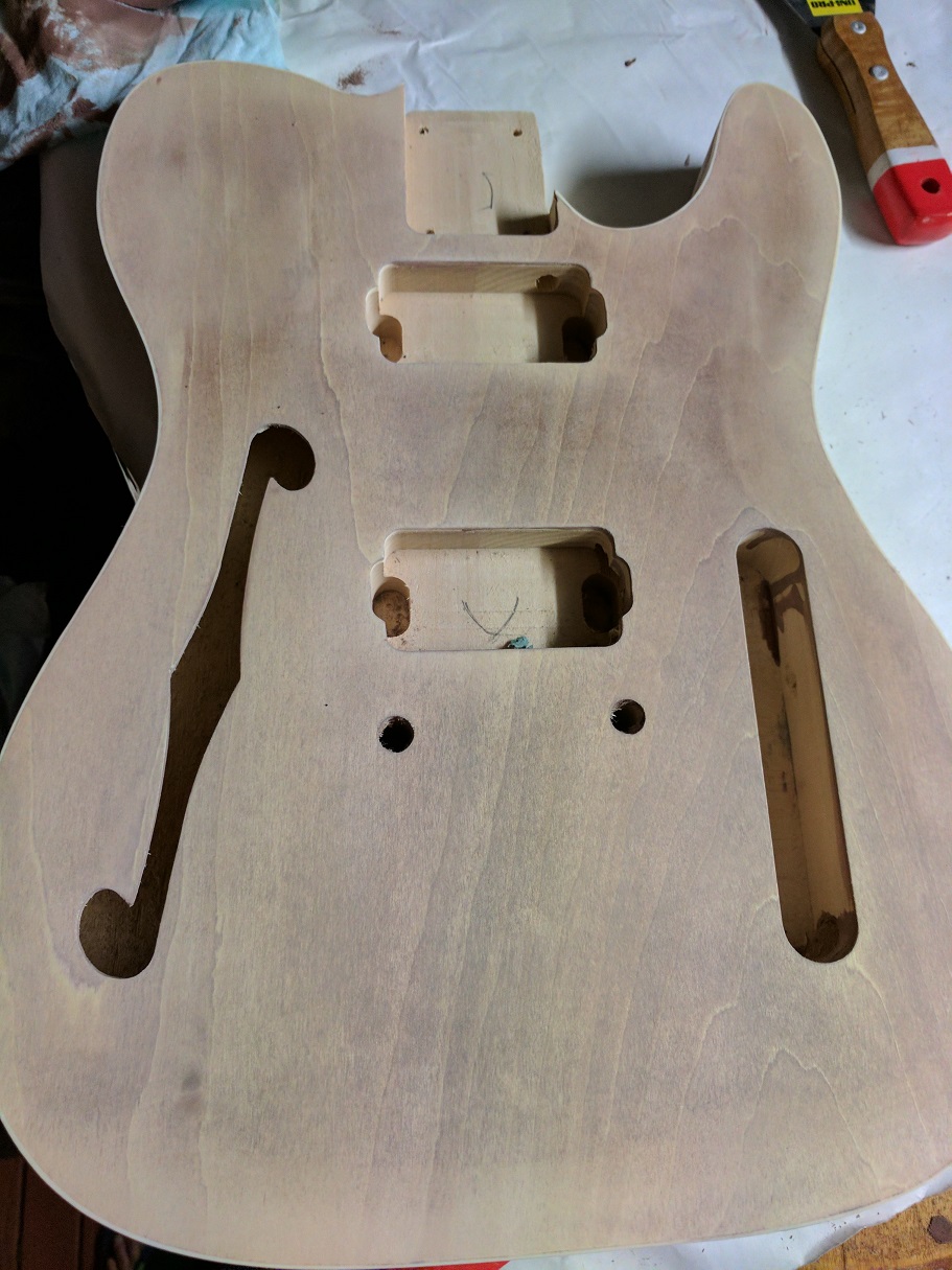

    Test fit

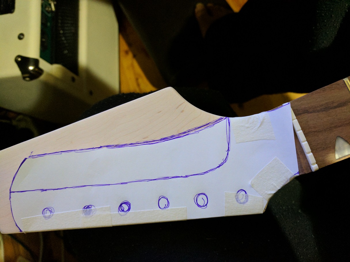

    Decided to go for a headstock similar to the new Parker design, but with a longer shelf thingy (Sorry not sure how to describe it)

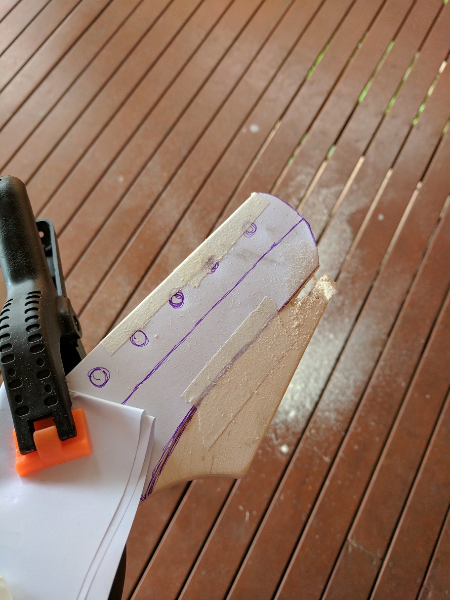

    Using my trusty Dremel trio to start cutting

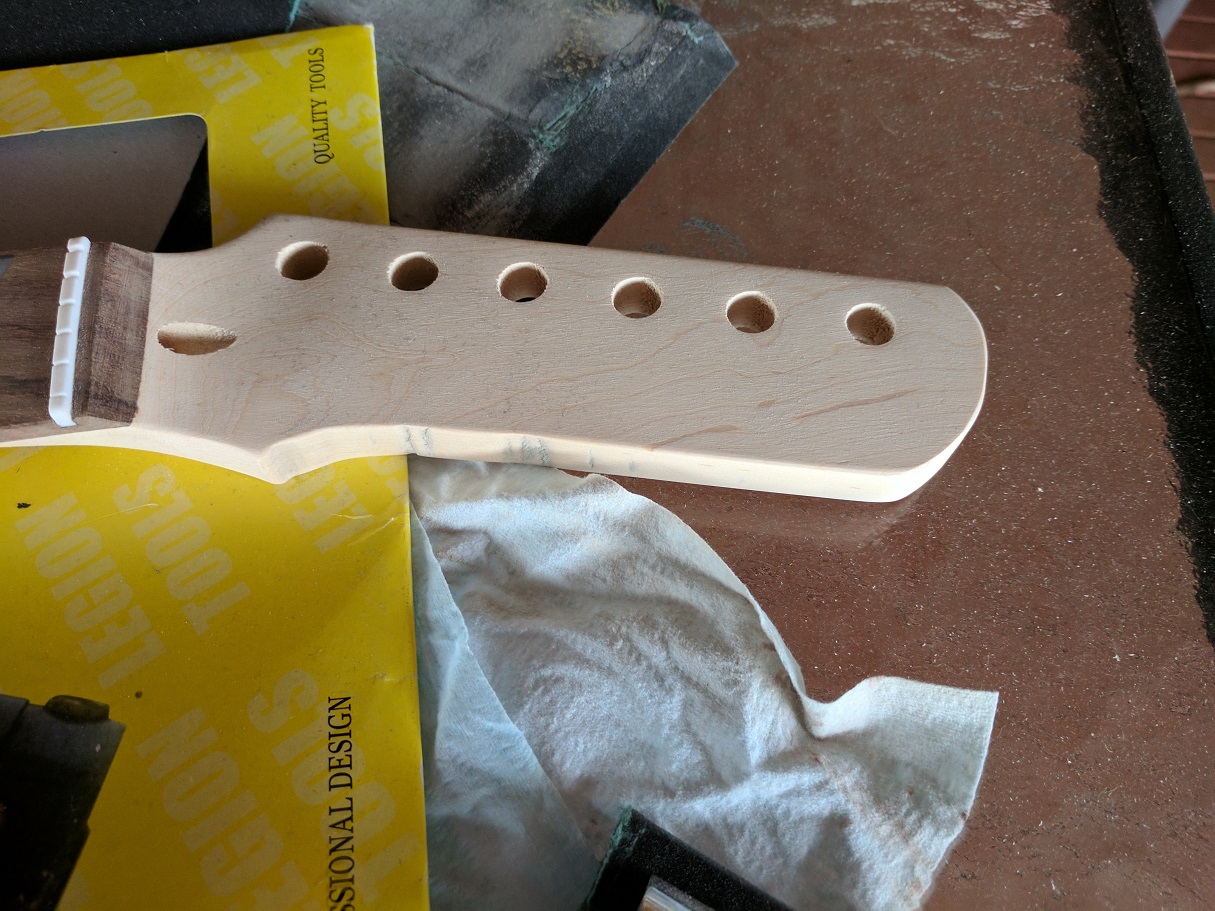

    Alright first part done! Now just need to figure out how to make this shelf

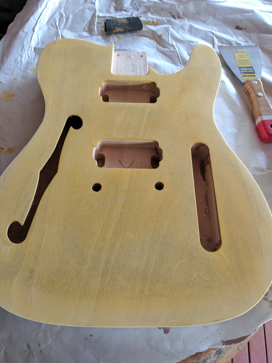

    Onto the body

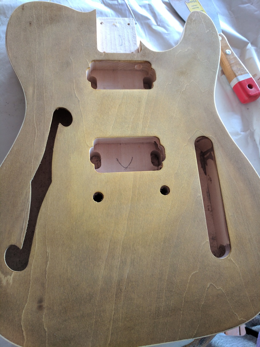

    Used walnut grain filler on the surface but regretted it and tried to sand back as much as possible
    First yellow stain applied

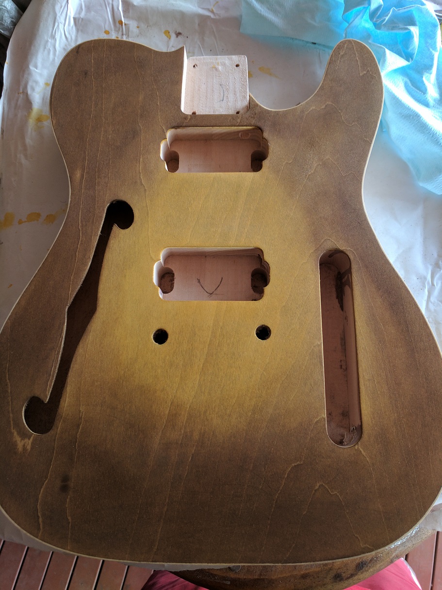

    And now the brown on the outer layer.
    At this point, I had been diluting the stain with a bit of water but decided to try the stain without being mixed with water
    Much darker
    that an original shape Sock ! round the edge near the high E tuner hole and file the machine marks and sand and it will look tops !
    keep working the burst
