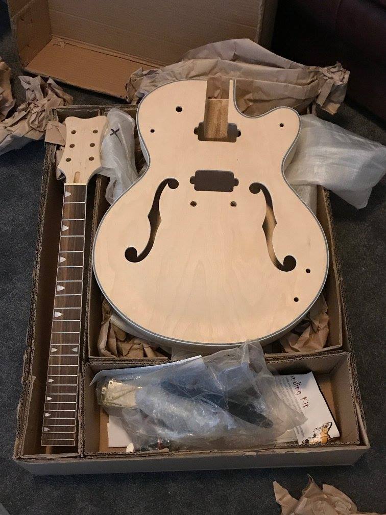

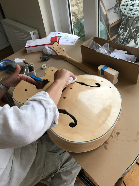

    Here's the unboxing. I'm very pleased with the build quality. The neck needed a bit of adjustment, but a couple of slight turns with the truss rod made it nice and straight.

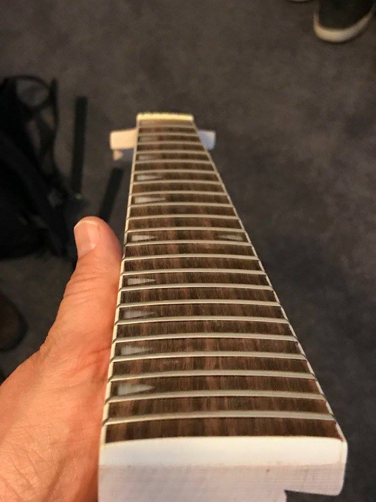

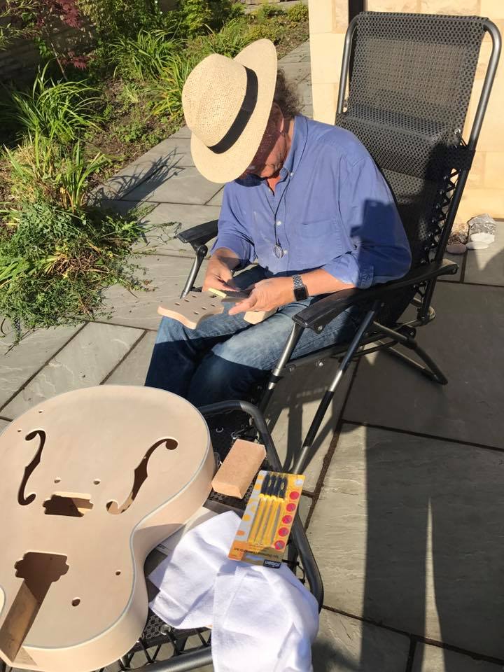

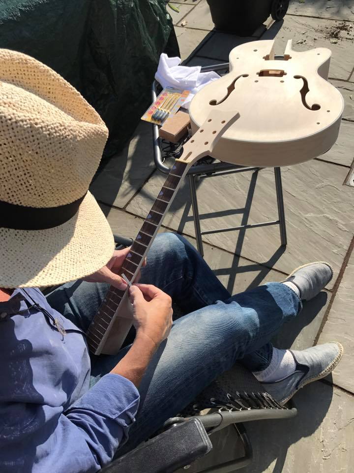

    Spent a nice sunny day sanding and taking burrs off of frets.

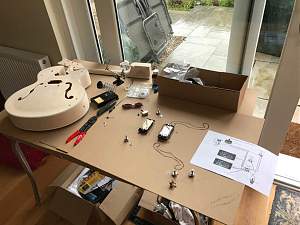

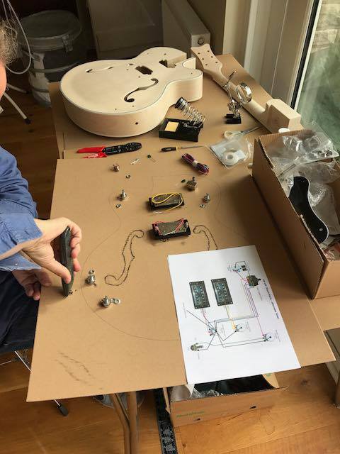

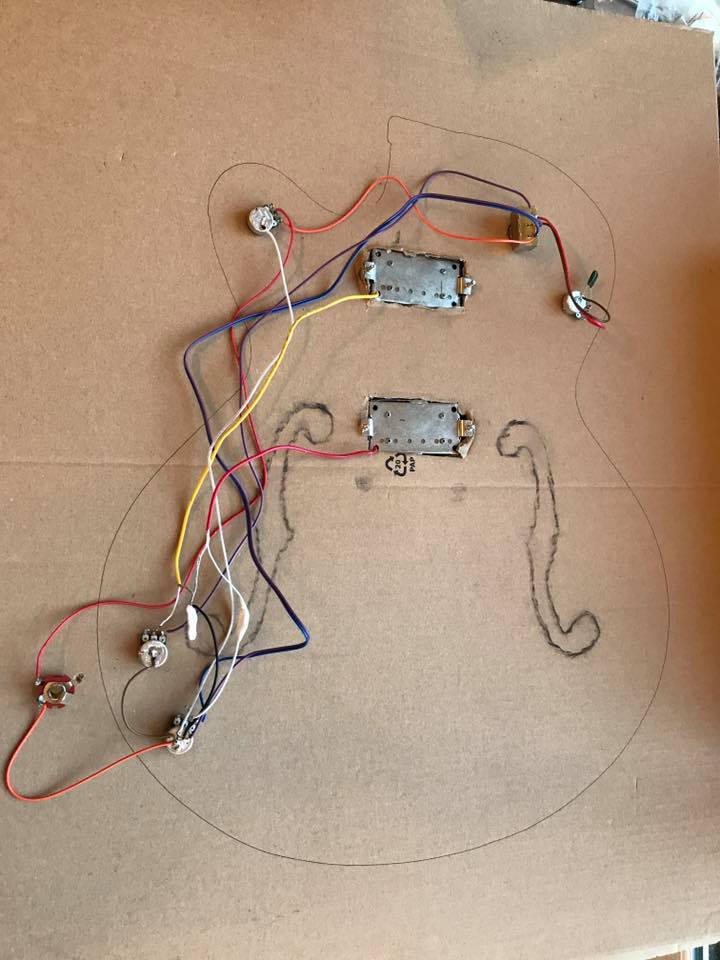

    Getting the electronics ready. I used some vellum and a HB graphite pencil to make a rubbing, then created a cardboard template to assemble the loom. I used the alternate tone wiring scheme found here. Although I was too lazy to do the ground jump on the third pin of the pots (we'll see if I live to regret that.) I've plugged it in to my amp, tapped the pickups with a file, and everything works! No hums or buzzes either. It's been a long time since if done any soldering, but it all came back to me. I used to solder my own MIDI cables because I liked to have custom lengths, so this was familiar to me. Next step is the finishing. I'm going for natural with Tru Oil. Depending on the drying time, I might be finished by the end of the week!

    After doing the rubbing with an HB graphite pencil, I went over the lines with charcoal - that way it was easy to transfer them to the cardboard simply by flipping it over and rubbing over the back of the vellum.

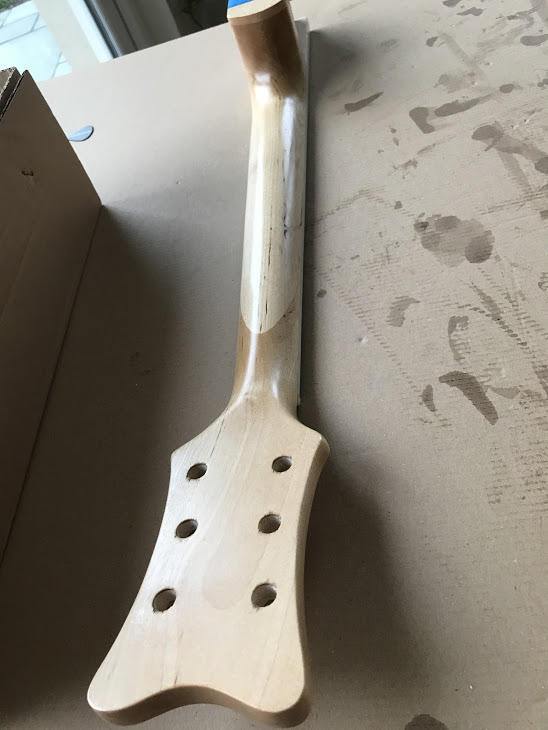

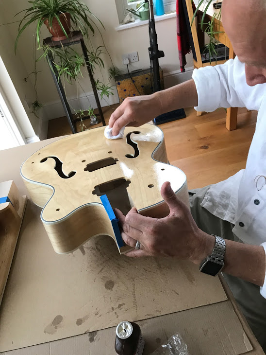

    In the final stages of finishing. I'm amazed and pleased at the results I'm getting from Tru Oil. The neck is finished in just three coats. I've done four on the body and will decide tomorrow after 24 hours of drying if I need any more.
    Putting the 4th coat on the body:

    The finished neck - a really nice satin sheen in the light. It feels great too - can't wait to play it!
