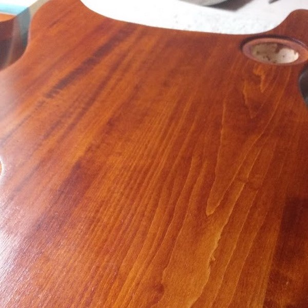

    Got this back end of August, using Crimsons amber stain and their finishing oil... turning out a lot darker than what I wanted but its growing on me...slowly....all I need to decide now is the top..what colour...any ideas?

    All up to you, mate. The back looks nice. You plan on using Crimson stains for the top as well? That limits your choice of exactly what colour to use. Ignore the colours you definitely won't want to use and what are you left with?

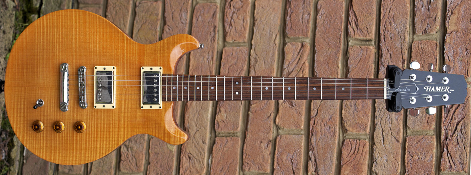

    I've got a Hamer Artist which is quite a similar shape to the PRS. The back's about the same colour as yours.

    Its top has a great flame, but it's not really brought out like it could be. In most lights you can't see the flame from any distance. But had it been popped so that the flame was much stronger, it would have a superb look.

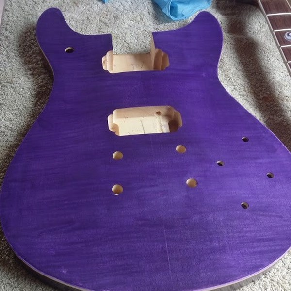

    Gone purple since I had it .... a couple of glue spots which would not remove, stained the top let it dry a while, lightly sanded with 1500 then re applied, covered it up better but not perfect.. hey ho...
