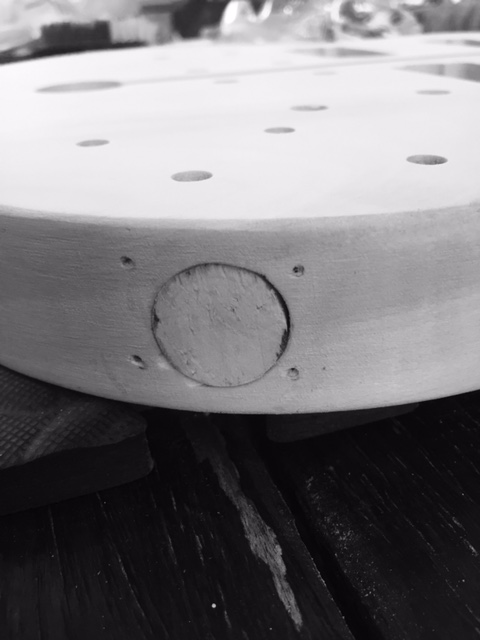

    This is a a jack hole i plugged in my SGD-612

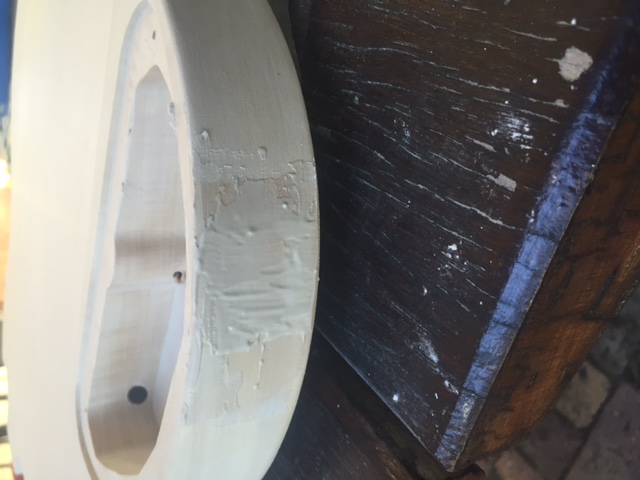

    The body is Basswood. I used a bit of pine for the plug and a LOT of Timbermate

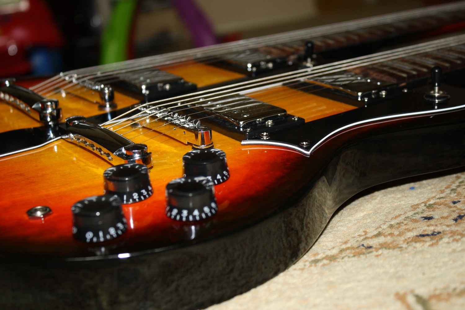

    I then stained with at DT burst, Black stump is on the edge. 3-4 stain coats and 3-4 intensifying coats
    I cannot see the plug now...
