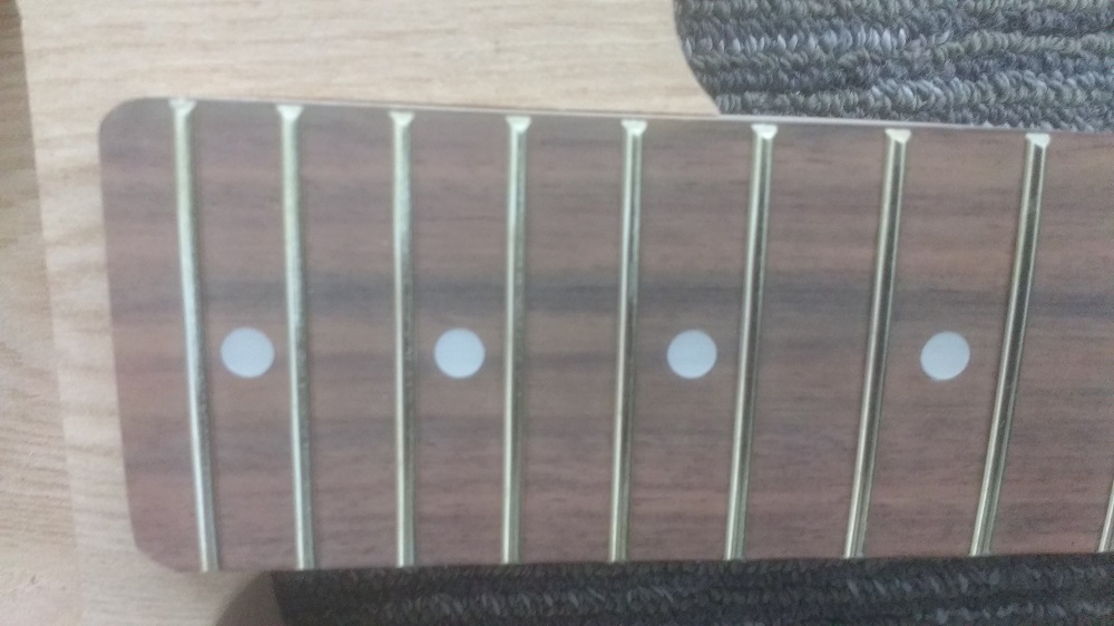

    Hi all
    I thought that I would start to get my ideas for these builds up to initiate some early feedback. I have bought two kits, with the intention of building two complementary fraternal-twin guitars. One is a standard TLA-1 (maple fretboard), the other a TLA-1R (rosewood fretboard), both being solid ash bodies. The intention is to finish them in the same Dingotone Black Stump stain/oil, use the same hardware (bridge, machine heads, control plate, etc), varying only a few aesthetics, choice of pickups and the switching/controls configuration.

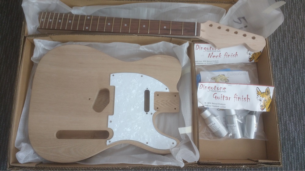

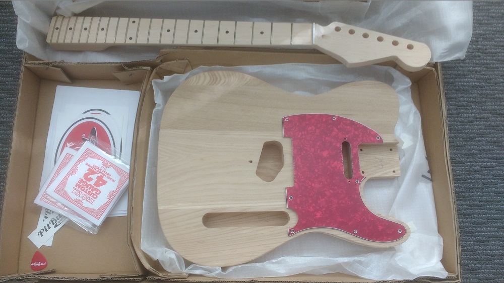

    Here's what I currently have:
    TLA-1:
    TLA-1R:

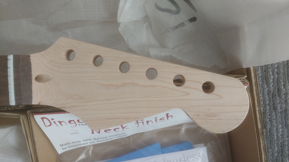

    The headstocks have been shaped by the boys at PBG using their Luthier Headstock Shaping service (look under Extras>Services on the website) to my design; not highly original, granted, but I think a nice blend of the two classic Fender shapes. Here's a close up:

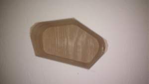

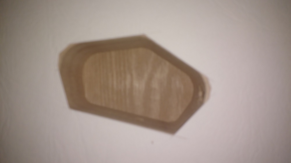

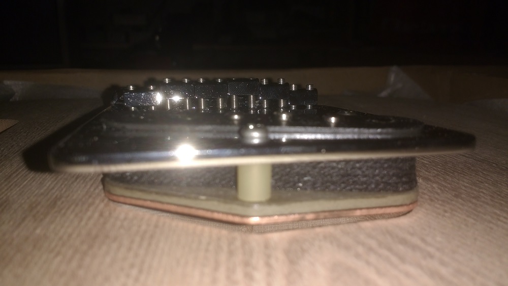

    First up, the bridge pick up rout is slightly too small (along the main diagonal) to accommodate the bridge pickup. There's only a few millimetres in it, so no major work required, but I'm not sure how best to tackle this. I don't have a router, so some combination of drills and files, and possibly a chisle, are likely to be the favoured approach, but any suggestions welcome. Below left image has a route template over the existing route; below right shows the bridge and pickup over the rout.
ID:	14060 Click image for larger version.
    Initial indication is that the position of the bridge pickup route seems to be correct, but I;ll do a more refined measurement once I have the rout widened and can get the pickup in.

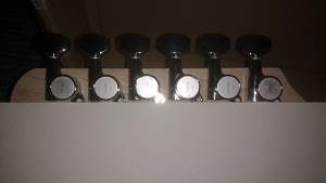

    Machine heads are a good fit in the factory holes, so no issues, and the alignment is pretty good, with only a millimetre or so difference between positions of the E, B and e strings, and A, D and G strings.

    I think most people have the tele bridge pick up won't fit issue. I used a small sanding drum in a cordless drill, it's not aggressive and a set of them isn't too expensive.

    Thanks for the tip Dedman, with a newly-acquired Dremel rotary tool I was able to expand the routes in next to no time. I have also today round filed the corners of the neck to get a better fit in the neck pocket, and drilled pilot holes for the machine head fixings and the neck bolts in the neck.
    Next weekend, I will hopefully have the time to measure the bridge set out, drill the fixing and string through holes, and maybe modify the pickguards to accommodate the larger neck pickups that I will be using. Then with all of the body mods out of the way, we can get into the fun part and start on the sanding and finishing .

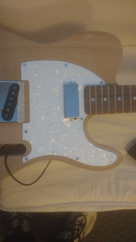

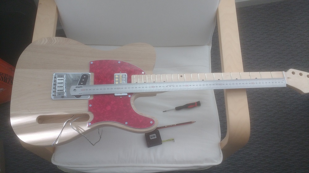

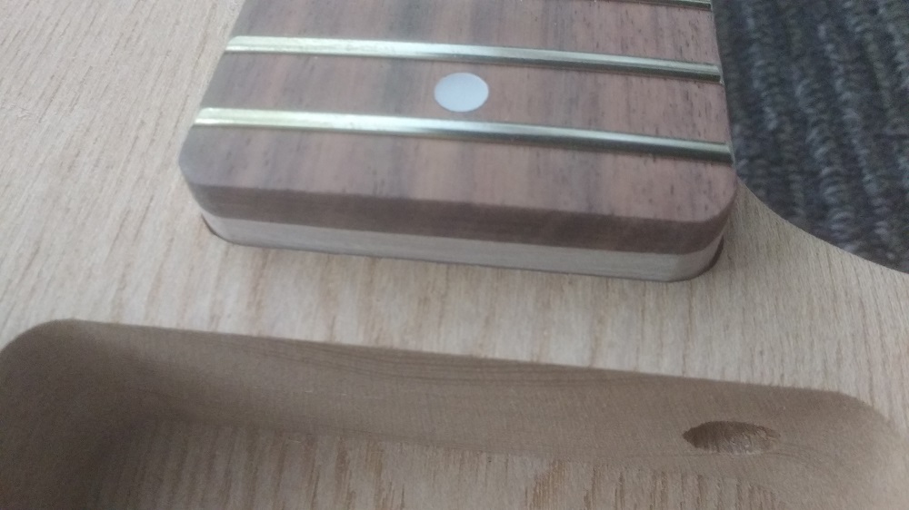

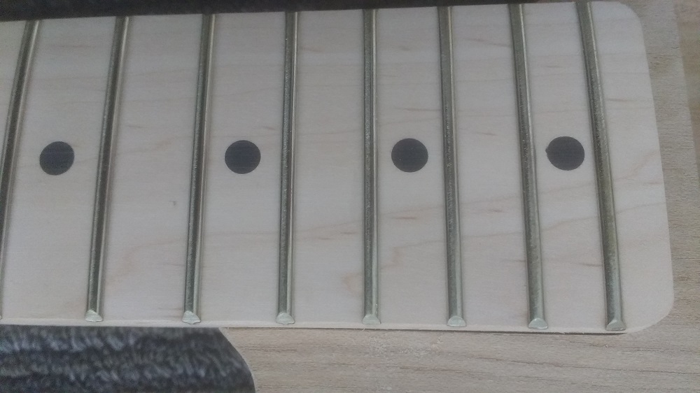

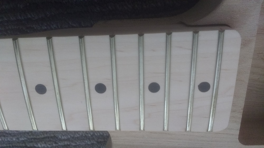

    So, a little more work completed this weekend. I've modified the pickguards to suit the larger neck pickups being used in both guitars, and opened out the openings around the neck pocket where the profile wasn't quite right. Pilot holes for the pickguards fixing holes have been drilled, as have strap pin pilot holes. Bridge alignment has been checked and, thankfully, no further adjustment needed for bridge pickup placement. Bridge fixing screw hole positions have been marked out... but then, snookered. My drill press is not large enough to allow me to drill these and the string thru holes. If there's anyone out there in inner Melbourne with a suitable drill that you're willing to give me access to for an hour or so, please let me know .
    Latest progress shots:
    Neck pocket 1:
    Neck pocket 2:
    [More in next post]

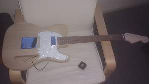

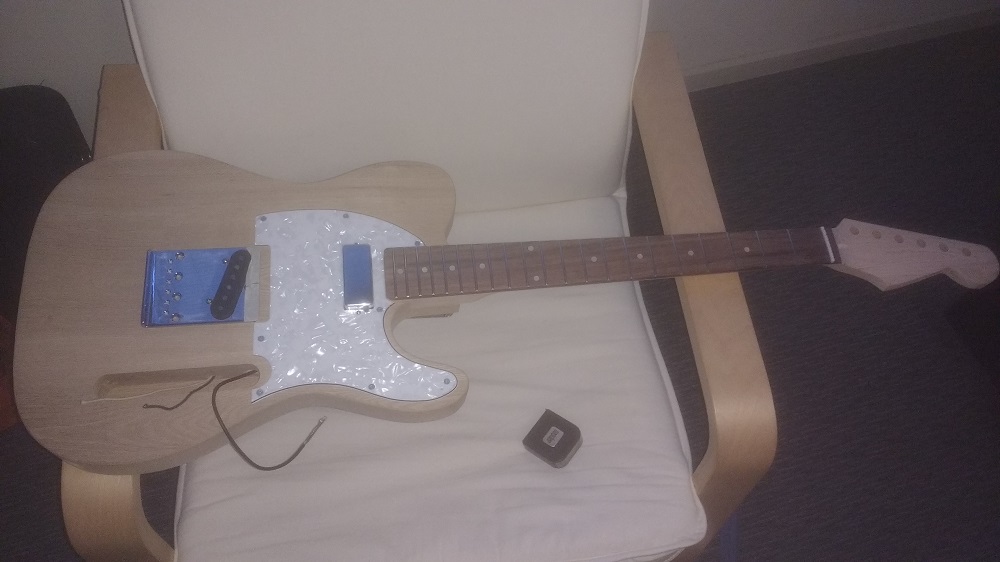

    Loose assembly 1:
    Loose assembly 2:
    Bu**er:

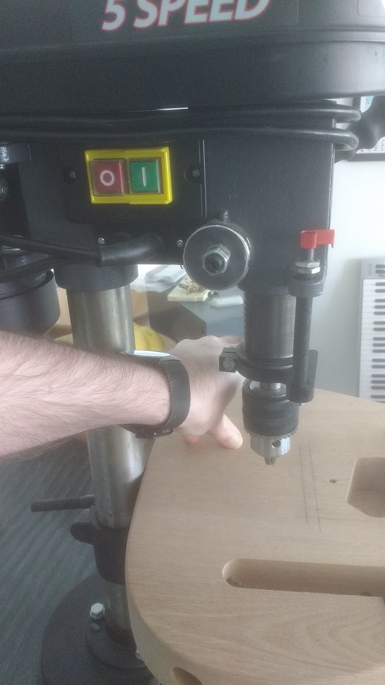

    Damn HG...just out of reach. If you don't find anyone to help, check out my TLA-1R build diary to see my home remedy for drilling my string through. lots of practice makes it less scary.
