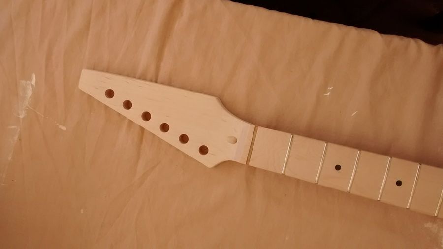

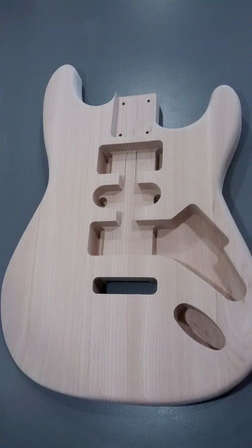

    I was impressed when I opened up the box and found everything in there, right down to a set of string and a pick!
    The body, sanded and ready to go. It arrived in great shape, as did the neck, and everything seemed to fit together as it should.

    Originally I had a bunch of fancy ideas for the headstock but a lack of tools/proper workshop and a fear of destroying it before I had begun put an end to that. maybe next time.

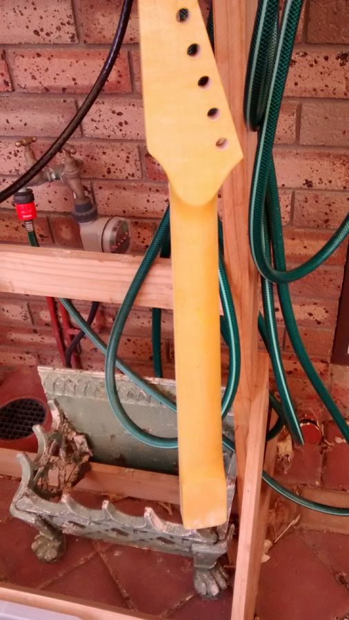

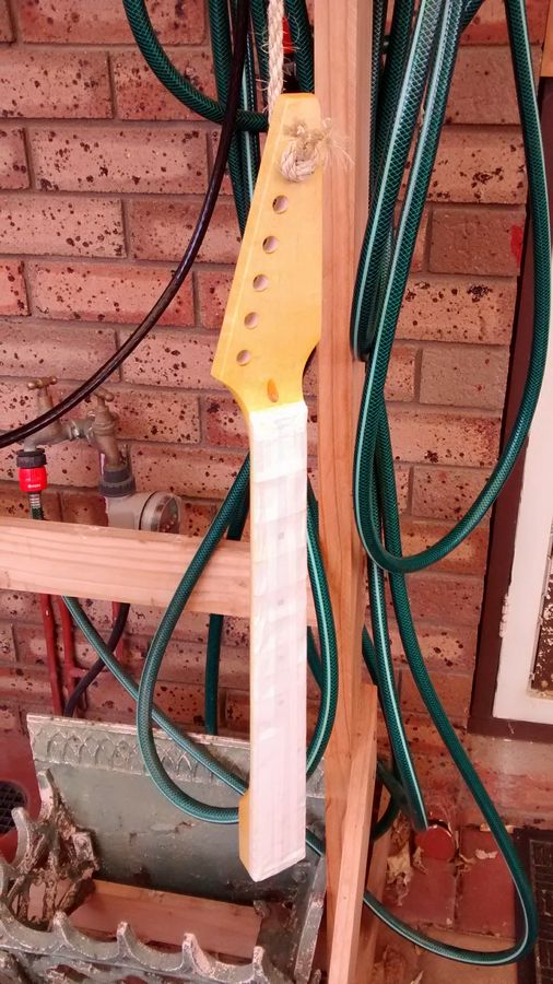

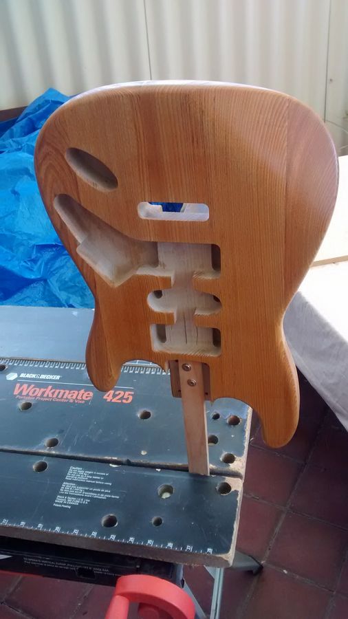

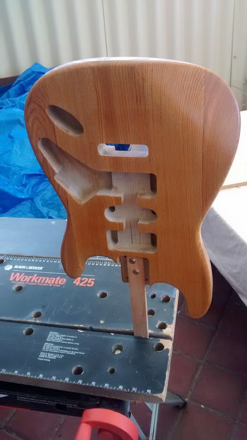

    I wanted a golden colour for the body to show off the grain and went with the Coolangatta Gold. This turned out to be less yellow than i was expecting on the ash body. on the neck though the pale maple made it much more yellow. At first the contrast freaked me out a bit but with more coats and the intensifying coats the colour turned out really nice. The neck did need a lot more staining than the body, I guess because of the much tighter grain. You can't really see in the photos (everything is horribly skewed to orange!) here but the neck ended up with a nice 3D depth to it.

    Masking off the fretboard worked well and the tape came off easily after the month of so it was on there. I did the finishing coats next, with a light sanding between each coat. after that and after 3 weeks i gave it all a wet sand with 1200 grit paper and that made a massive difference to the overall smoothness.

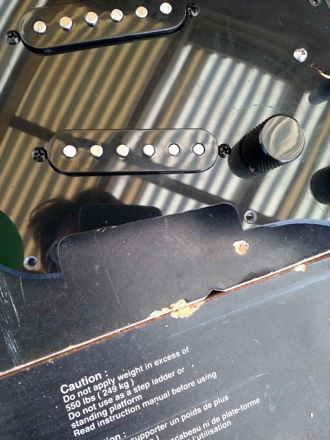

    Sadly this is where one thing didn't work out so well. I wanted to buff it out to a nice shiny finish but after trying for a while to find a what to use I was out of time.
    If anyone has any advice on how to polish it up then I'm all ears as I'd like to go back and finish it off some day!

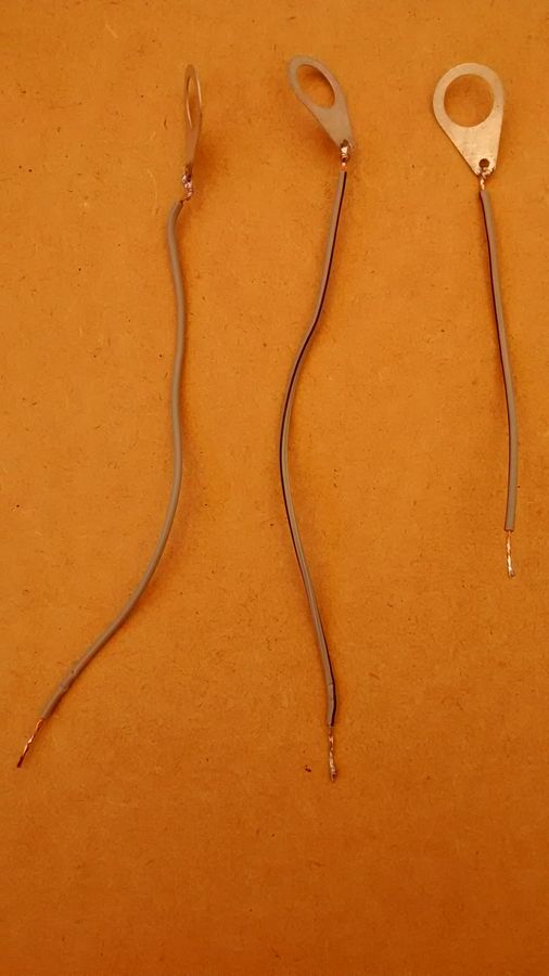

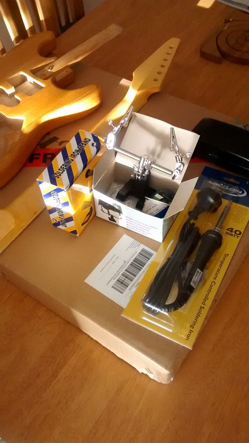

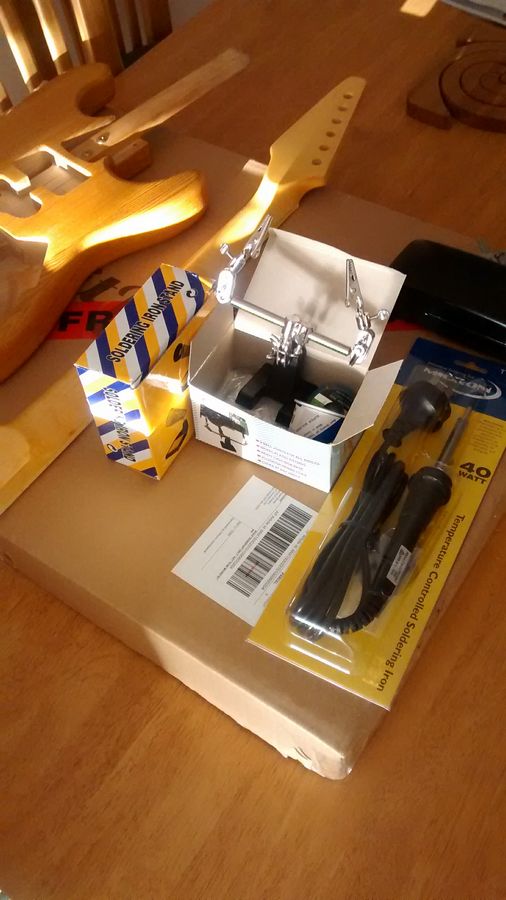

    Once I looked at the stock pots and switch I decided to upgrade all that as well because, well, why not. So i got an upgrade set and some of these little rings which you slip over the pot when fixing to the pick guard and it gives you something to solder to that isn't the back of the pot. i had heard a lot of tales of buggering up your pot by over heating it trying to fix the ground wire so I thought I'd remove the issue.
    As I'd never done any soldering before this thing was a life saver - the extra hands! Made fixing everything a breeze and would recommend it everyone!

    The earthing fixings - one for each pot - ready to go.

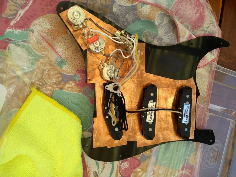

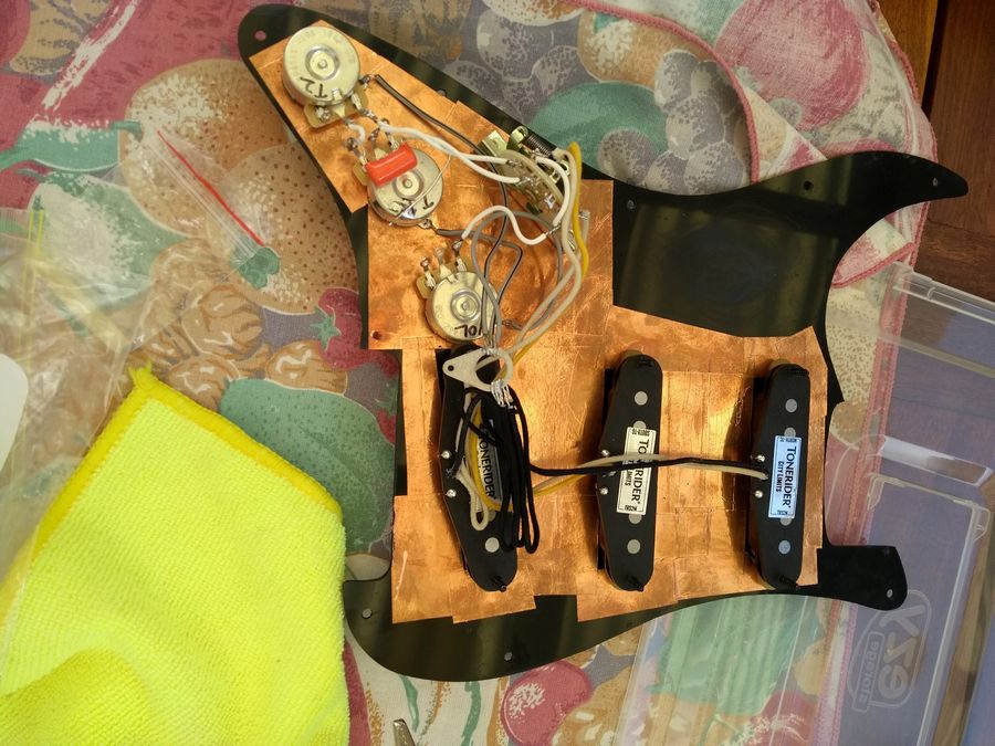

    One thing I found is with the replacement pick guard the holes for the pots were slightly too small for the replacement pots, so I had to drill them out slightly larger. also the holes for the pick guard screws weren't counter sunk enough so I had to re-drill them as well. A small point but unexpected.
    I kept all the screws from the stock kit to re use as I wanted it all black.
    Also worth a note is the stock pickup covers don't fit the toneriders - the pole spacing is different, so you can't reuse them.

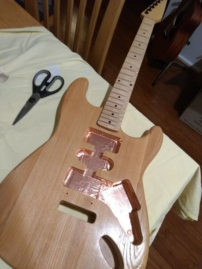

    I used the copper tape to shield the pick guard, screwed everything in, carefully soldered everything (pre bend the ends of your wires into little hooks before you tin them, then using the 'extra-hands' you can lock them onto whatever it is you are fixing them too and have free hands for the solder and iron).
    In this photo you can see all the earth wires fixed to another one of those little rings. I then ran one wire from this to the jack to ground everything. Don't forget the earth wire from the trem claw!

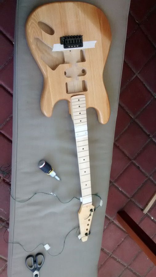

    I stressed for a long time about how to correctly locate the neck and bridge. Finally after posting on here my confidence was boosted enough to just get on with it.
    I think now if i was to do it again i'd just fix the neck into the pocket and only really worry about the exact bridge placement. The neck needs a nice snug fit so that tends to dictate where it will sit. I think I over thought it far too much!
    Other than stressing about this there were no real problems. once the neck was on i fixed the high and low E tuners and used the string method to locate the bridge and fixed it down.

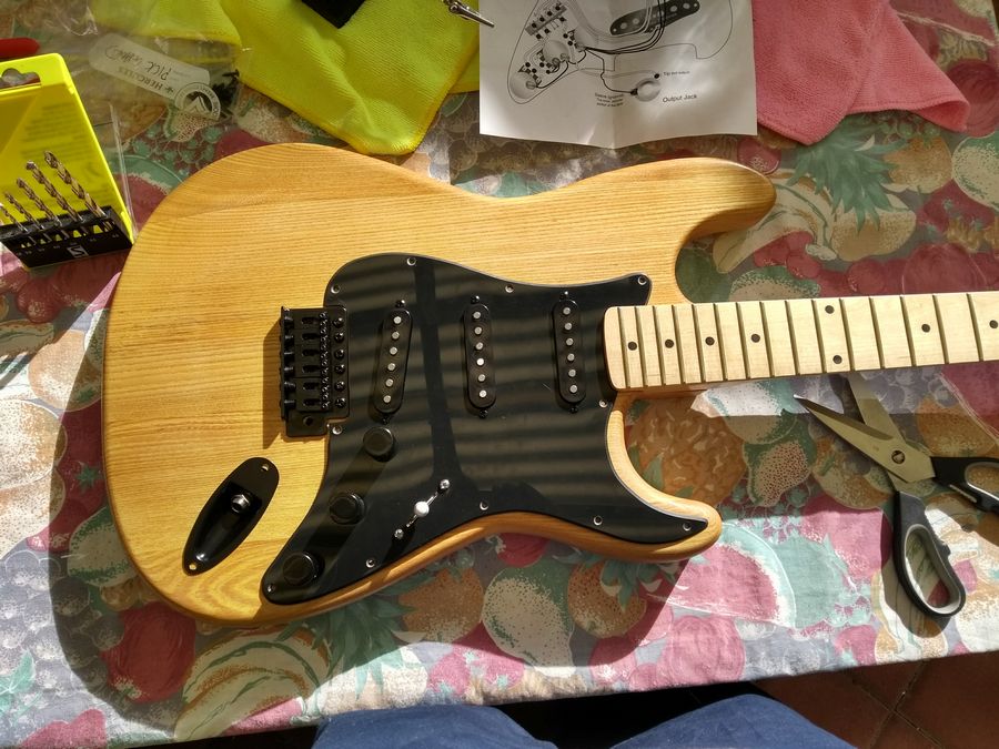

    Naturally not everything went smoothly. Even after checking the spacing when I came to fit the pick guard the bridge was oh so slightly too close to the neck and it wouldn't fit. I sanded down the bridge cutout with a dremel enough for the trem to work and not risk catching on anything.

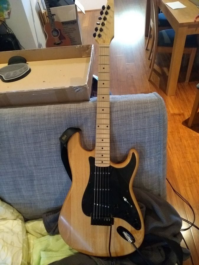

    I used a ruler to align the tuners before fixing them and even though the holes look in line the tuners are slightly off.

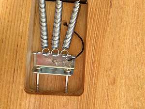

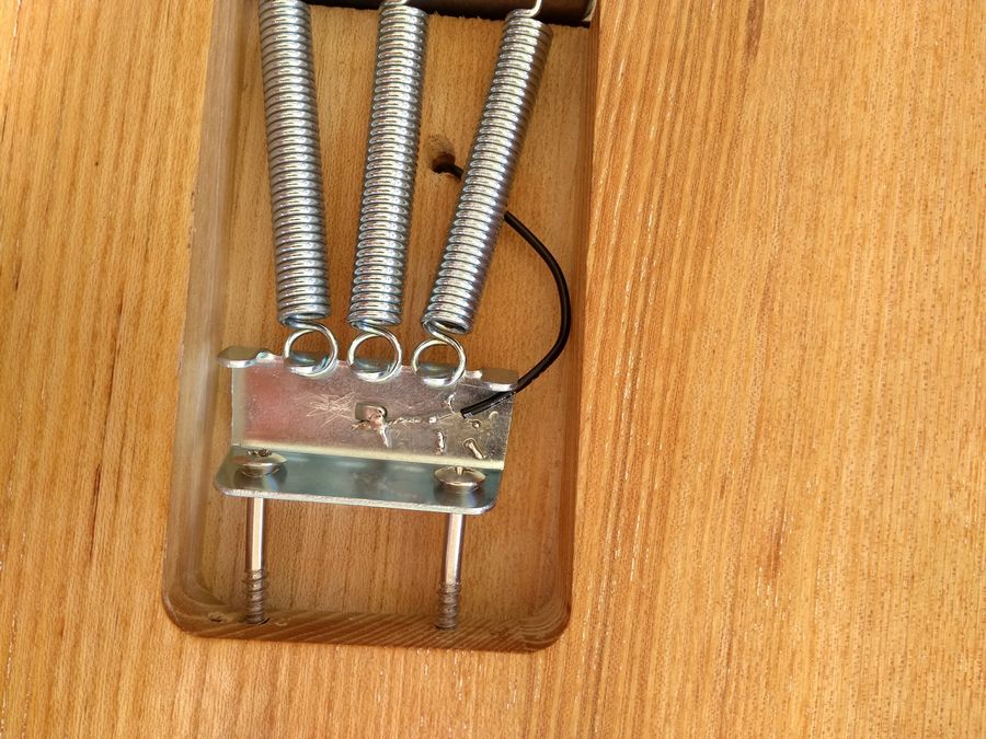

    Then on went the strings, messed around alot with the trem claw tention to get this set right (so i ever so slightly pull up) and thats about it!

    I may try and take a few better photos of it!
    At the moment my problem is the thing will not stay in tune in any shape or form. you only have to look at it and it goes off. I give the trem a light press and everything goes sharp. I think it might be the nut, although i got a bone replacement and have given it a drop of lube. Any ideas?!

    The tuning thing could be because standard strat bridges don't really like up bends... All of my strat type bridges are set to dive only and never have less than 4 springs; mind you I use the vibrato sparingly and only go nuts on locking bridges!!

    Oh I like that, I like that a LOT. Clean. Simple. Elegant. Wonderful job there NoONe, i hope you can sort your tuning issues out. It may be something as simple as retensioning the claw or something silly like that. It will take a while for it to settle in as well.

    Not sure if this helps, but for proper trem setup with 3 springs, they should be parallel , not cranked in at the claw. Claw is typically located about 25mm out from the edge of the rout
