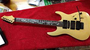

    I have finished the build on a IB-1 and found that I cannot tune it.
    The intonation has been set but when the first fret is held down eg b string first fret is nearly c#. E and E are nearly f#,
    I have removed the shim under the nut thinking the nut was to high, this helped a bit. I've also adjusted the truss rod so that the strings are just not buzzing.
    I have placed a block of wood on the floyd rose so it cannot move, after I get it tuned then I will work on tuning with the floyd rose released.
    Does anyone have an idea how I proceed? Has anyone else built one that can be tuned?
    Is it possible the nut should be moved away?
    Is it possible the nut is in the wrong location? Other ideas, maybe shim the neck joint to flatten the neck to the body

    2,799
    I'd be checking the neck interval measurements, sounds like they could be way out. ( which would be odd )
    Or maybe not, my first thought was nut height but maybe this is ok'ish based on your first post.
    Thanks, I will be buying a metal ruler tomorrow to measure, found a good web site which has the measurements. For my 646 mm scale neck
    I have noticed that the neck is bent up towards the nut so I thought of putting the shim back under the nut and removing the bow with the truss rod.
    All fixed, I have been to heavy handed, the pressure of my fingers can dramatically affect the tuning.
    Neck relief has been set better and with a light touch, all frets are perfect.
    Now to start playing lightly 😀 And in tune.
    Glad you got it sorted. Now you've added pictures, it was plain that the neck had far too much relief. But it was an easy fix and you did it yourself. You should be able to get the neck relief nearly flat, with only a slight concave bow in it. The lower the action is, the less force you need to press down on the strings and so the more in tune the notes will be.
