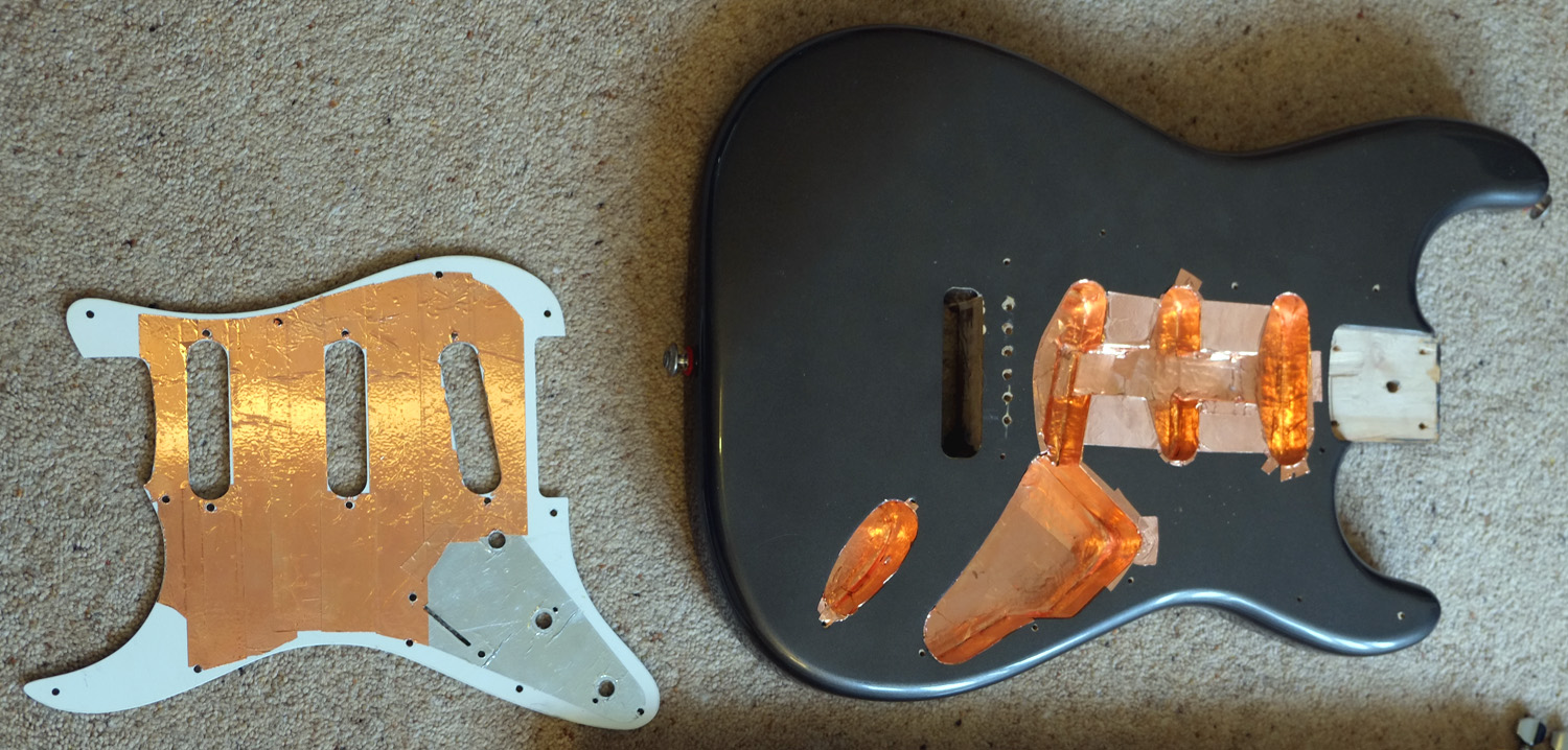

    You can get reels of copper shielding tape quite cheaply from eBay. Make sure that it says 'conductive adhesive', otherwise you'll need to solder the strips together. The conductive adhesive is very good and you should measure resistances across the tape in the order if 1 ohm or less. Some people prefer aluminium tape or foil for shielding purposes. Line the pickup and control cavities with it (make sure none of the signal wires are touching the tape or you'll get no sound) and the underside of the pickguard.
    The tape/foil on the underside of the pickguard gets its connection to ground through contact with the grounded control pots. If you let some of the body cavity shielding tape come up over the top of the body underneath the pickguard, then it will make contact with the tape on the underside of the pickguard, and so get a path to ground. The shielding should run to the very top edge of the control cavities, and I prefer to overlap the edge by roughly 1mm all round, except where I'm deliberately running more tape over the top of the guitar for a large contact area with the pickguard (I run it over the wooden 'fingers' between the pickup routs).

    Here's a photo of some shielding in a Strat copy I did for a friend. Note that the shielding needs to overlap a bit to get electrical continuity, not in side-by-side strips. It's worth checking the continuity with a multimeter. I ended up running a couple of strips crossways across the side-to-side strips I did on the underside of the pickguard as I was getting a lot of variable high-resistance readings without them.
