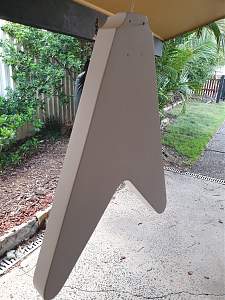

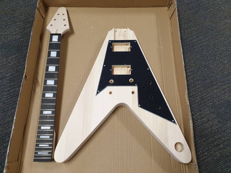

    Just turned up today. I'm building this as a surprise gift for a friend and he has no idea. He's a bit of an Arsenal fan (yet we're still friends somehow) so this will be painted red with a bit of white and with a Gunners logo or two - just have to work out where they're going.

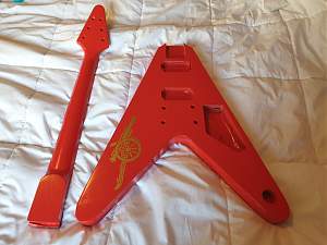

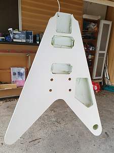

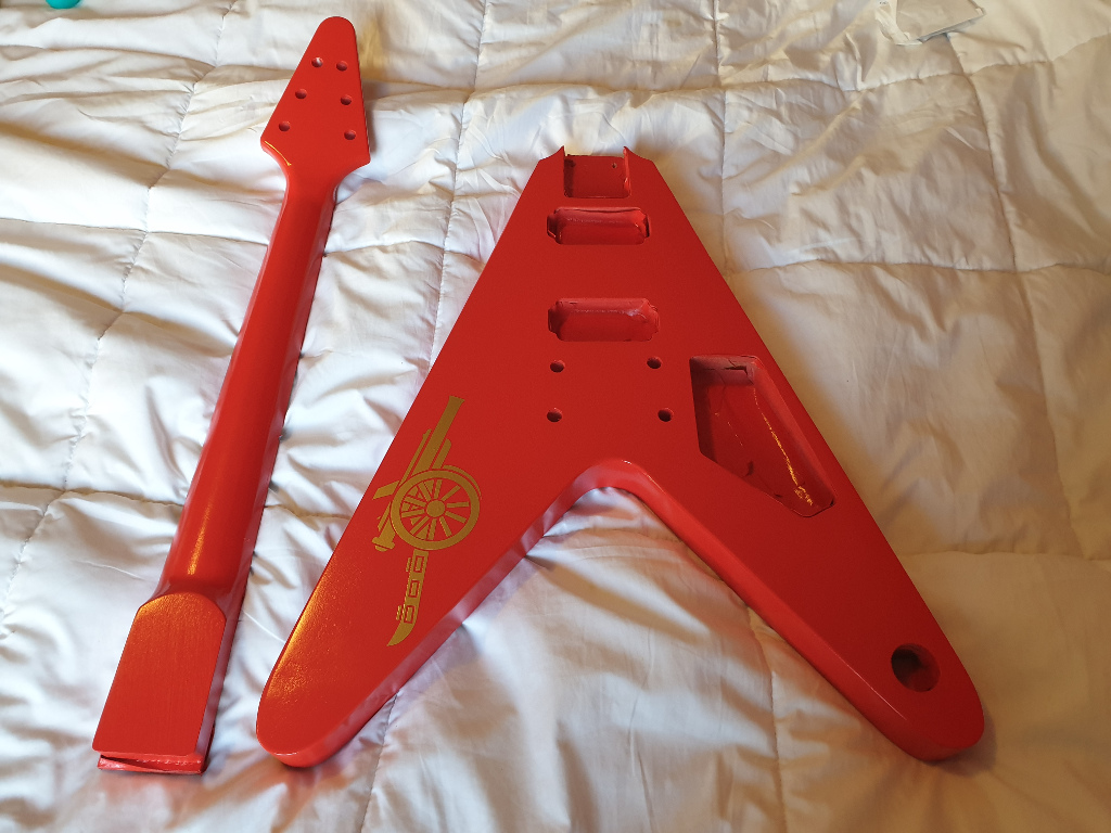

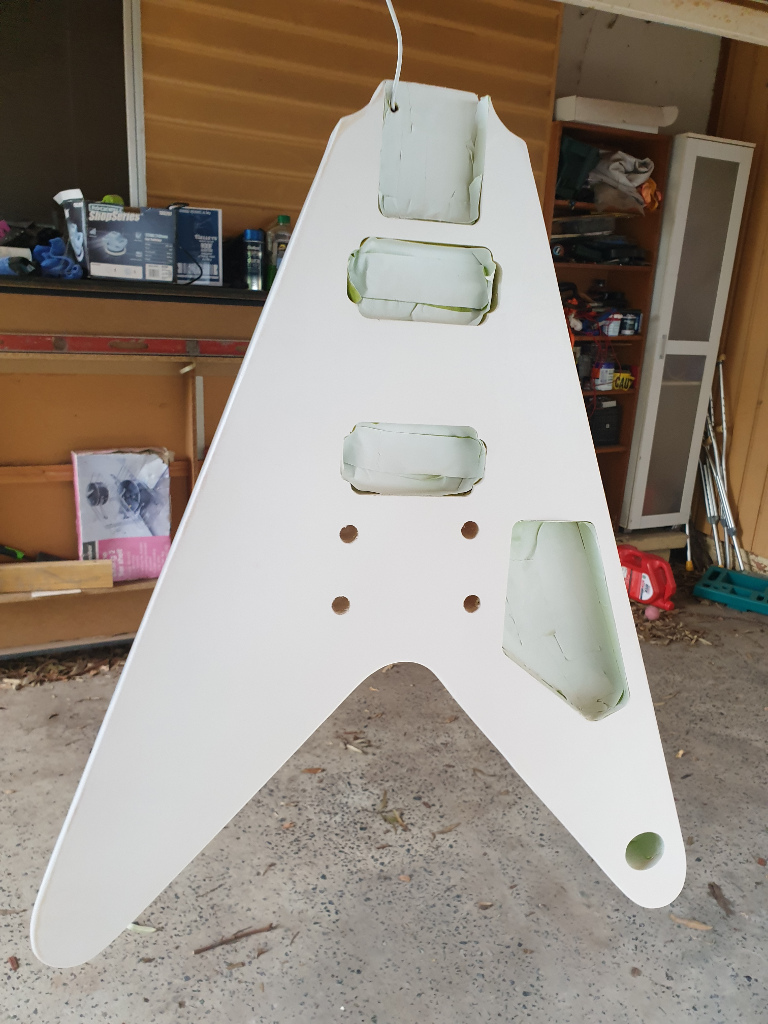

    Been a bit slow with this. The weather hasn't been conducive to spray painting outdoors from a can.
    Did the grain fill and undercoats a few weeks back and then got around to laying down some colour and a decal on the weekend.
    The face of the headstock will be white and thinking of spraying the pickguard white also, but not sure how that will turn out, though.

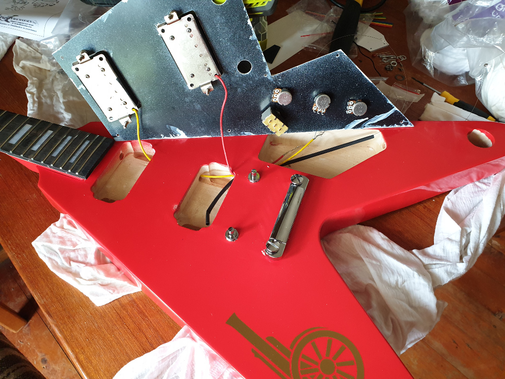

    Finished the wet sand and polish. Only done by hand so not the best job but still looks decent. Now for my next hurdle that I didn't foresee.
    Never done one like this before with all the pickups and knobs mounted on the pickguard but still needing to route the wiring through drill holes in the body. Makes for a very awkward soldering job because I need to balance the pickguard near the body while doing all the soldering so I don't have a crapload of cable to bundle back into the cavities. As much as I hate the idea, might be worth doing this with plug-in connectors so I can solder it all and route cables through, then just connect the plugs just before I mount the pick-guard.
