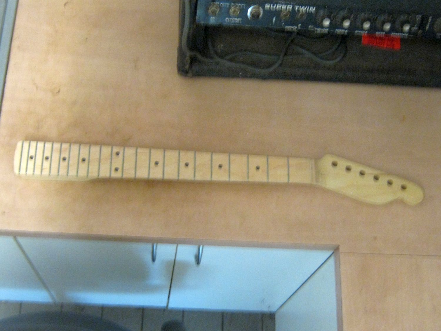

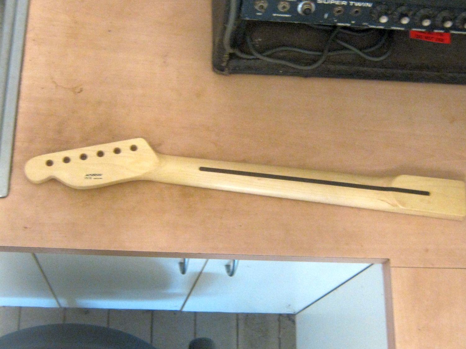

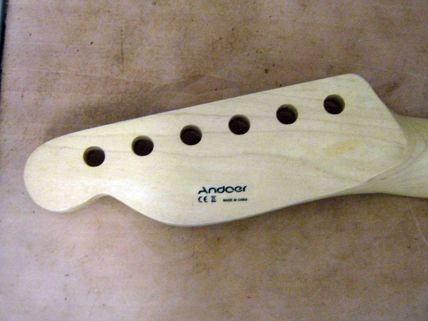

    Hi everyone, thought I would start a thread about an all maple Andoer Telecaster neck that a local Darwin Luthier gave me for nothing, all I need now is a body for it so that I can build myself a custom Telecaster.
    I've actually been debating in my head what I was going to do with the neck for some time now, and seeing that a lot of you are building some pretty cool looking Telecasters, I couldn't help but get inspired, anyway, I'll post a pic of the neck shortly so you can see what it looks like....stay tuned.
    Here we go, here's three pics of the neck:

    What's a bit unusual about the neck is that it was made with a 16 Inch fretboard radius so it's a lot flatter than the standard Fender 7.25 Inch radius that Telecaster necks used to be made with (the real early ones anyway), and yes I agree, the headstock is a bit mis-shapened too, might consider re-shaping it so that it's more "correct", or maybe I should just leave it alone.

    I may need to do a fret-leveling job on the neck, so I'll have to buy some fret-leveling tools soon, I noticed that some of the frets are a bit high when I tried straightening the neck because it had a bit of forward bow, I almost got it straightened out by tightening the truss-rod but found that the truss-rod nut was getting a bit too tight to turn, and I got a bit worried that I'd end up breaking the truss-rod and ruining the neck, I do have a spare Maple neck I could use, but I'll need to cut the headstock to the correct Tele shape, not anything to worry about, but at least I do know that I have a useable spare if things go pear-shaped with the Andoer neck.
