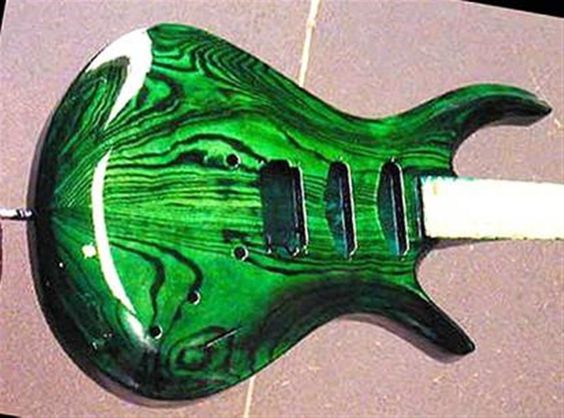

    I am wanting a green translucent finish something showing the grain through. I have sprayed guitars before using nitrocellulose spray cans for a sunburst effect.
    This one I want in high gloss translucent green Click image for larger version.

    Has anyone done a green finish?
    Did you use dyes or paint?

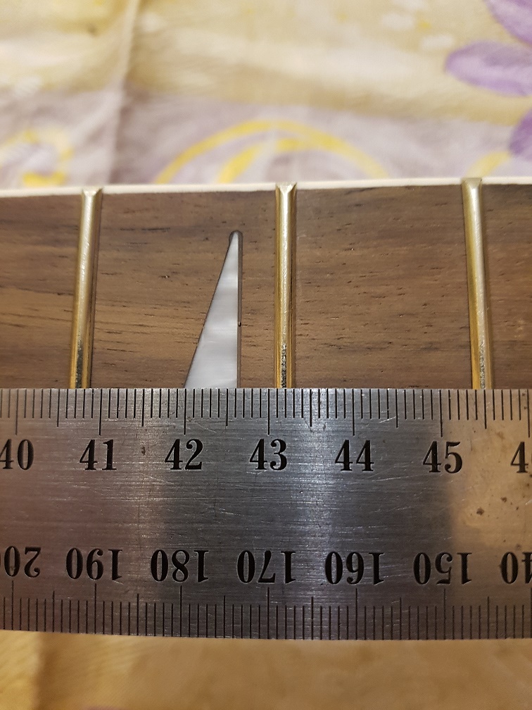

    Well I got home from work late but still thought I better get the kit out and take some photos and do some measuring.
    The scale is a little long
    432mm to 12th fret

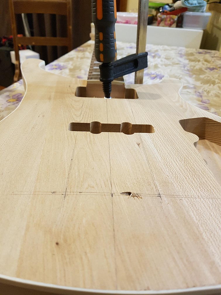

    The neck is actually a super tight fit and sits dead centre to the front pickup rout and when centre line is transfered down guitar body it looks perfect

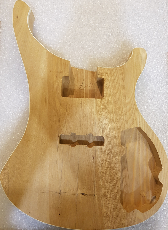

    The only obvious fault is the routing for the rear pup is a fair bit out of line

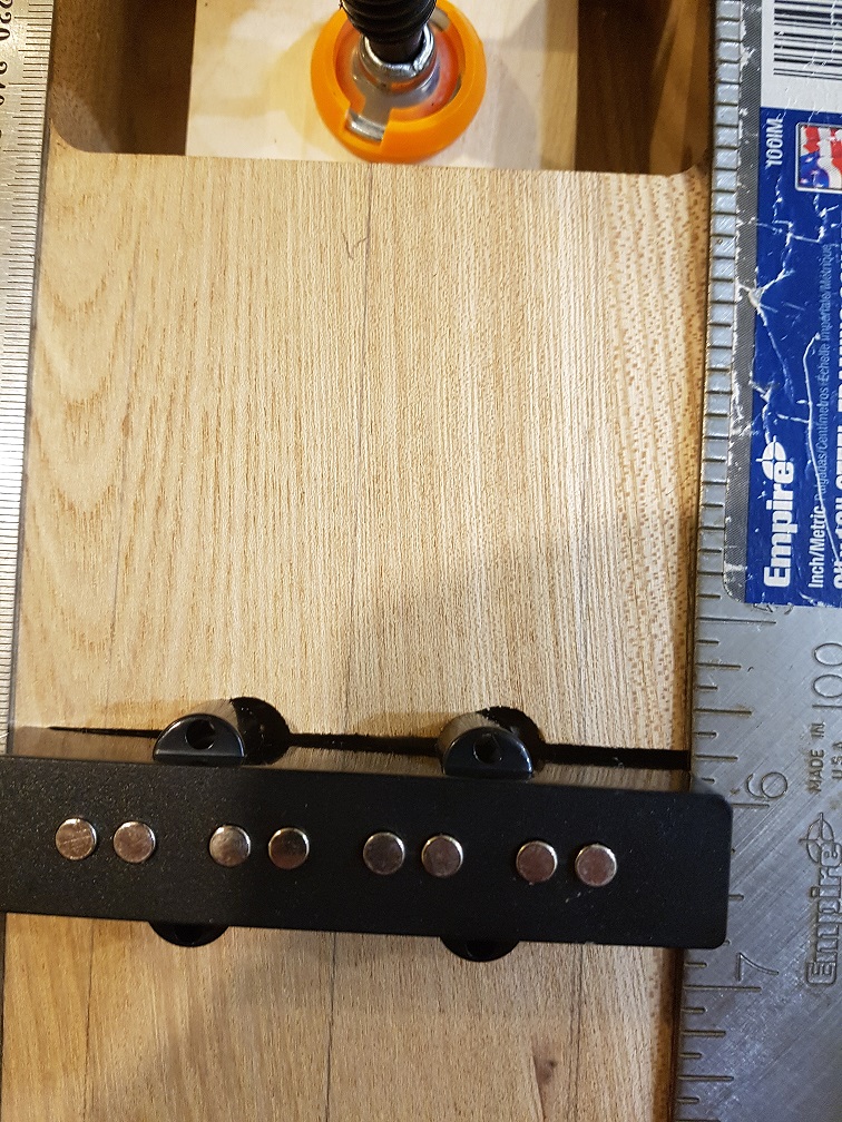

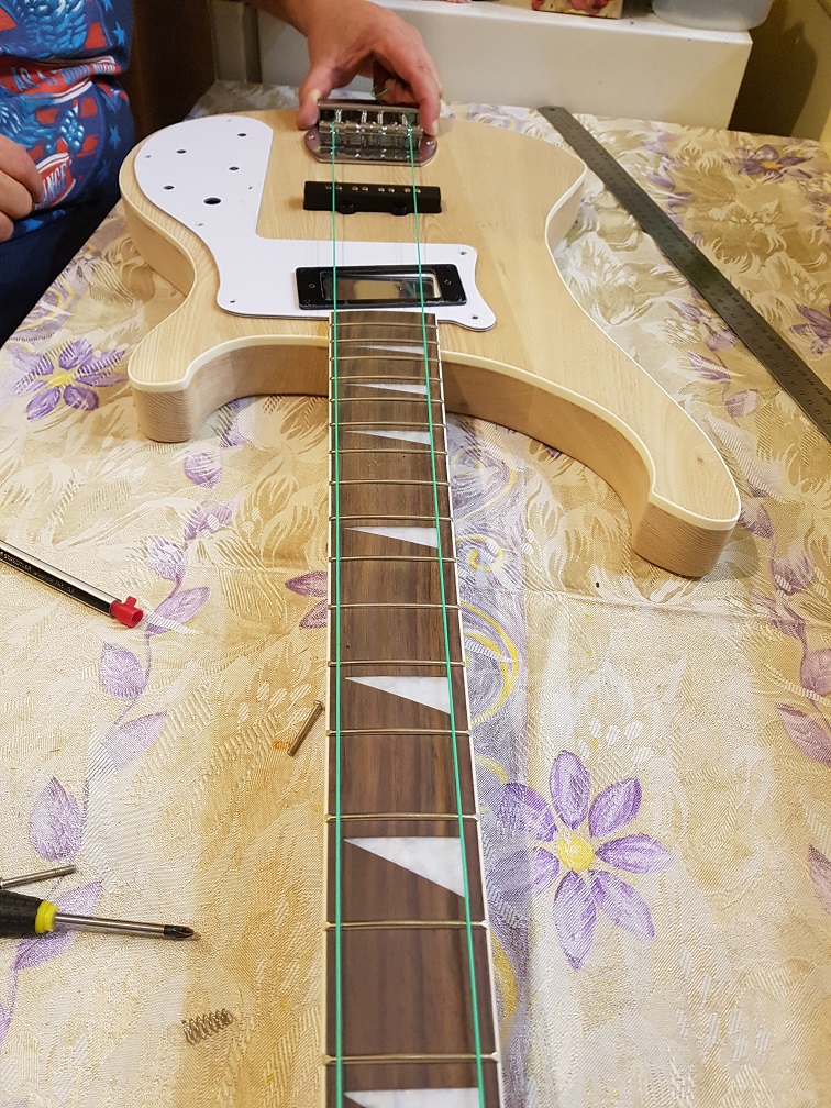

    It's a good 3mm off centre which means the strings are nowhere near in line with pick up magnets., or if you do line the bridge up so strings sit close to magnets the strins would hang off the fret board at the body/neck join

    I have no choice but to lengthen the pup rout by 3mm to align the pick up.
    Has anyone else had to do this with theirs?

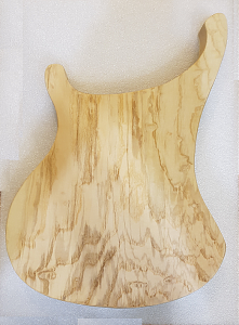

    here are picks of the front and back of the body.
    nice enough grain I'm happy with it.

    The back is thin veneer
