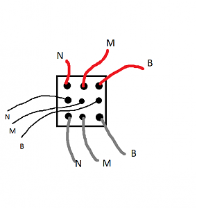

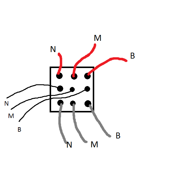

    Just after I posted, I did actually look in to how the switches actually work, and I did think that a 3PDT toggle would do the job. I think that'll be the way to go.
    So coming off of that, I do just want to confirm that I do know how it should be wired in. I looked up the SD diagram ( http://www.seymourduncan.com/wp-cont...mtTP_1V_2T.pdf ) and from there I think I know how it goes, but just want to confirm, using my vast MS paint skills
Name:	wow i am good at ms paint.png
    If I'm following correctly, I could swap those three mini-toggles with a single 3 pole toggle wired like that, yeah?
    Dave: I'm specifically lookin' for Quarter Pounds, so I'll pass on that. But thanks anyway!
    Yep, replacing the three mini-toggles with a single 3PDT is fine, splitting all three at once with the one switch.
