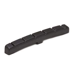

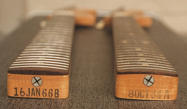

    On a general note, on Fender style necks, if the board is a 'veneer' type (as opposed to the 'slab' type), then the nut is also curved at the bottom, often with a small downward pointing locating tang in the centre. This tang fits in a small hole within the nut slot.
    Take more care with this curved nut type, as if the nut does have a tang, you obviously don't want to hit it too hard and have the tang damage the fretboard, so I'd suggest tapping it lightly from alternate ends until it's loose enough to pull out with pliers, or it simply falls out of its own accord. There's normally enough slack in the locating hole to allow the nut to move slightly sideways, which is all you need to free it form the glue.

    'Slab' on the left, 'Veneer' on the right:
    Curved nut with tang:
