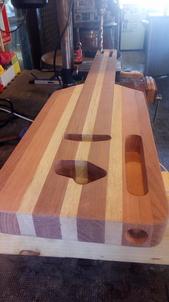

    First step was to glue the neck through part and started to drill out the opening for the tuners.
    Then glued the wings on and cut the rough shape in the bandsaw.
    Then pulled out the tele routing templates that Jarrod cut for me on his CNC. Routed the tele bridge, neck pup and control cavity

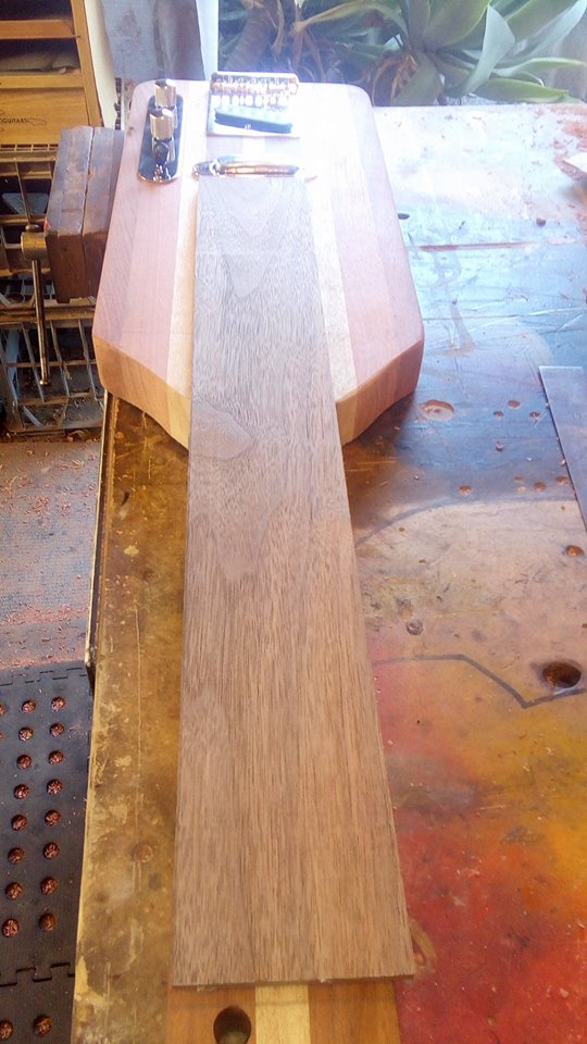

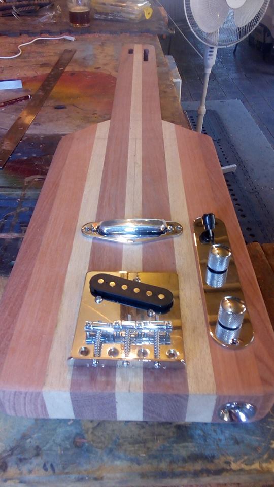

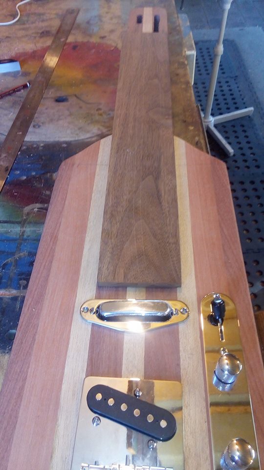

    here's how it looks with the hardware and I got a black walnut fingerboard for the fret markers and dots

    got the tuner slots cleaned up, bit more to go then today working on the fret markers and dots on the fingerboard. As its a lap steel it's all slide so will probably use black cable ties for fret slots and might use some of the 11-12mm pau shell and gold MOP for the dot markers I got some spares for the telemonster project.
    The scale length should be about 27.5 inches. I have no idea how it's going to sound but have a spare set of bartone strings (0.014 - 0.068") so it will be a lower tune, so hoping the low notes are super dirty haha
