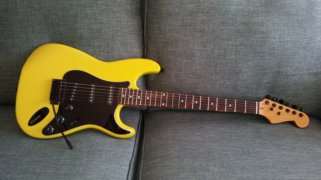

    Here's my Strat finished in SCA acrylic auto paint.
    The pups have been replaced now with Seymour Duncan stacked HBs that I have yet to source black covers for

    That looks beautiful. Do you mind giving me a rundown of your process and what products you used?
    Thanks
    2,799
    Pretty straight forward really.
    Feast Watson maple stain on the back of the neck and headstock
    Sanding sealer on the body but no grain filling which with hindsight I should have done
    3 coats of acrylic undercoat - light sand
    5 coats of acrylic colour - light sand
    5 coats of acrylic clear - light sand and buff with Maguires
    Citrus oil on the fretboard
    All of this followed a lot of sanding before the rattle cans came out, all of the paint coats were very thin.
