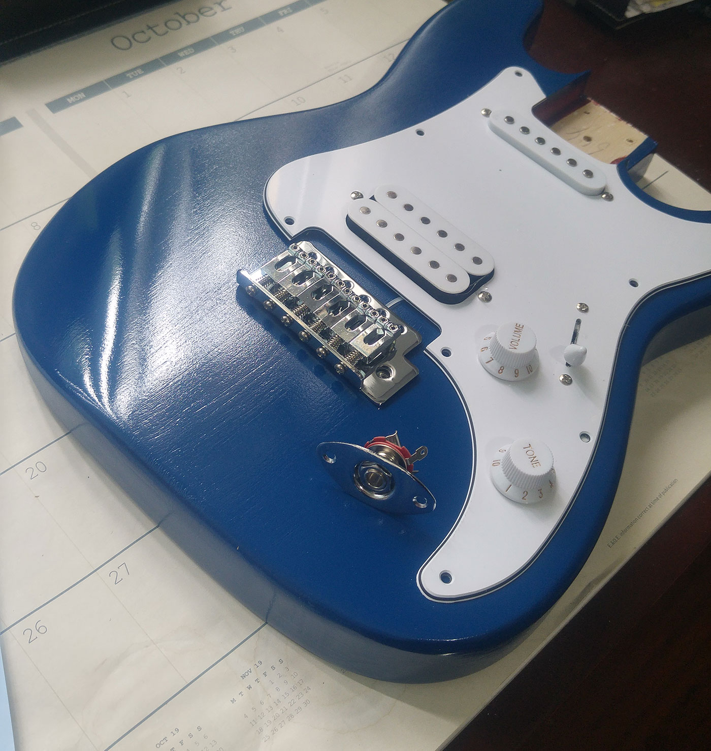

    I thought about mounting it on the pickguard just behind the tone knob but it would be a very tight squeeze. So I think a hole on the side corner, opposite the final pick guard screw may be the best place.
