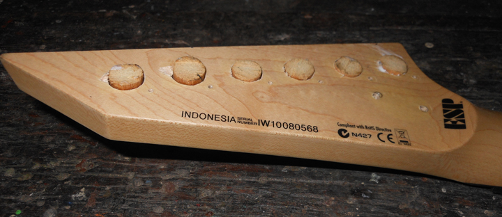

    The headstock is just about rebuilt to mimic the Dobro look too, with thanks to DB's time honoured dowelling method!
    Soo let's have a dekko at progress so far . . .

    Where the 'stock work is at now . . .

    I had to look at this several times before it sunk in!! I thought you would be adding a different neck, not adding wings and reshaping the existing headstock! That's brilliant!!
