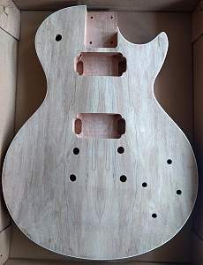

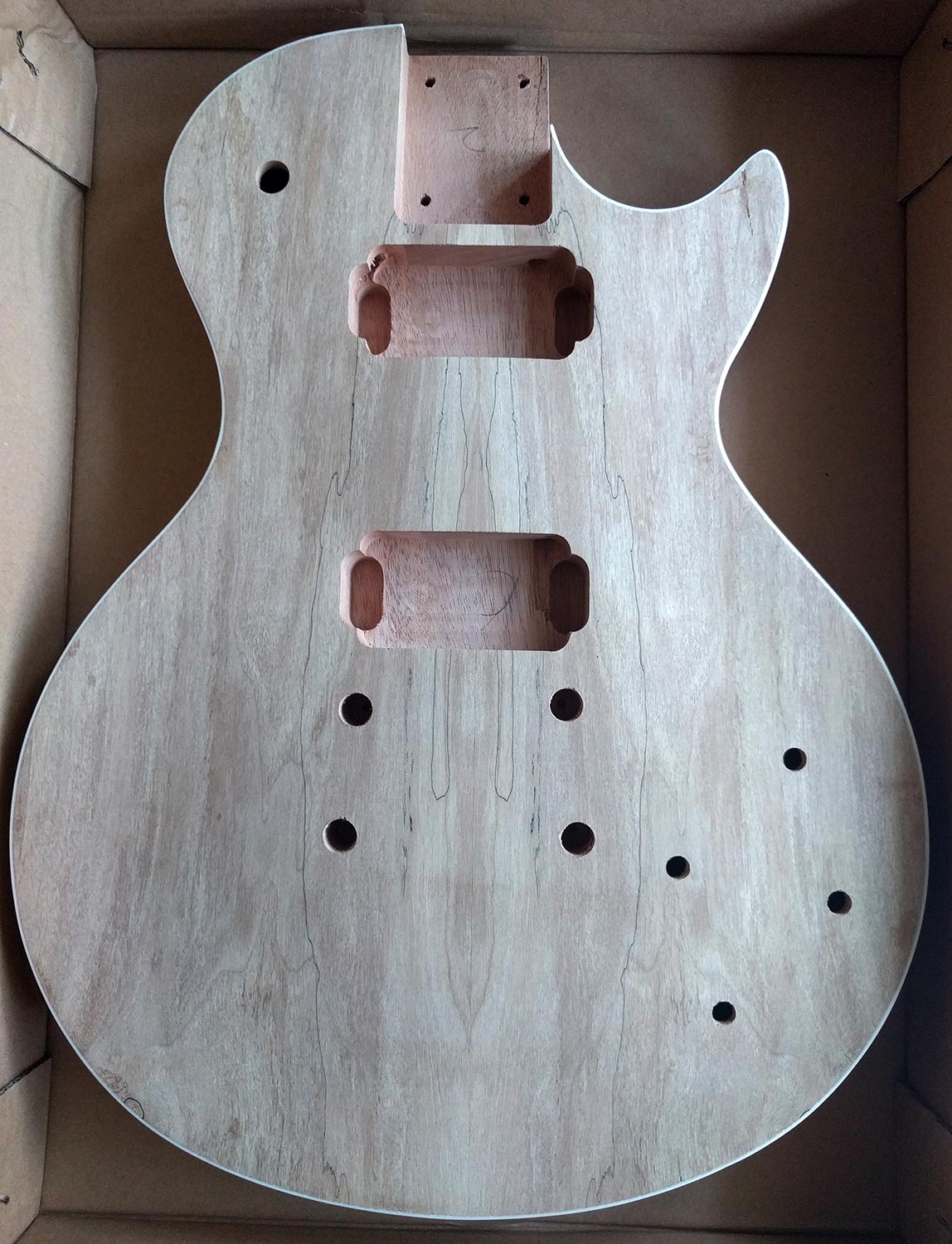

    So my guitar has now arrived so I guess it's time to start one of these.
    I am sadly a bit underwhelmed. Having seen so many spalted veneers, not to mention the one shown in the ad, I can't help but feel a bit short changed by the top of this one.
    What do you think? Am I wrong?
    Don't get me wrong, I do think that it will still make a beautiful guitar, if I do my bit properly, and I do love the feel of the wood (I need to stop stroking it before I get it irredeemably greasy ), but I was hoping for a bit more contrast in the grain.
    All that aside I now need to make a proper plan of action, as having opened the box I suddenly feel a bit overwhelmed with the task ahead. I'm not sure that I'm going to be in a position to do any more of these, so this one needs to be right first time.
    So that'll do for now, my barrage of questions will start below.

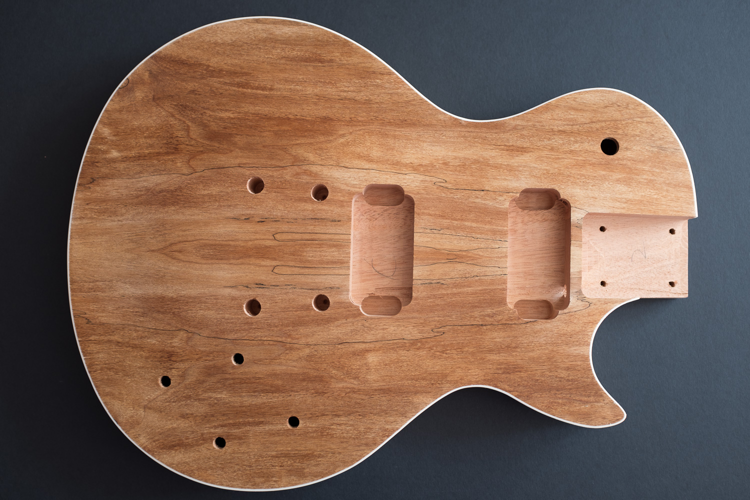

    So here it is with a bit of white spirit rubbed on

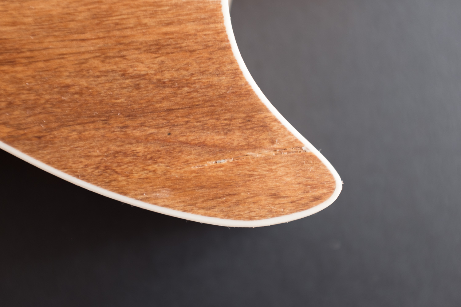

    There are a couple of areas of slight concern, firstly this one
    I am going to use Crimson Guitars Stains and finishing oil, I don't know the pros or cons of trying to fill this, or whether the oil might do the job for me if I do enough coats?

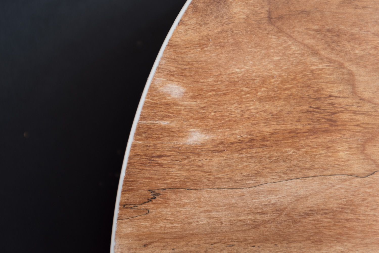

    Then there is this one, is it a bit of glue residue?
    Cheers
    RB
  11. #8
    I'd probably use a small bit of grain filler on that small tear, it would take too much filling with oil and would probably still be visible.
    My guess would be glue residue, though it could also be a patch that's become rather polished so doesn't take up the white spirit as readily. You could try a very light scrape with some medium grit sandpaper and see if that improves it. If not, assume glue.

    Personally I think the spalt looks real nice especially wet as in the pic, looks almost a finish with a clear coat to go on..

    Your right chrissyinbkk, it does look a lot better with the spirit on. I'm definitely happier.
