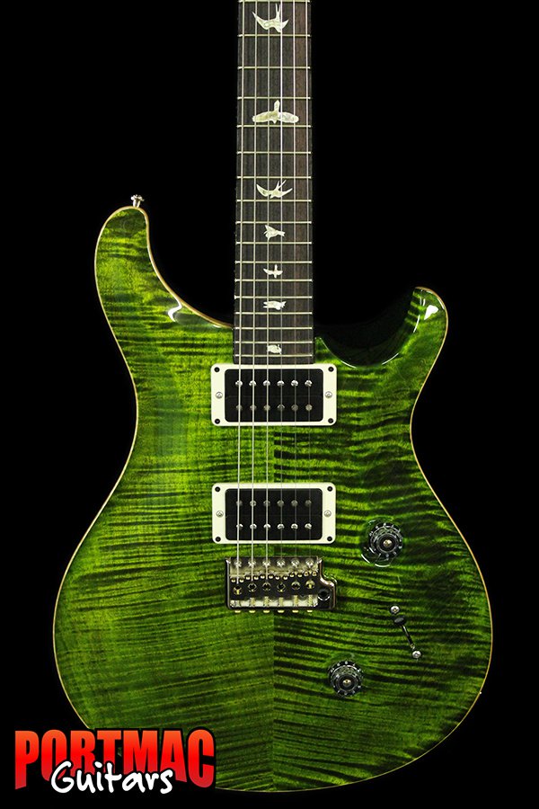

    I wanted something like this initially, but it was not doable with the Tarkine Green.
