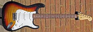

    As another example of what can be done with stuck-on finishes, here's my '90s Fotoflame Jap Strat with a photo of some (very badly book-matched) flame maple hiding under a badly damaged poly finish.
Name:	Jap Strat small.jpg

    Simon - that maple is surprisingly convincing in the photo - does it look the part in person? Odd that it isn't bookmatched.
