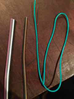

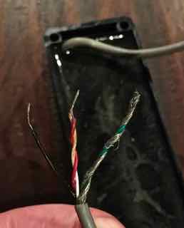

    Hey everyone! My son and I are building our first instrument together, an EX-5 bass. It's my sons but neither one of us has ever traveled this road before so at the encouragement of Adam from Pit Bull, here we are. My main concern is the wiring. I have a diagram but the color coding does not match what we have. I'll do some more reading on the forum to see if I missed a post with the same issue and I'll post a few pictures. Any advice is appreciated. Thank you.

    With the pickup wires looks like they are coil splittable, which means you can run one coil (single coil pickup sound) or both coils (humbucker sound) with a push pull pot, but if you want to wire it up as per the PBG diagram I would tape up the bare end of the red/yellow wires which are joined and the green/bare wire will be earth and the single black wire will be the hot wire. Don't worry if the wire colours are different just follow the diagram.

    If you have a multimeter (not very expensive start from about $15) you can check the resistance of the pickup wires will tell you alot. Ask if you need to know more.

    The pickups for that kit are now 4-wire whereas originally that style were 2-wire. As Wokks said, from your photo, the black is your hot (+), green and bare is your ground/shield (-) and the joined red & white is the series link. The series link allows you to coil split the pickup if you want (with a switch or push/pull pot), but if not just tape/insulate the bare ends so it can't short with anything.
