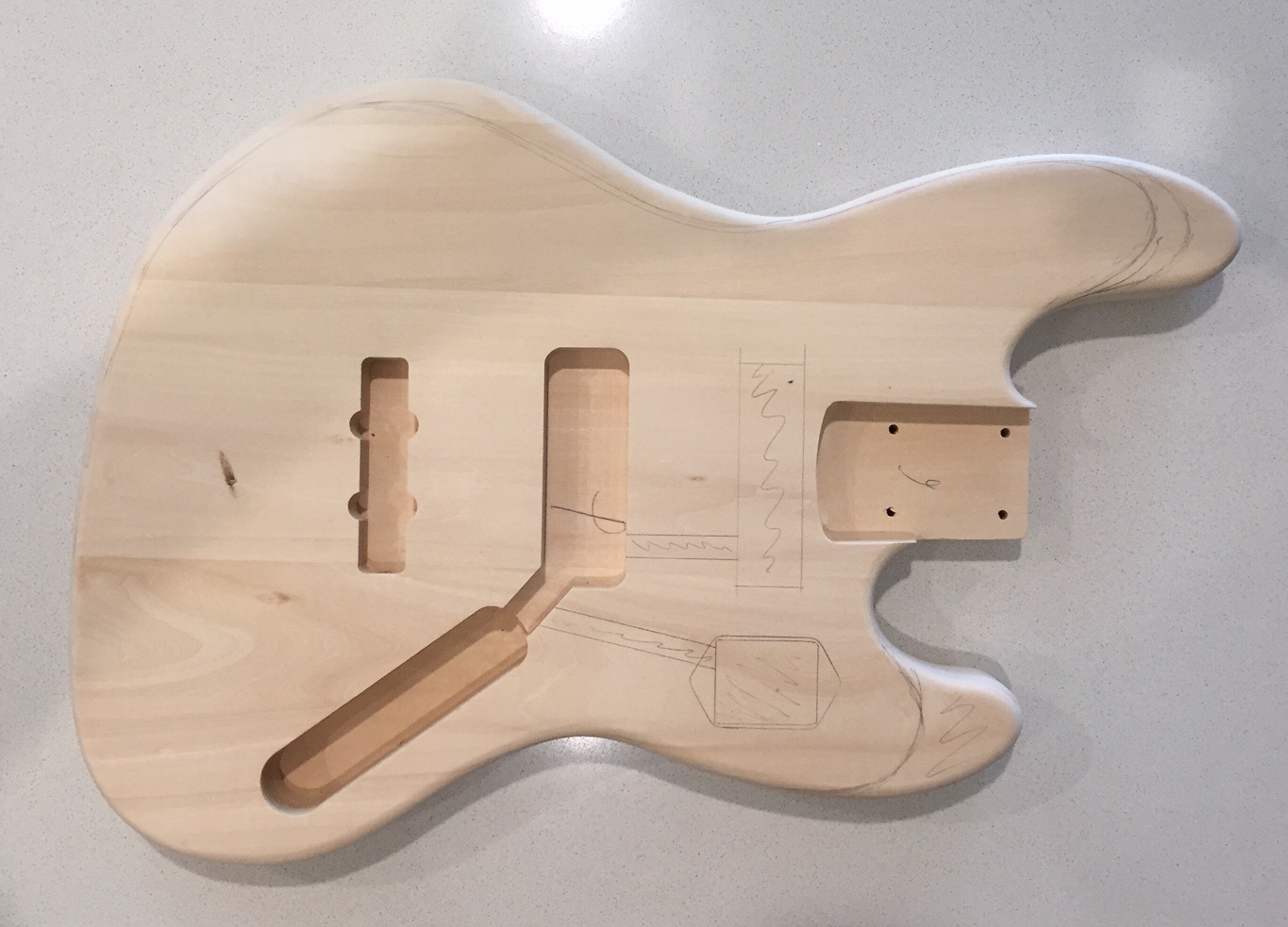

    A bit of progress over the weekend… I marked up the body with the reshaping and routing I need to do…
Name:	Markup completed 101016.jpeg

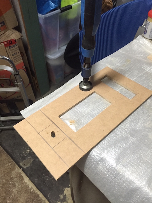

    ... and then made a routing template for the switch cavity and the third pickup…

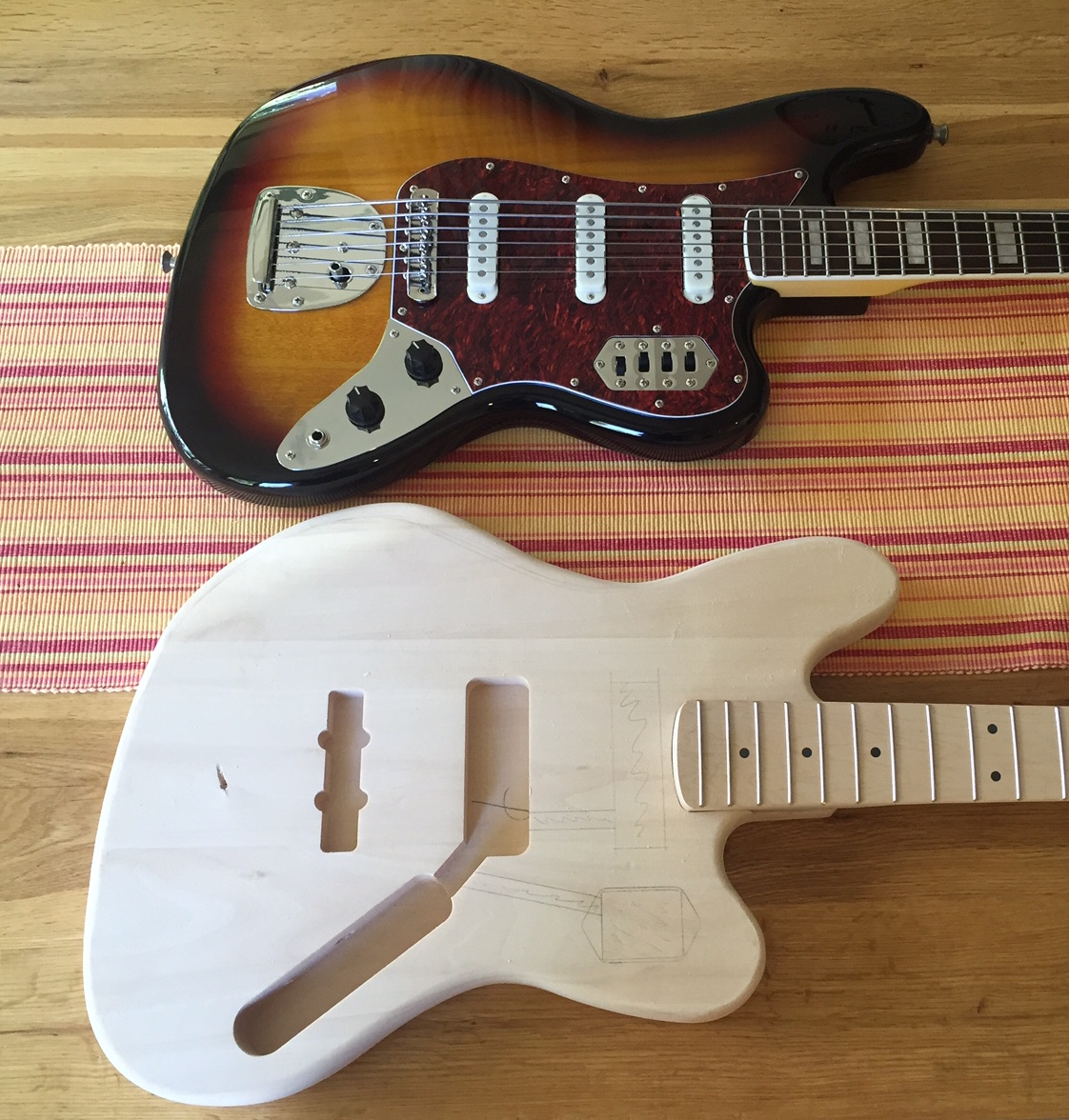

    Next I attacked the horns to get a more “Bass VI” feel...

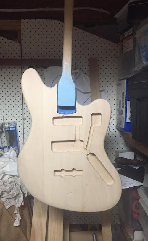

    And finally broke out the router, and while it’s not the neatest job, it will do (all the messy bits will get covered by the pickguard anyway).

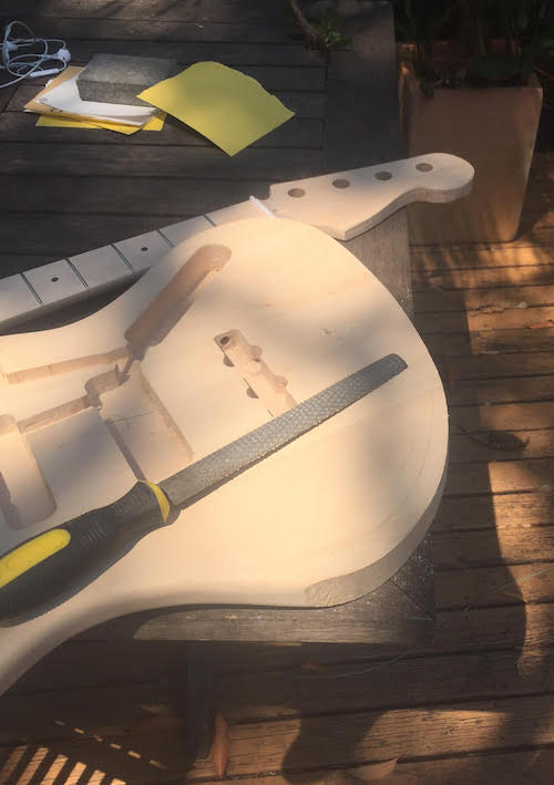

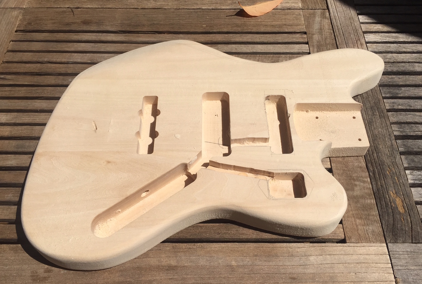

    A very pleasant day of building so far! I ended up taking the jigsaw/rasp/sandpaper to the body a bit more (taking a bit of the upper rear bout and changing the angle of the rear end a bit!), as well as fixing up the cavities. I also shaped the headstock – a freehand version of a Fender one as I like the shape but don’t want to have an “exact” replica.

    I then went through the same sanding process I went through last time on the body. I realise most start with 240, but I quite like starting with 60! I realise that the body reshaping I do means more of a heavy-handed sanding approach, but I do find that it’s nice to be able to change the feel of other areas of the body that I haven’t cut – contours, the profile of edges etc. So I basically go 60, 120, 180, 240, 320, wipe body with damp cloth to raise fibres, 400, do a timbermate slurry, let dry, then a final 400 to get it ready for priming. And that’s where I am now: body mounted on trusty painting stick!
Name:	Ready to prime.jpg

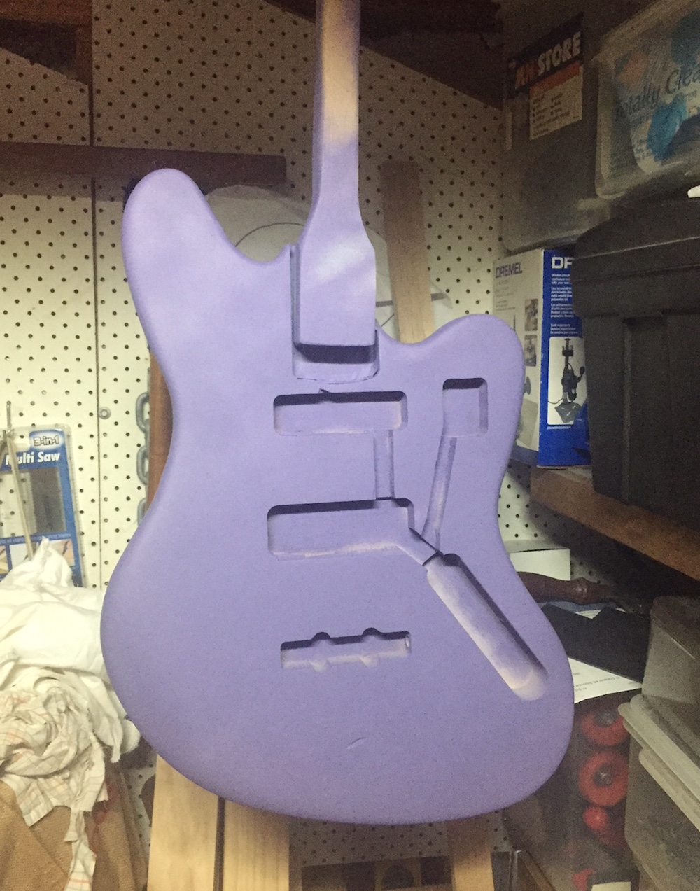

    And as hoped, first colour coats went down. Only a key coat and then one more light one over it so far so very patchy, but I think the colour will work well. For those interested I did a three light coats of White Knight general purpose primer, then MTN94 RV-173 Ultraviolet.
