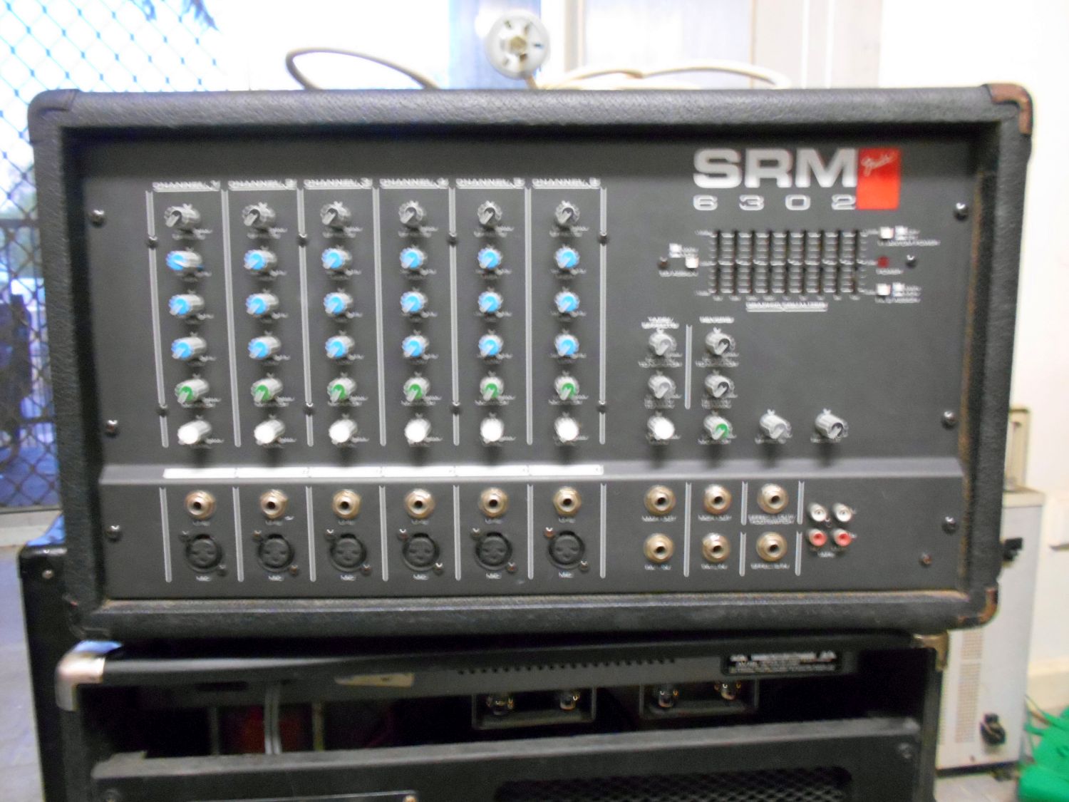

    Here we go, some pics of the Fender PA amp that I worked on for my mate:
    The Fender PA Amplifier:

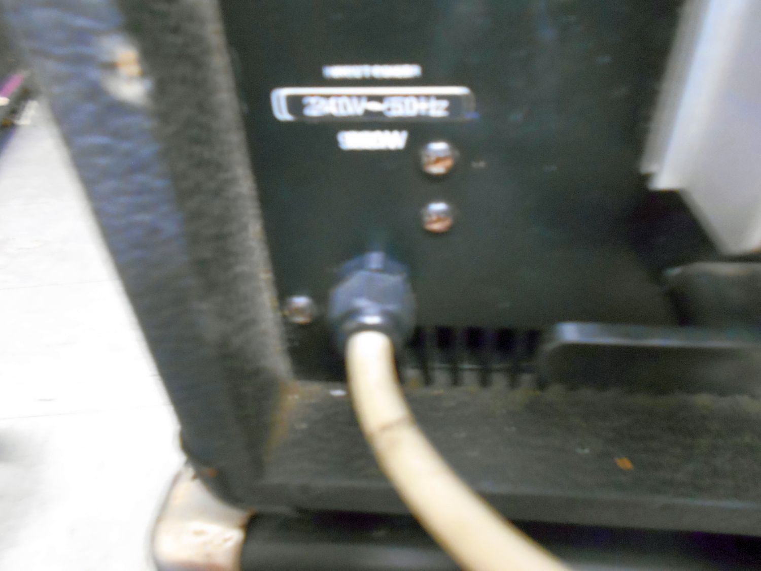

    A Closeup Of The New Cable Gland I Installed:
Name:	Fender PA 4_resized.jpg
    This was done because someone had replaced a broken,or missing, 240 V AC cable-clamp with a zip-tie and a few turns of blue electrical tape, I fitted the new cable gland after removing the zip-tie and sticky electrical tape to prevent chafing of the 240 V AC cable against the metalwork of the panel, at best a short circuit here would blow a fuse, at worst, a short-circuit here could kill someone, it should be all safe now though.

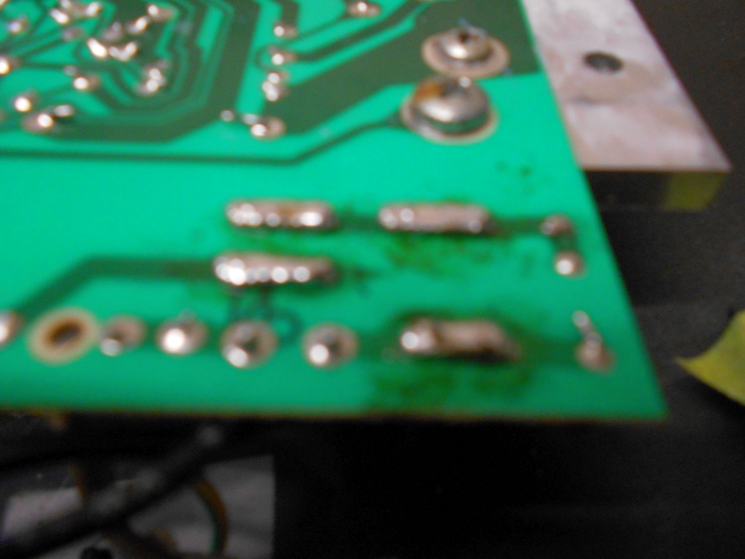

    Solder Joints On The Main Supply Filter Caps:
Name:	Fender PA 6_resized.jpg
    The two on the right are the ones that were cracked, I re-soldered all four of them as a matter of course.
    Solder Joints On The 240V AC spade Connector Terminals:
Name:	Fender PA 7_resized.jpg
    I used some thick stranded wire that I twisted together, tinned, and bent into shape to reinforce each of the solder joints for the spade-connector terminals, this was to stop the solder-joints from cracking again under mechanical stress, one of the spade-connector terminals for the 240V AC input had cracked solder joints, this prevented the PA amp from powering up, it's all good now.
