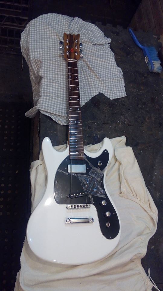

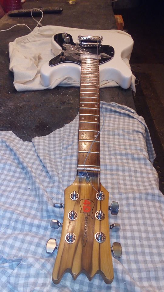

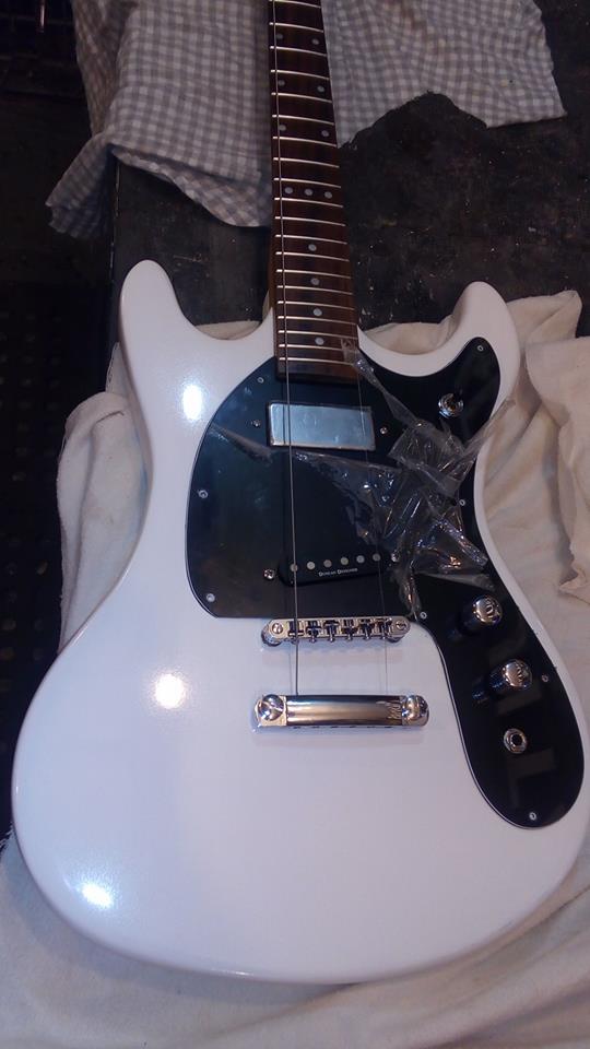

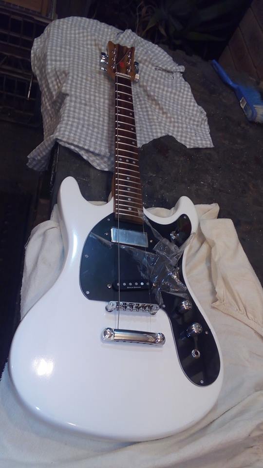

    G'day all, this has been my slowest build ever, started July 2014 ! Thought it was time to pull my finger out and polish and assemble it. I probably started a build diary ages ago but easier to start a new one. Spent about 3 hours yesterday with micro mesh pads and polishing and fret levelling and steel wooliing the fingerboard. Found a 12k ohm single Seymour Duncan pup for the bridge and the stock neck mini bucker is over 10k ohm. Left the plastic on the pickguard as I have to turn it over and complete the wiring. Neck had no play in the pocket and strings and TOM fittings lined up well. Think I have to drop the nut slots as the strings don't touch the zero fret yet. Here's some pics from assembly lastnight

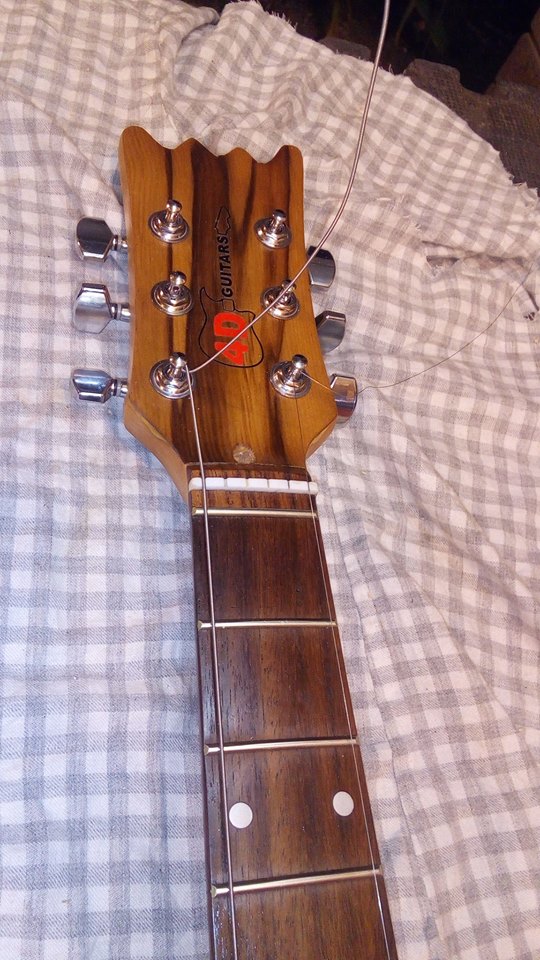

    here's some pics of the headstock, glued blackheart sassafras veneer to it. Hope to finish the wiring this arvo and make some noise !
