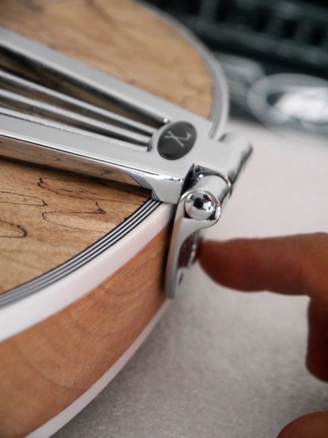

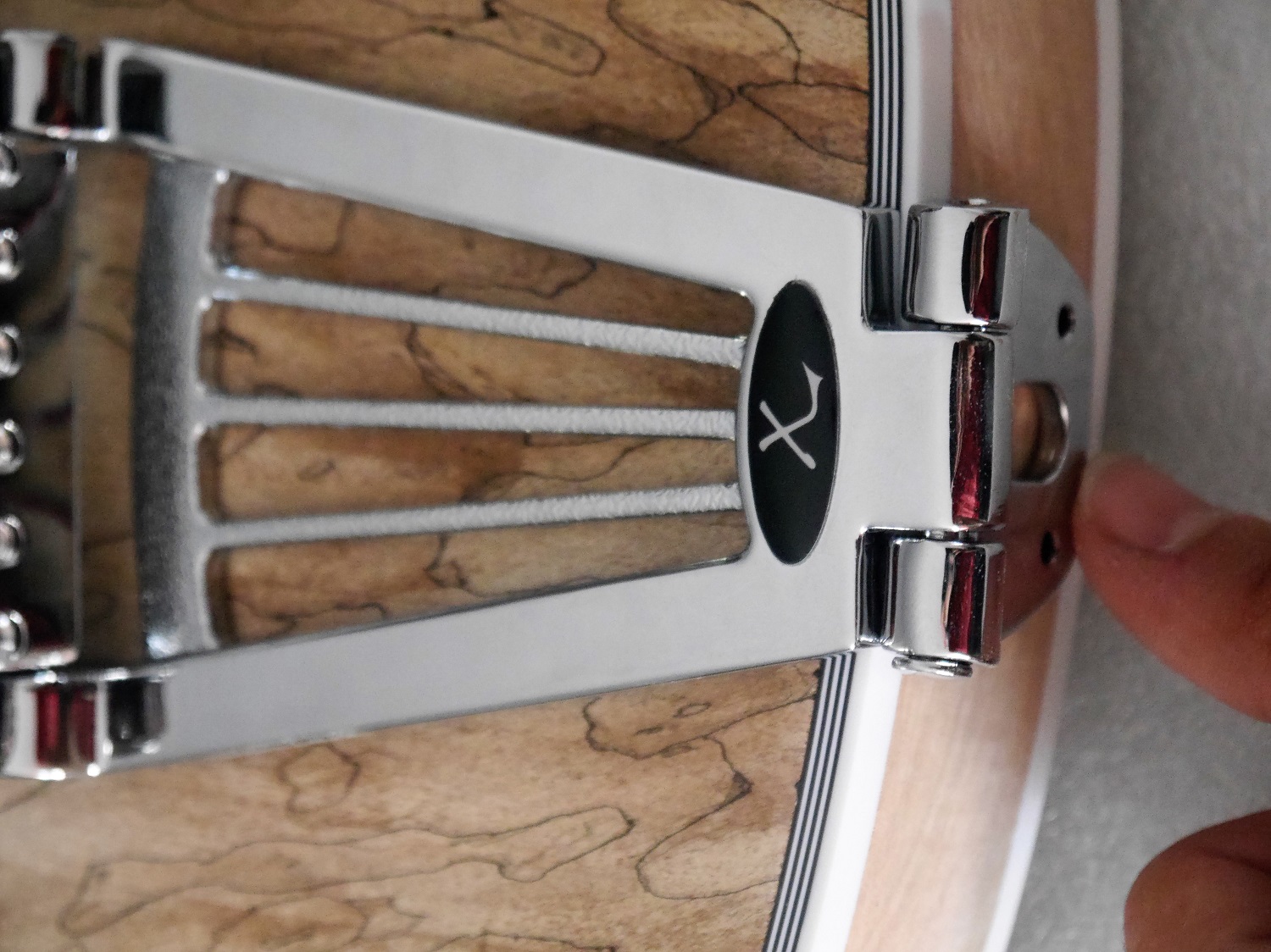

    Just so you know, I have done a lot of work on this so far. I've been working on it for a few months and only now starting the build diary so don't think that I am rushing the job.
    This kit has mahogany sides with maple top and back and spalted veneers. As with most veneers, these are super thin.
    As I mentioned earlier, putting the Xtrem on leaves me with a problem of the attachment point not being flat. This would have left the trem sitting on an angle. I have therefore had to come up with a shim to flatten the base out.
    The shim is a small little wedge which I originally made from pine. Looked great until I realised that the grain lines through such a thin piece of wood made it extremely fragile (it broke in my hands). Mark 2 meant making it out of MDF.

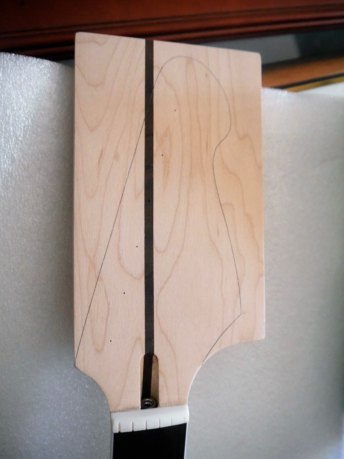

    Was initially planning a natural finish but decided to go with Karajini Red instead.
    The headstock design is pretty simple. My own take on the strat style headstock.
    Rough cut it with a jigsaw and then used sanding drums in my pedestal drill to get it closer before moving to manual labour.

    would the trem fit better if you knocked the hinge pin out and turned the base over?
