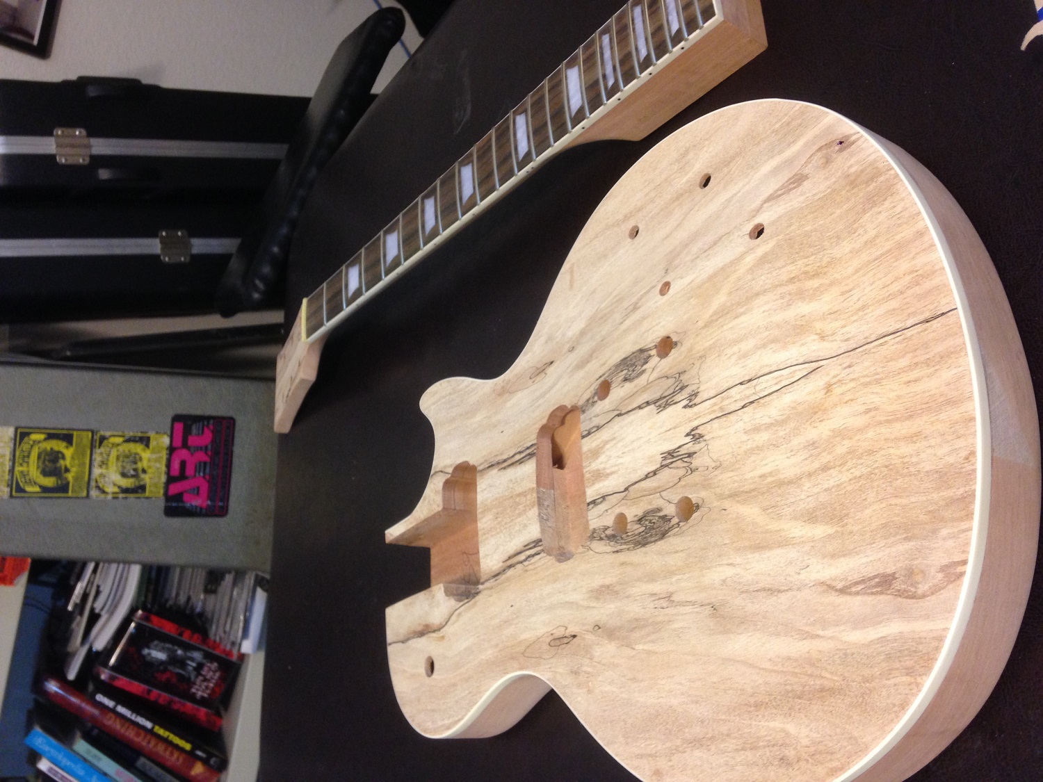

    Finally received my kit and Guitar Finishing Step by Step. Wow what a lot of information, almost too much. Simon, do you have a grain filler that you would recomend for staining? I am assuming that I will only do the low spots in the grain and not the entire guitar. Just so I am clear the sequence is 1 - Filler 2 - Sanding and Sealer 3 - Stain 4 - Laquer. I know it's a dumb question but I want to make sure I understand the basic process so I don't F up this beautifull Spaulted Maple veneer.
    Thanks

    Nice looking splat Garz!
    Personally, I wouldn't recommend grain filling on spalted tops. All I did with my spalted LP was a light sand, then straight into the clear Dingotone stain.
    Keep in mind too, the veneer is super thin, and any excessive sanding could go straight through it. Plus you run the risk of hiding some of the spalt under the grain filler.
    Just something to consider.
