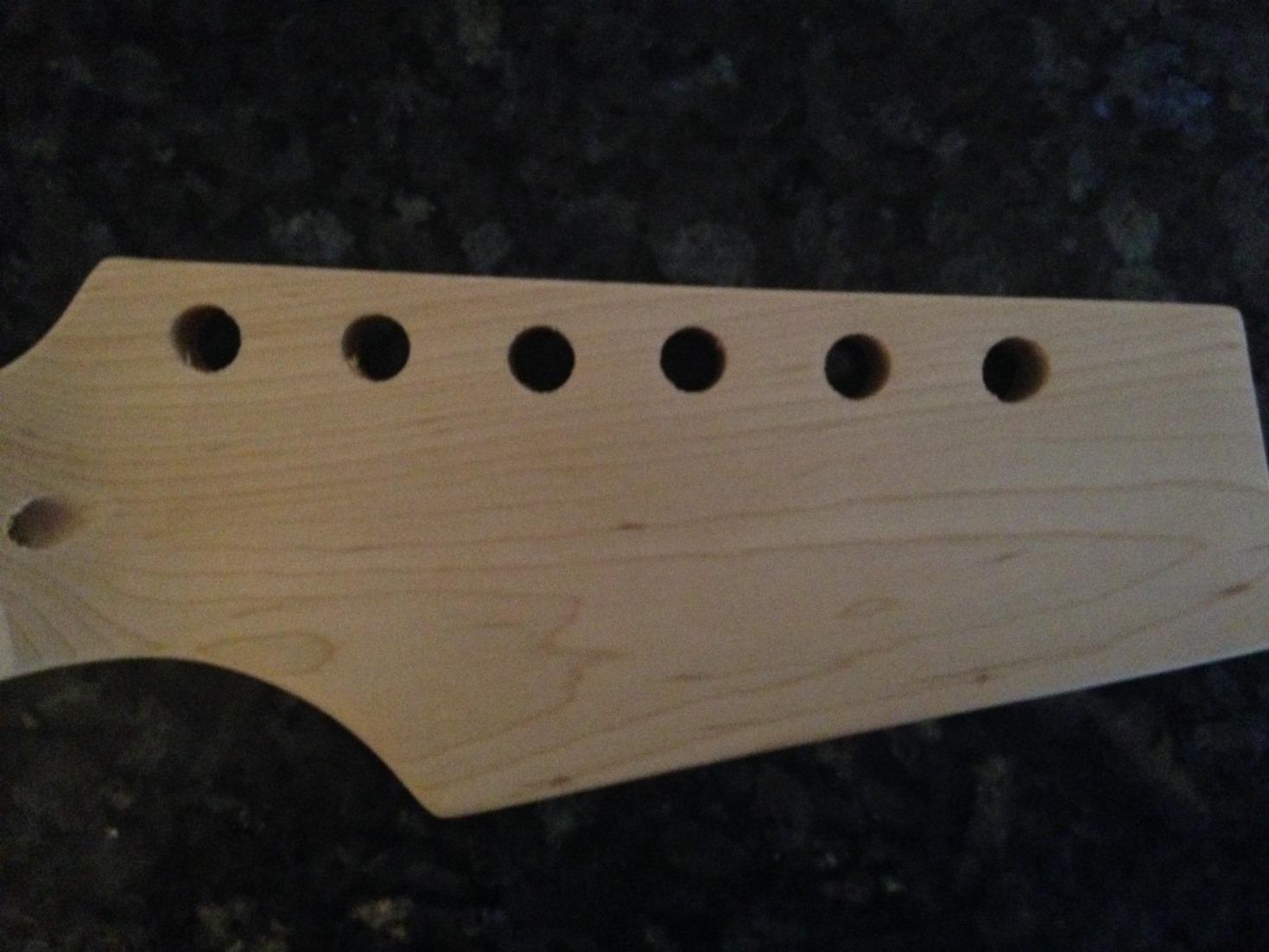

    I know nothing about guitar construction but the tuner holes look like they were drilled by Freddy Kruger.
    Excited but as nervous as a very small nun at a penguin shoot. If I don't screw this up I will be amazed.

    Yes the tuner hole for the D string looks out of place. You will need to see what it looks like with the tuners in to decide if you want to plug and re-drill.

    Thanks Fretworn. Is it simply a cosmetic thing or will it affect playability?

    Headstock Tuners
    In my humble opinion, my wonky tuner hole on the headstock of my ST-1 does not, in any way affect the playability of my guitar. But I am far from a professional guitarist or musician. Just a guy who was in a band once that now enjoys playing with the headphones on.
    It doesn't really ruin the aesthetics of you use the PBG tuners. If you go for vintage style tuners (with square backs) they wont align.
    The intonation of the TL-1 that may be put out by the wonky tuner hole could easily be rectified by the saddle.
    That being said, there are some guys on the forum that do not like wonky holes, have used a maple off cut from the headstock shaping process, filled the current tuner holes, put a veneer over the headstock (or painted it solid) and re-drilled straight.
