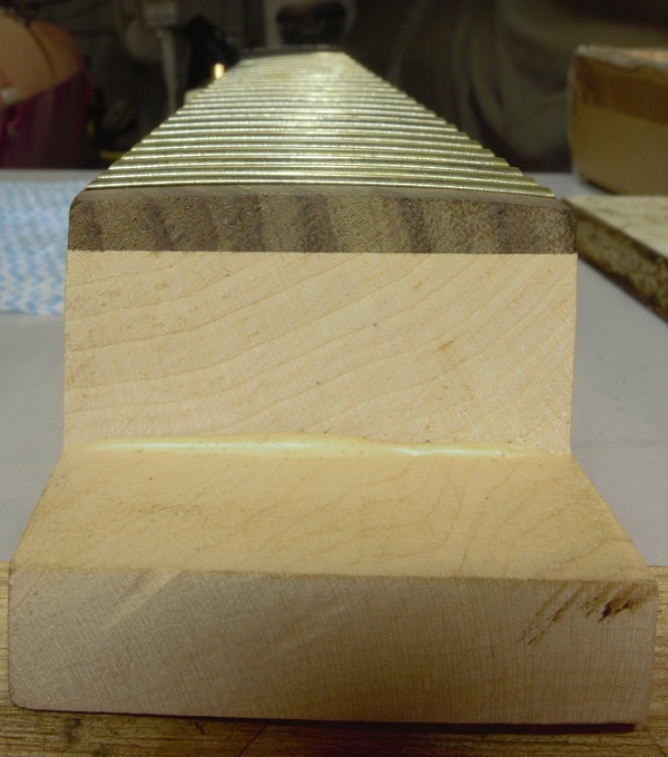

    Anny way, you can see in this picture that as the neck approaches the nut it twists anticlockwise.

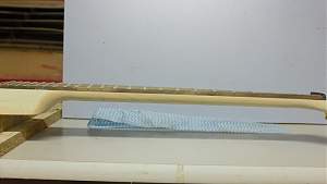

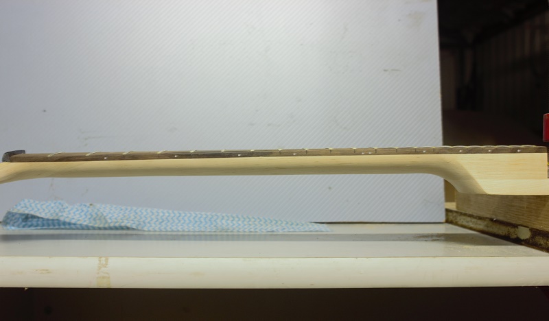

    I this side view you can see the top of the fret board on the left but as you look to the right you can only see the side.

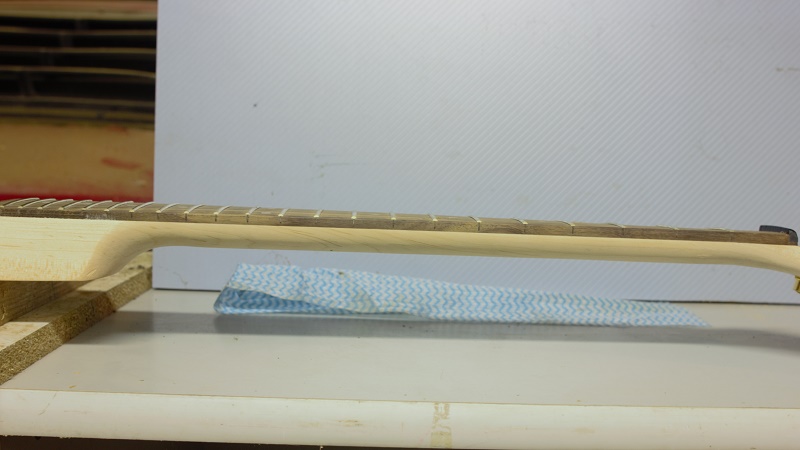

    This is the view from the other side, and again you can see the top of the fret board on the left but as you look to the right you can only see the side.

    Hi Zygoat,
    As per my email, yes, this does look twisted at the headstock end. I think we should get the complete kit back and replace with a new one after we double check the neck.
    We can send you another kit and include a return shipping label which you can put on the box and drop at your post office.
    If you're happy to do this I will arrange asap.
