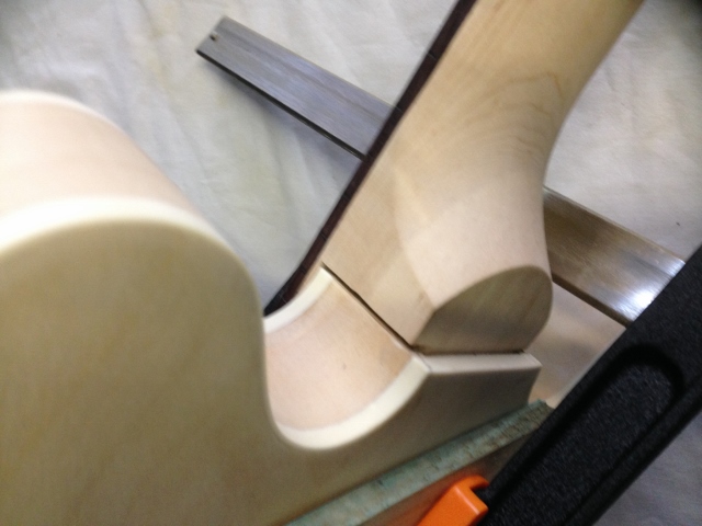

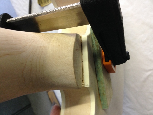

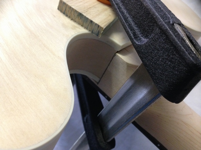

    Hello there, I just received my ES1 G kit this morning. Very excited at the prospect of many happy hours in the garage building it. As recommended, I began a mock build layout to see if all the bits were there,(they are.) I had trouble fitting the neck even though the body & neck were matched at the factory (according to the matching numbers.) There are significant gaps on one side. Question, is this normal? I know it's very early to be asking but I really want to get this 100% right & all you good people on here have the experience I believe. I have taken some pictures on my I Phone of the gaps & as soon as I figure out how to upload them here I will do so. Any suggestions will be greatly appreciated. Thanks folks.

    Hi guys, thanks for the replies. I think I have managed to post pictures of the gaps here.

    Ahhhhhh yes... these kits are a bit more fiddly than most..
    Those gaps are not impossible to deal with.
    Firstly, check the scale length to determine whether you need to add or subtract material from the neck heel.
    My money is on the latter.
    Once you have this sorted, determine where the neck is fouling up in the pocket and start to carefully reshape the areas that are the problem child.
    You may also need to clean up the nottom of the pocket rout to get the neck sitting down nice and flush, the fingerboard should be sitting on the top of the body as well.
    You may find that this wont go due to the area in the cutaway being slightly taller, so again, carefully remove some of the top material until it sits down.
    This is a very brief tute, I am sure you will sort it out.
    Yell out if you run into any problems!

    Thanks for the tips Dingobass, I will do as you suggested when I have completed more of the sanding & staining. I am not overly alarmed by the gaps because, as you suggested, I suspect that I may need to trim somewhere to get the correct scale length. A quick measure this morning indicated that the length was out by a fraction. The fit into the pocket is tight but manageable.

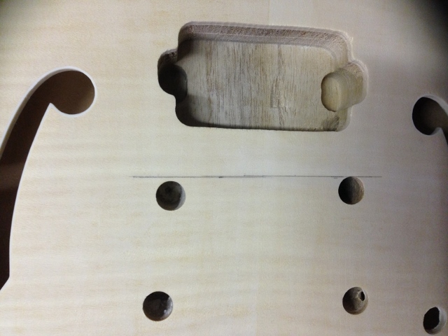

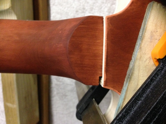

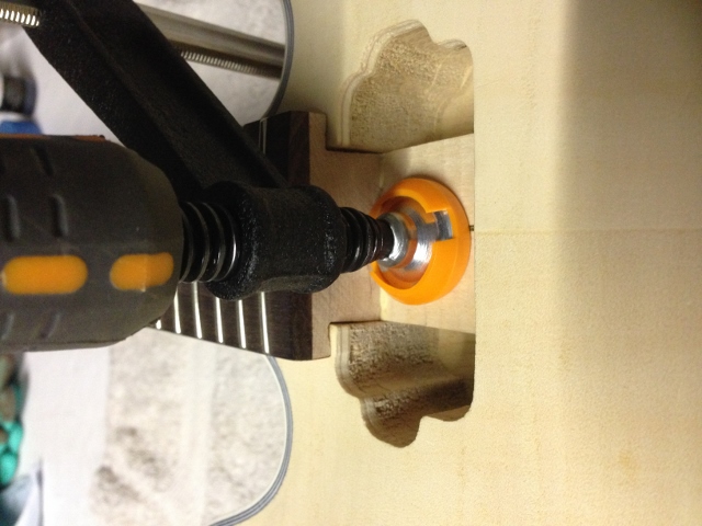

    Some more pics to clarify the problem
    In these pics the neck is firmly seated in the pocket & appears to be at right angles to the body of the guitar. I measured the scale distance 313mm x 2 onto the body, (see pencil mark on guitar forward of the mounting holes for Tune-o- Matic) & this would indicate that the neck is too long at the present time & will need some adjustment. You will also note that one side of the neck stands higher than the other by approximately 2 mm. This is going to take some smart trimming! Wish me luck! Lol. Before I go that far, any other suggestions?
