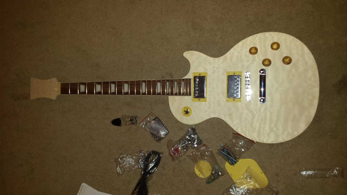

    Hi all, yes first build (probably not the last!) and thoroughly addicted already, I got my kit last week and am loving the process so far. I did a mock build on day 1, all seems good, did have exactly the same panic with the neck fit as Greg did on his LP-1MQ, but found his thread covering that very reassuring.

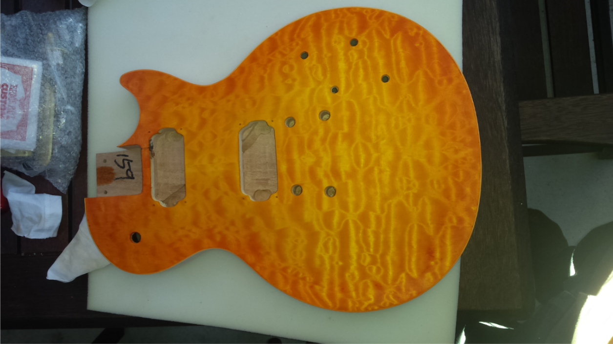

    Anyway after much sanding, 2 stain coats of Gold and a few burst coats later I'm quite chuffed by how its coming along

    Did the first coat of Bushfire on the body this evening, probably do another tomorrow (gotta love good drying conditions in Queensland) and will post another pic then.

    That burst is coming along nicely, DT just looks great on quilted tops. Well done.

    That's looking stunning - great job!
    WOW!
    A stunner!

    Great start and color. It is interesting that the quilts are quite different and patterns change from different directions. Looks like you didn't try any black highlight. Did you sand the cap first?

    That's really beautiful! Fantastic job!

    Great start Dave, that burst is really nice and subtle.
    Well done!

    Thanks for the feedback guys, it's all going to plan at the moment.
    Greg I did sand the cap very lightly with 320 then 400 and then after the first stain coat found some glue and scratches I had missed the first time around, I was probably lucky not to go through the veneer, I just had all the advice ringing in my ears about not over doing it. I'll post a photo later of my first stain coat so you can see what I mean
