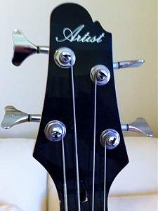

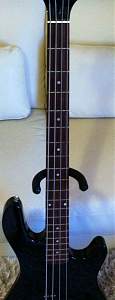

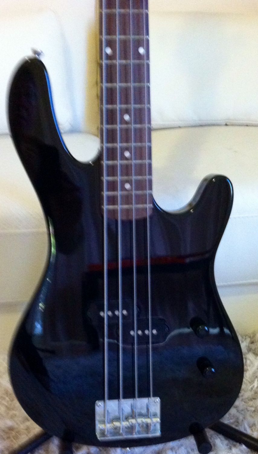

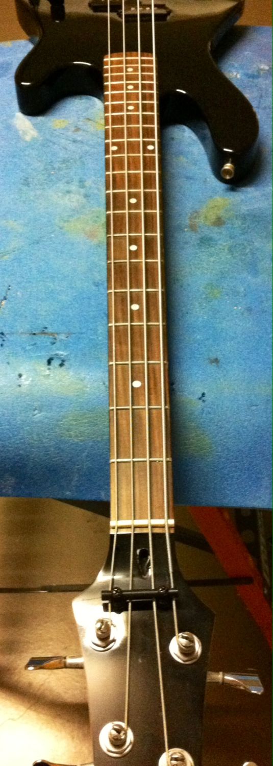

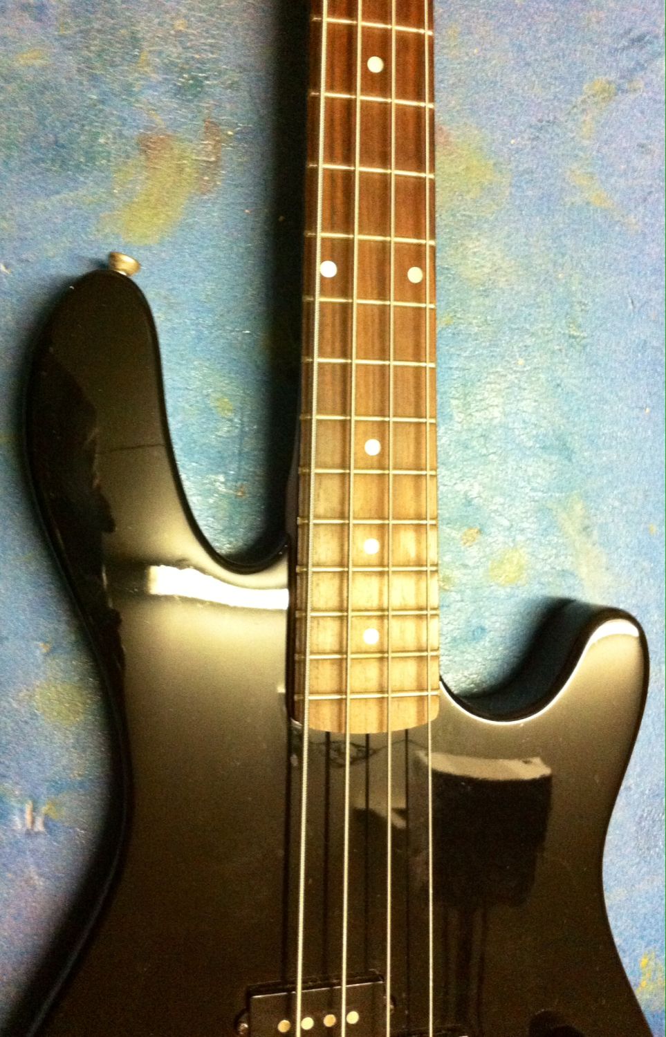

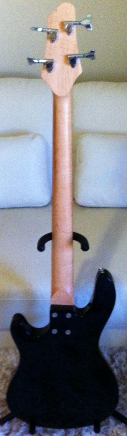

    Was thinking about building a fretless when it dawned on me that I had this cheapie kicking around and looking rather neglected in a corner hidden behind 2 other guitars, then it dawned on me, why not have a go at converting this one as it only owes me about 50 bucks?
    Looked at a few forum threads, some vids on youtube, and it doesn't look too hard so here goes. Initially bought a bag of white plastic pot plant label strips to fill the joints left behind after de-fretting but stumbled on an old thread where DB had done an amazing job on a HB4 for Gavin. Wow, what a shiny neck so off I went and bought some natural coloured timbermate and have ordered some thin CA glue too.
    Here after the Before shots......

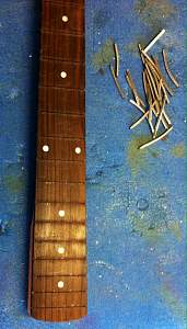

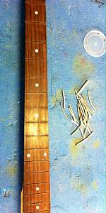

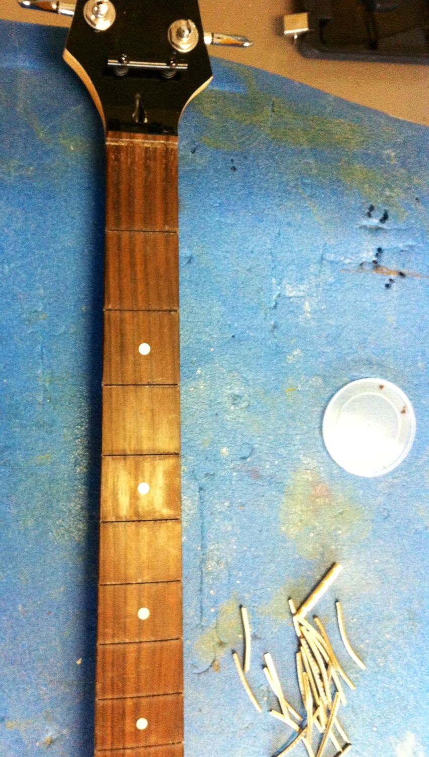

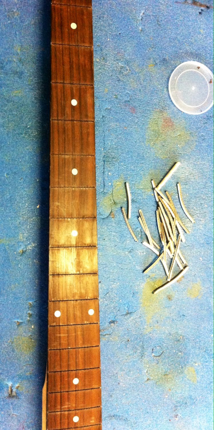

    Well, had a spare bit of time towards end of this afternoon and decided to make a start on making this a fretless......
ID:	11599Click image for larger version.

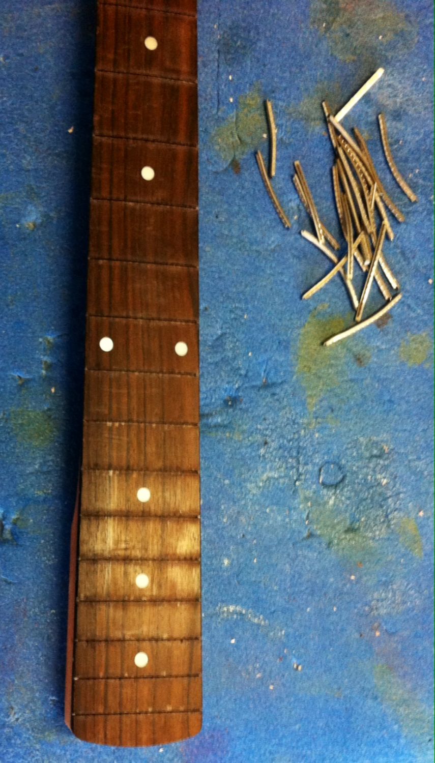

    Now that the patient has been sedated time to pull some teeth....errr I mean speed bumps....
ID:	11601Click image for larger version.
ID:	11602Click image for larger version.

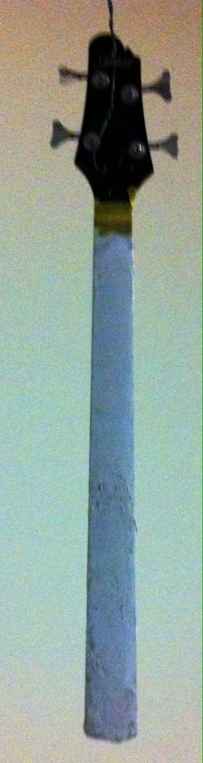

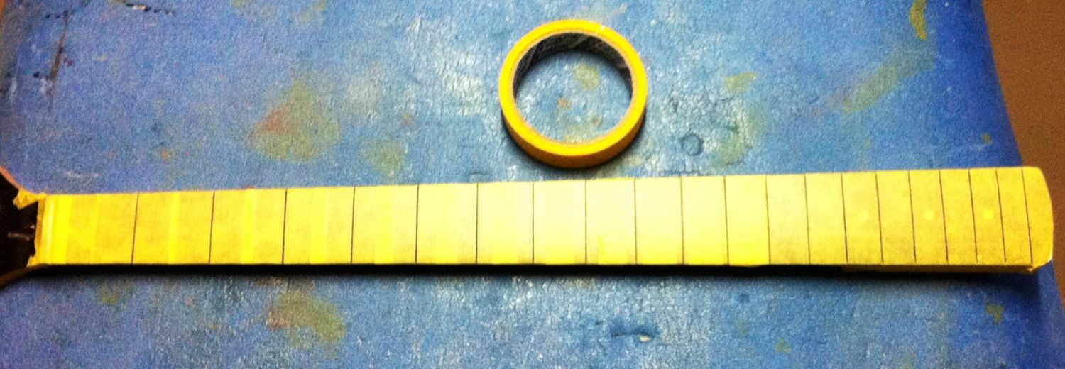

    Then sanded things down with a bit of 180 before taping up ahead of applying Natural coloured timbermate....
    Job done and now hung up to dry....

    Hi Kimball, DB's prior thread for Gavmeister's Hoffner caught my eye and hope to do a similar job. Fret board cuts were quite shallow to accommodate the fret wire that was just under 2 mm deep.
    Surprised how much damage can be easily caused when yanking out the frets as the Rosewood badly splintered along many of the fret edges once removed. Cheap materials used in the construction may have also contributed and it will be a nervous peeling off of the masking tape so as to avoid any further damage. Might need to spread a layer of Ebony Timbermate to fill in some of the cracks & divots before performing a final sand and prep for the CA glue.
