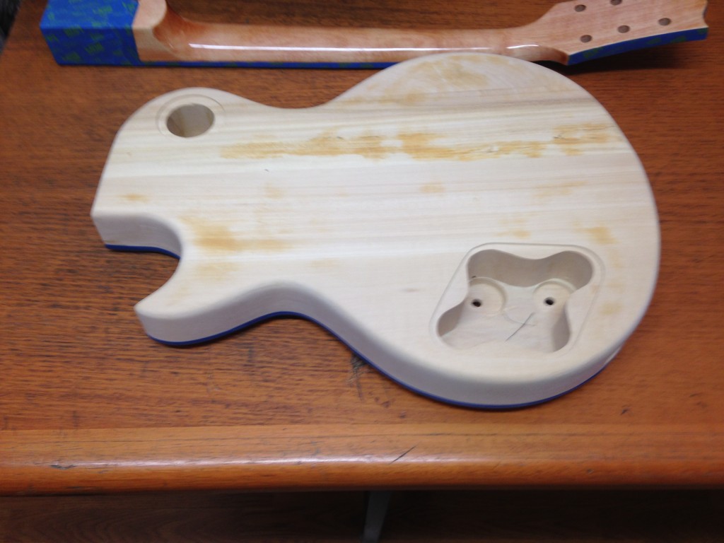

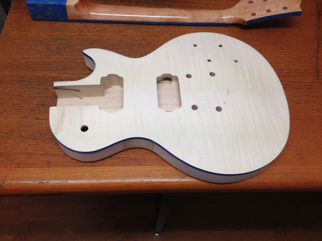

    At DBs suggestion this is my diary for a LP build. DB is sending me a beta test of a paler version of Bondi Blue dingotone. I've sanded the front to 1200 due to the thinness of the veneer and masked the binding and waiting for dingotone to arrive. Is the masking necessary given that I'm using a stain and the binding is plastic. Secondly I've used a grain filler on part of the back which looks darker than the rest. Will this show up using the stain. Click image for larger version.

    Hey Salo looks great. It saves cleaning up the binding later taping it off so worth doing. What colour is the grain filler on the back ? If a pale bondi blue is going over that I would sand a bit more of the yellow areas off or the blue stain won't "take".
    The neck is looking fantastic, what stain/clear coat is on that ?

    Thanks Wokka. Grain filler is your usual wood colour and the label says it's stain-able but I will sand some more. The neck has had about 6 coats of T**-Oil (I gather I'm not suppose to use that word). I use the aerosol version and it works fantastically and I bought it before I heard of PBG.
    nice one Salo. You could try a sample stain over the grain filler but doubt it will be the same colour as the basswood.
    I like the flame on that....where's Padbury?
