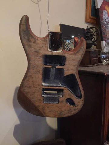

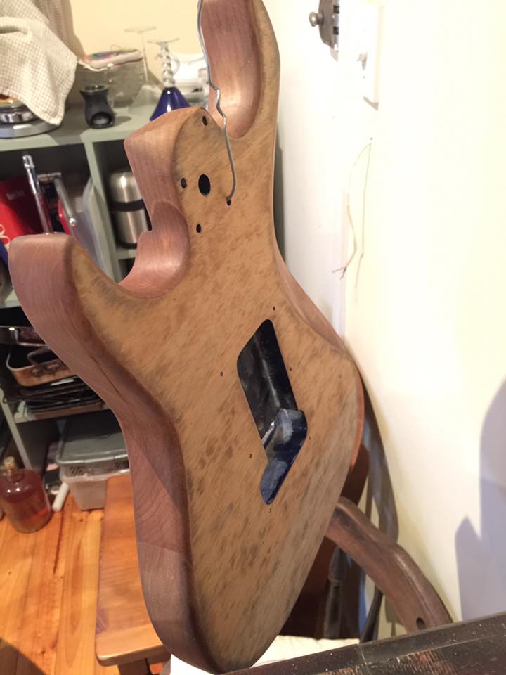

    Hi all,
    My name is Jarrod and on thursday afternoon my lovely fiance came home with my first ever Pitbull Guitars delivery, the PRS-1Q kit.
    So excited to get started on this build. I also grabbed some Dingotone in Bondi Blue and Black Stump. Mainly due to the fact that i couldn't choose between the two!
    I am currently in the process of finishing a complete strip and rebuild of my first guitar i ever owned (Fender Squire Stagemaster) so i have taken to trying out the dingo tone on it before touching the prs just in case i'm not keen on the colour.
    So far the age of the wood and the fact that its mostly pine means the colour isn't penetrating as much as i thought it would, but its not looking too bad.
    here are a couple of photos of the fender, cant wait to start uploading the PRS build.
    Any PRS builders with any info/tips/tricks, Please feel free to let me in on some secrets!
    Thanx Guys

    Hi Jarrod welcome to the forum. Cool kit to start on the PRS-1Q. I'm a bit confused why your username is Chas ?
    An important tip is the quilted maple veneers are very thin so only sand the veneer lightly with 320 or higher grit. Several forum members have sanded through the cap.
    Do a mock build to make sure the kit fits together and all the parts are there.
    Rest of the body and the neck go for gold sanding. If you are thinking about a black/blue burst have a practice on some scrap wood.
    Good luck
    The Squire is looking pretty good !
