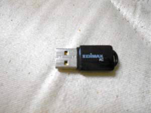

    Here's a pic of the Edimax WiFi adaptor I was using with my DAW PC to get it online, I'm suspecting that there's a compatibility issue with the driver software and Windows 10, I've got the most recent version installed, which I downloaded from the official Edimax website, it's supposed to be compatible with Windows 8 so it should also work in Windows 10, since Windows 10 is based on the same code as Windows 8:

    What model/version Edimax do you have?
    It's an Edimax EW-7811UTC usb WiFi adaptor.

    If the device is installed correctly and not showing any !'s in the hardware manager, double-check the drivers are up to date and not showing errors as Win 10 supposedly has a valid driver for that model (I think it should show as a Realtek driver for that Edimax).
    If everythng checks out then maybe have a look at what 'ipconfig /all' shows from the command line.
    As a last resort you could try downloading a Win 8.1 driver package for it, uninstall the device then install the driver in Win 8.1 compatibility mode.

    I'll give ipconfig/all a go tomorrow, I had a look on the Edimax website and the most recent driver for the EW-7811UTC usb WiFi Adaptor was written for Windows 8.1, that's the driver that's installed on my DAW PC, maybe if I try re-installing it in compatibility mode for Windows 8.1 it may work better, if I have no luck in the morning I'll wait till next Tuesday and buy what I need to run a length of Cat.5 cable from the NBN Co box in my kitchen to my bedroom as planned.
