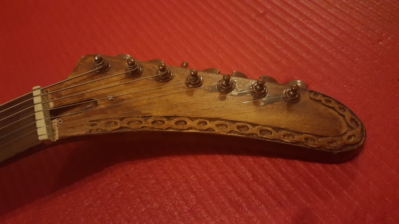

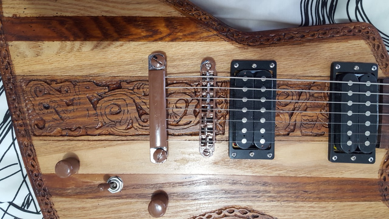

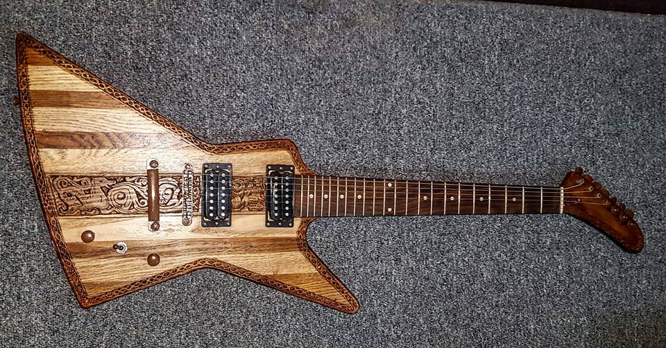

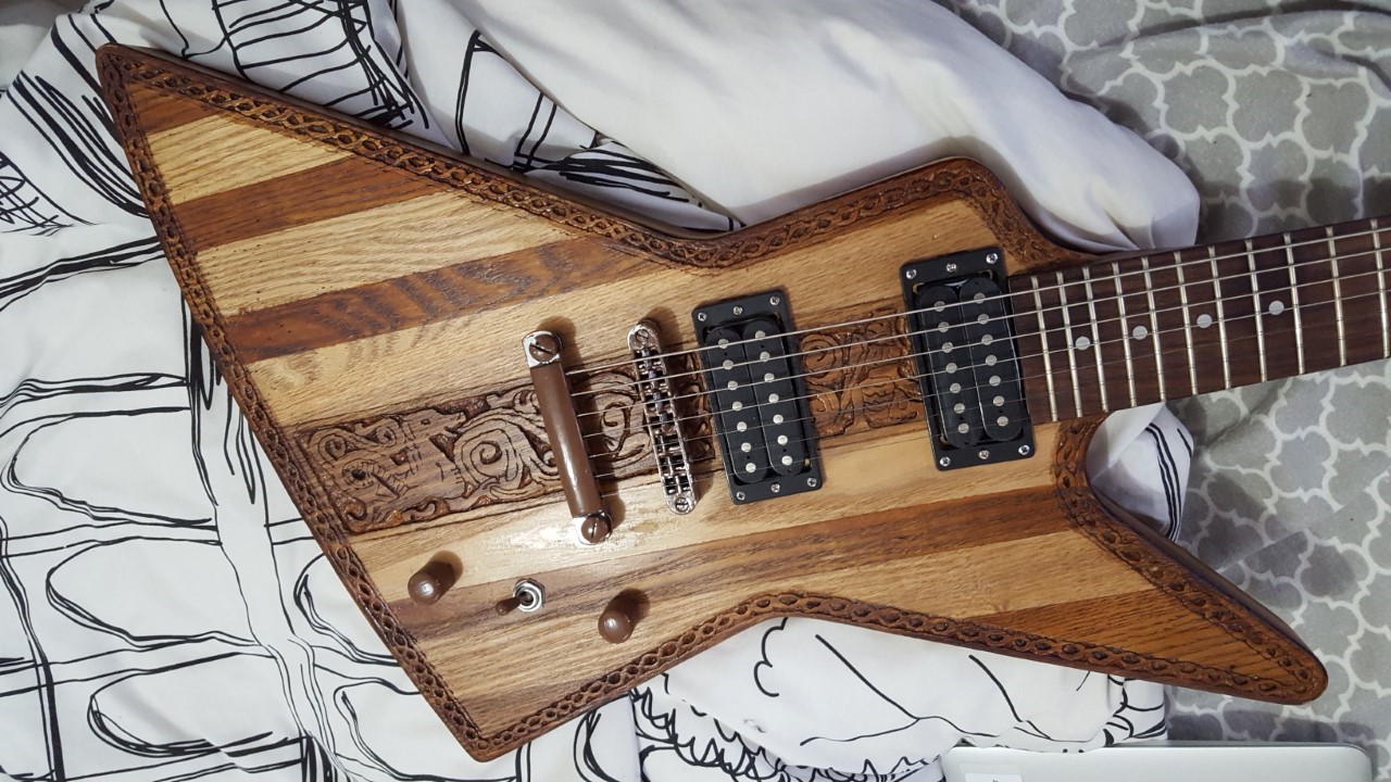

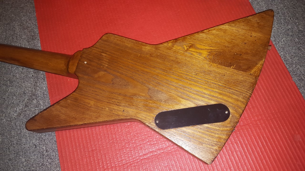

    HI guys, some of you might have already seen my build, it's a 7 string ash explorer, my first project guitar, back then I had no idea about guitars and felt like I rushed this project, any way the finish is a bit messy, i've changed the nut to bone nut and adjusted the truss rod, now it plays pretty well. I've just ordered a sg f1 kit hoping to start on the project next week. Got one question regarding the SG kit, do I sand the top vertically or horizontally? Coz the back would have be sanding vertically for sure aye?

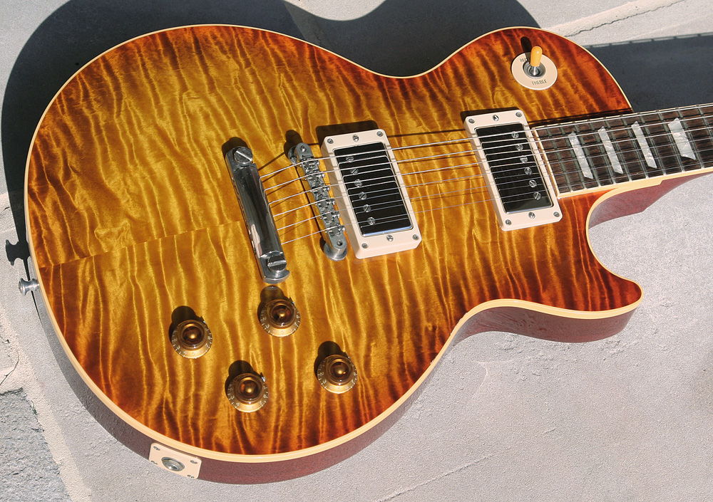

    the flame top is going vertically across the top tho, so like how would you sand this les paul top in the pic?

    Moderator dingobass's Avatar
    4,491
    The flame or figuring is not indicative of grain direction...
    Confusing I know as you would think it is. However the grain runs neck to heel just like normal timber.
    i see, so i just sand it vertically like the back
