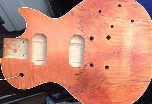

    This is my LP kit stained with Bush fire Sunrise dingo tone, still to apply the intensifying coat..
