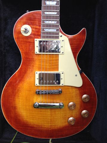

    Hi All , sorry this is a bit late in coming and not too detailed but better than nothing .
    Any way , the guitar is as follows
    LP1-M kit
    Tonerider AC4 pickups
    Grover locking tuners
    Bone nut
    Finish is U Beaut wood dyes mixed to suit with an acrylic lacquer clearcoat .

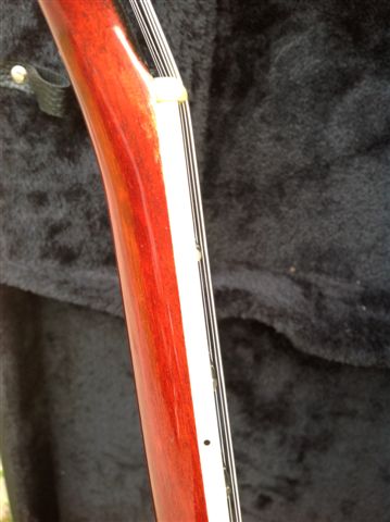

    I have encountered an issue with the nut but otherwise no major dramas and
    despite the nut issue is coming along OK but I will need to sort this out .
    The problem is that I set the height using strings 1 and 6 only ,and set to
    a conservative height (hopefully the pix show this ) but after glueing and stringing
    found that the 1st fret clearance on strings 3 and 4 was almost zero .
    A little tweak of the truss rod and saddle heights got it playable but it does
    buzz the first on 3 and 4 slightly . Looks like I will have to crack the nut back out
    but I will play it in for a week or so first
    Once sorted though and given a proper setup it will be quite a nice guitar .
    It still only has the standard kit strings on it so will be better again with the EB's
    Cheers
    Andy

    nice build Ampman very cool looking LP, nice choice of colours. How do the Toneriders sound and are the tuners ok ?
    sounds like needs a few more fine tweaks. Can we please see a pic of the finished headstock ? cheers
    Thanks for the compliments , I'm really happy with the way the colours came out .
    I was spraying the clear under EXTREMELY adverse conditions so if you saw it straight
    off the gun you would be amazed at how well it came up . Thank God for 1200 wet and dry .
    As for the Grovers its early days of course but so far they are brilliant .
    My HS Anderson has Schallers on it which I feel have a smoother , more precise
    action , but that locking function on the Grovers is really good .
    Takes no time at all to string and tune and no issues so far .
    I did read that they can break high E strings but the cure is to put one turn on first prior to tensioning .
    I wouldnt say the Toneriders are the best pickup available but for the price they are good value .
    I will reserve final judgement till I get decent strings on it , these ones were initially terrible
    and made for a pretty average sound till they wore in .

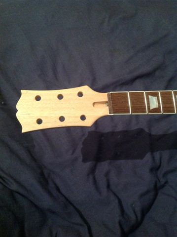

    I will post another pic of the headstock once I decide what to do . I left the tape on too long and tore
    the clear on the top of the headstock unfortunately .
    Not a major drama as I'm now thinking of doing a laminate with a fancy inlay and I'm going to have to break
    the nut out I suspect to sort the other issue. It is shaped like a 50 's Les Paul , maybe not exact but looks good .
    Cheers

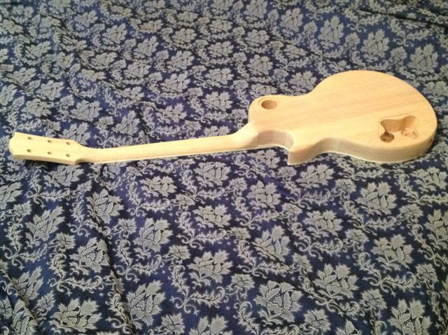

    I forgot to mention that I have done some mods from standard so to update .
    The first can be seen from the pic of the back . I removed a fair amount from
    the back of the neck near the pocket and radiused it to look more like a real Gibson.
    There was too much in the way trying to get right up the neck !
    The other was to use some really old Japanese paper and oil caps instead of the
    polyester (greencaps) ones that were supplied with the kit . Everyone seems to think
    paper and oil sounds better and they were left overs from when I built my 12 watt amp
    so why not .
    I will change the pots for decent ones with a switch for coil splitting in the future
    It's now had the nut reset , the Ernie Ball strings fitted , a quick twang and rough setup
    with very promising results . Haven't plugged it in yet but thats next so will update further .
    Cheers
    Andy ( Ampman )
    Nice work Andy, a very slick guitar, what is happening on the face of the headstock?
