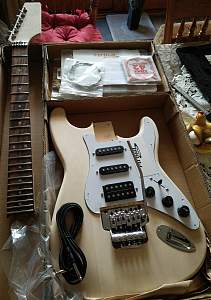

    Received Kit quickly, it's nice. But I have a volume knob on one of the Tone pots. other than that, it seems great.

    Welcome to the forum Ducklets. Any chance of a piccy of the kit?
    Kit partial assembly

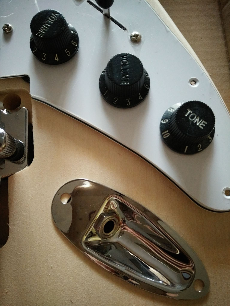

    Controls. Two volume knobs. The middle knob is on a pot with a capacitor, so it definately is supposed to be a Tone knob

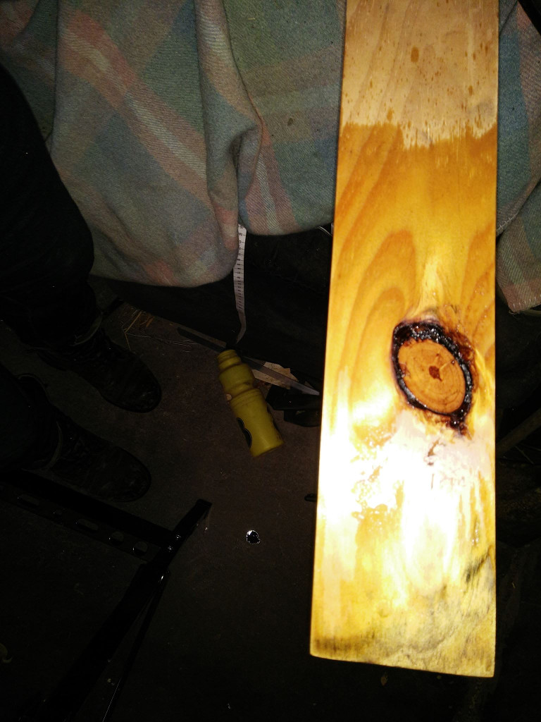

    Test of oil. will finish this, then test Primer and paint over it.

    On the Controls image, you can see the edge of the jack cutout thru the screw hole. I'll see if i can adjust the jack position, and do some undercut carving, to give the screw more purchase. Also, the tuner holes seem over-large, 10.3mm diameter, and the pegs are 9.6mm dia. they rattle around a bit.

    Undercut the jack cutout with my dremel. The wood separating the spring compartment from the bridge pickup is only about 3mm thick, and they've tried drilling a 12mm hole for the ground wire. Understandably, it's a mess. perhaps a 3-4mm hole would be more sensible?

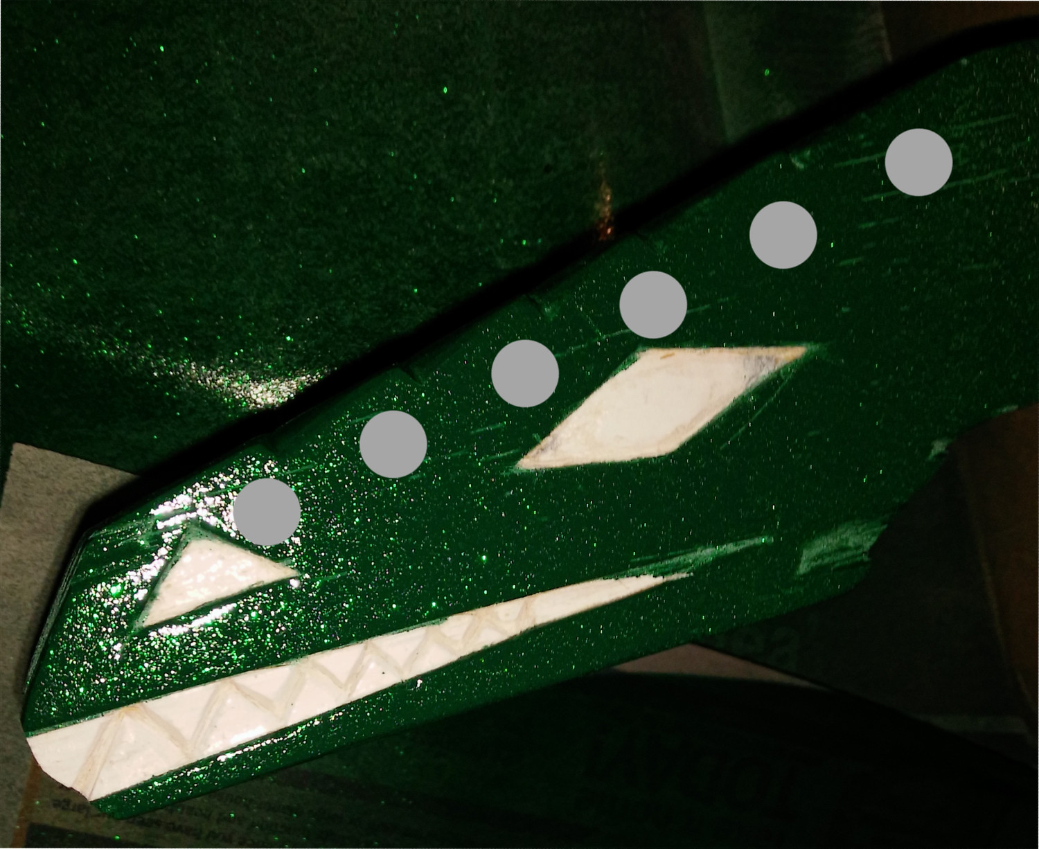

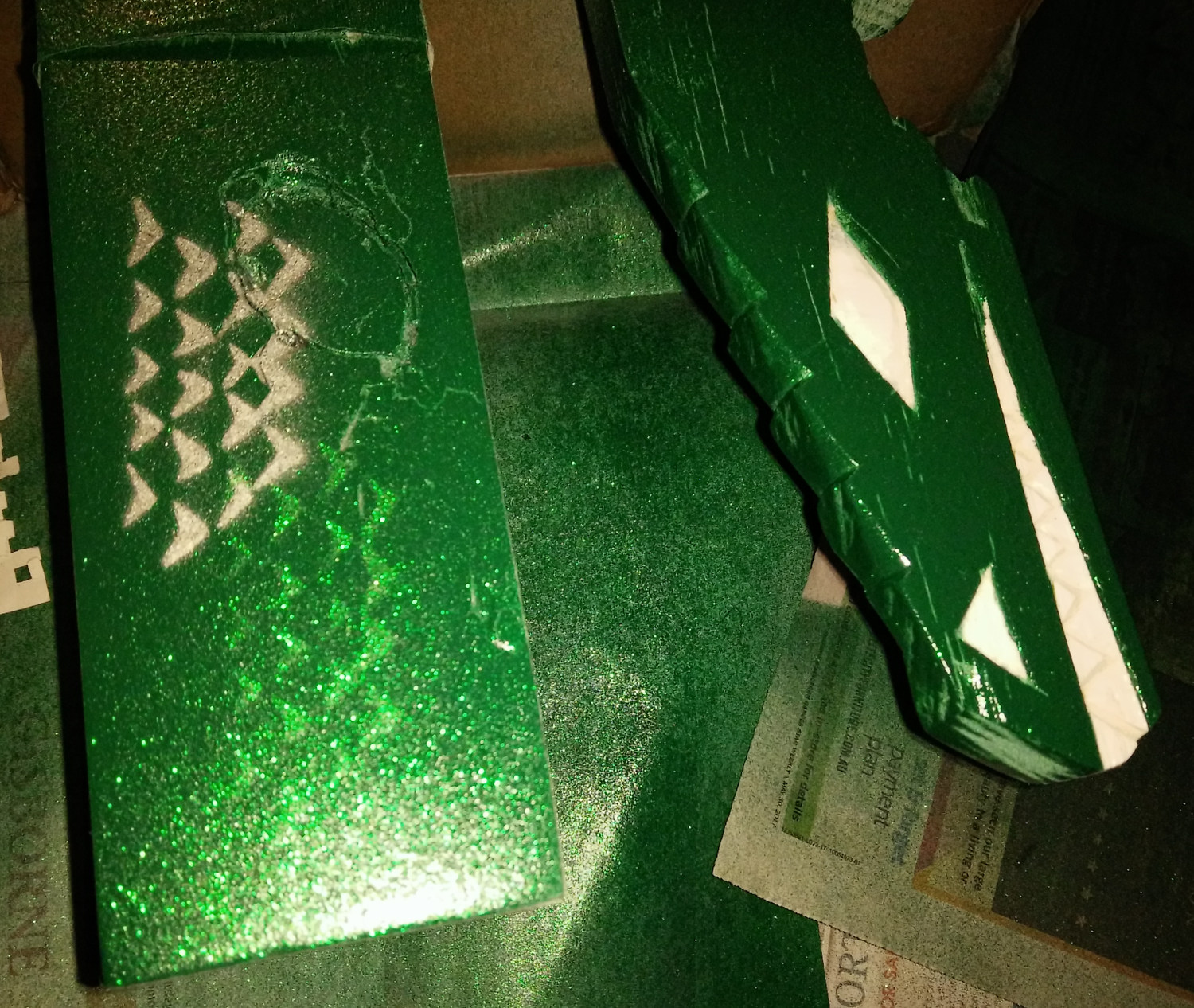

ID:	22730Click image for larger version.
    Put in some silver circles roughly where the tuner posts will be. I'm going to cut the notches deeper on the final design of the head. Was working on some scale patterns for the body, obviously the silver doesn't work. Was considering writing the idea off, but tried using the template with glitter, and it looks good. Going to have to make a much better template, and give some serious thought to what happens near the edges of the body.
    The photos don't do the glitter justice, and was pretty happy with how the masking came out. The final design will have a iris painted on.
