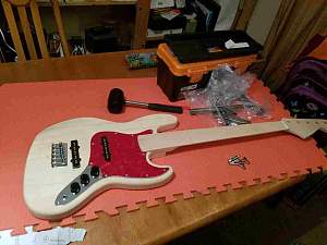

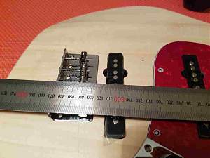

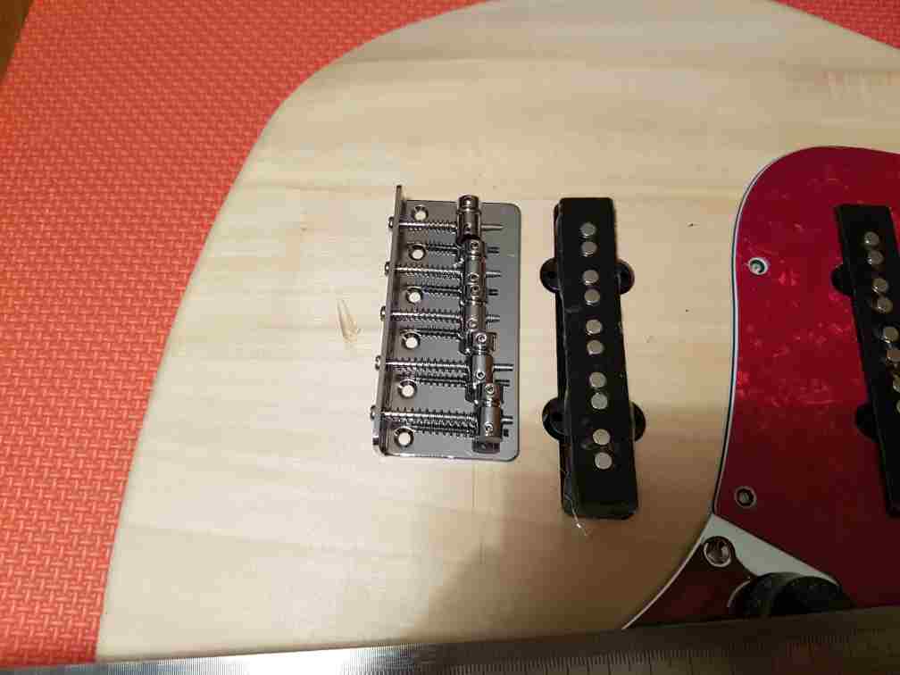

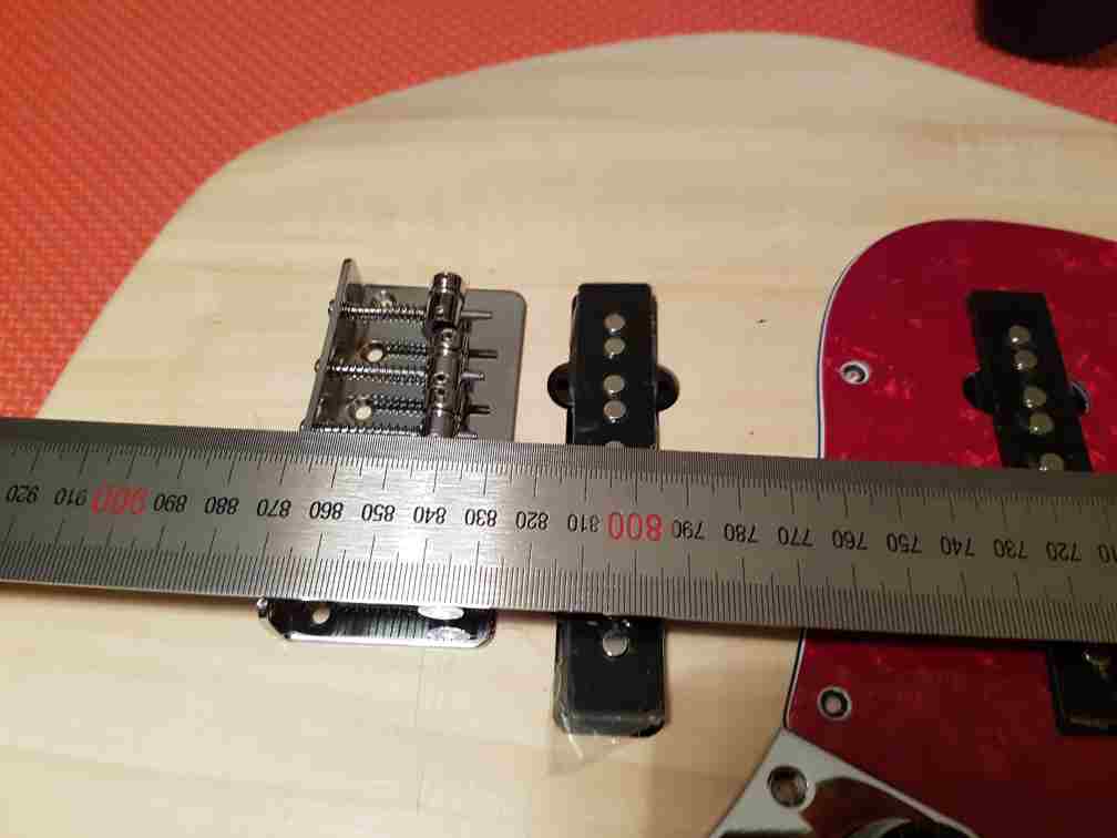

    Hi all y'all.
    Didn't take long to find my first snag.
    Started to do my mock build. Neck fits the neck pocket nice and snugly. Measured the distance from inside the nut to where the second (closest to the bridge) of the two dots indicating P12 at 420mm which sounds pretty much spot on.
    So, place the pups into position, pick guard, wiring panel ...
    And then I go to place the tailpiece so the the saddle for third sting is at 840mm from the inside of the nut, only to find that the hole for the earth wire is quite a bit further out, beyond the end of the tailpiece.
    So, what have I got wrong here? What am I missing?

    You need to measure to the 'crown' or peak of the fretwire of the 12th fret, not the centre of the fret area. I'm guessing that will add about 10-12mm to your half scale and should give about 863-864mm'ish at full scale. As you've got a fretless you need to work from 34" scale using a straight measurement, so convert to mm's and go from there ().

    I was updating my post as you replied, with a fretless you need to work straight from a 34" scale measurement (~863.6mm).
    BTW your side dots will (most likely) be the same as the fretted version of the bass, so they are only showing the rough mid-point of the fret not the scale accurate fret lines and cannot be used for measurement.

    You might need to check the dot placement on the side of the neck. The dots on the fretless neck of the JB5 I recently finished were a bit out. Have a look at the fret calculator on the Stewmac website http://www.stewmac.com/FretCalculator, I found it very useful. It also tells you that, on this style bass the distance between the screw holes in the bridge and the nut should be 35"

    I converted a JBA-4 to fretless. I'm pretty sure it's the same scale length as the JB-5. Obviously I had the luxury of measuring to the fret crown before I removed the frets, but...
    I just measured to between the two 12th fret dots, and yeah, that's 420mm.
    But since I removed the frets and filled the slots instead of starting with a fretless neck, I can measure to where the fret crown was. That's about 431-432mm (and the same from there to the saddle), which is in line with what WeirdBits said with the scale length being 863.3mm.
