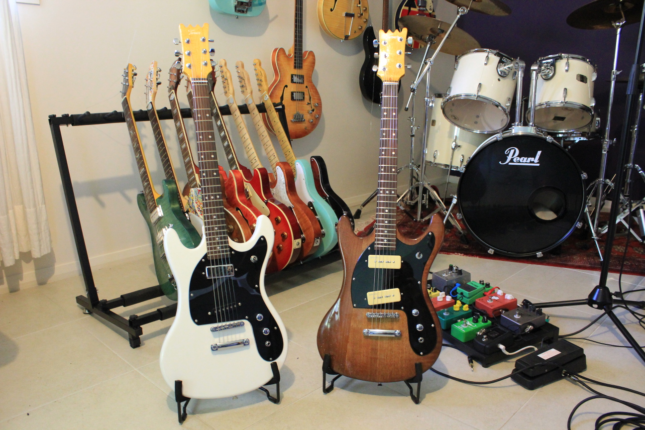

    Same, same, same. I'm a huge Johnny fan and jumped on the MK-2 as soon as Ads was able to source it as a kit. Personally I've built both the MK-2 and the MKA-2 and I love the crap out of both of them. They play really nicely and look awesome (IMHO). You'll find my build diaries around the place somewhere.
    I finished both in acrylic clear coats and with tru-oil necks. The MKA-2 is dyed with Colortone while the MK-2 has a solid paint job.
    Here are a couple of specs based on my two finished guitars:
    MK-2: weight 3.7kg
    MKA-2: weight 4.3kg** note I added belly and arm cuts to mine and routed for P90s so lighter than it would have been!
    Both have stock hardware except the pickups. The MK-2 has a Dimarzio FS-1 in the bridge position (Johnny's preferred!) and the stock mini-hum in the neck position. The MKA-2 has two Entwistle P90s.
    The distance from the base strap peg to the base of the neck pocket is approx 355mm.
    At its widest point the body is approx 330mm, at its thinnest approx 220mm.
    The distance from the base strap peg to the end of the longest horn in approx 460mm.
    The body itself is approx 45mm thick.
    These measurements are accurate to within about 5mm.
    I have seen at least one post from a purist here-abouts bemoaning the differences between the MK-2 body shape and the "true" replicas out there. Yes *the specs are different* but as far as I'm concerned the finished guitar is awesome.
    Personally I would really recommend either of the kits. The ash is definitely heavier, but the basswood is still quite a heavy guitar - something like a tele rather than a strat. They are both a blast to put together and play.
