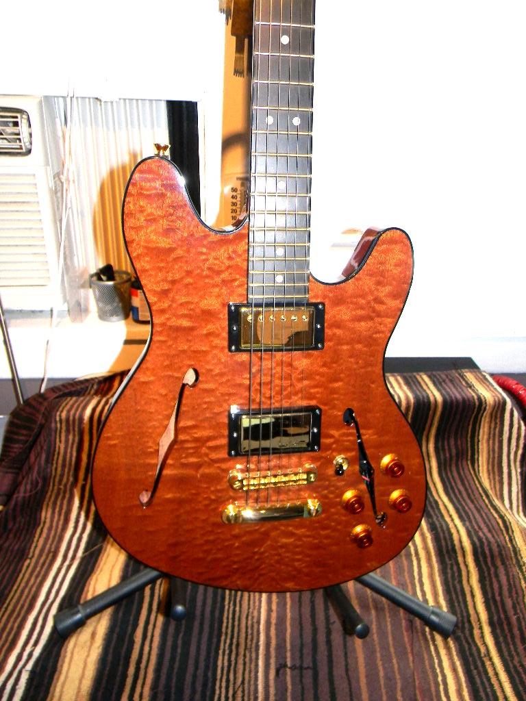

    Warmoth makes only high quality parts. So if you know what you want, (and they'll help you) you can get a fantastic build on the body, neck or both. You can also buy an nice new guitar for the price of a Warmoth Parts guitar. But if you have the knowledge, the Warmoth is much more "custom and specific" to your taste. Mine cost $1450.00 US plus electronics, hardware and set-up; which I did myself. But there's nothing like it anywhere! I had it come already finished.
