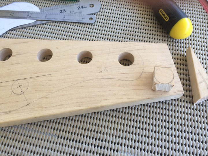

    My first decision was do I do the smart thing and buy an 18mm plug cutter, or do I make a plug by hand? As you have probably already guessed, I was not overly blessed with the smart gene so I decided to make a plug out of a bit of maple left over from a headstock from an earlier build. As per my recent penchant for hand tools, it was all done by hand. Saw, rasp, file and finally sandpaper. Not all that pretty, but it got the job done.
    Next was to drill a replacement hole for the 4th tuner a-la MM. Again I had the choice of the smart (buy a new bit) or the dumb…... So I drilled a 14mm hole (the nearest bit size I had to 18mm) and reamed the rest out by hand (rat-tailed file and sandpaper).

    Pic 1 - The embryonic plug and a rough outline of the headstock shape
