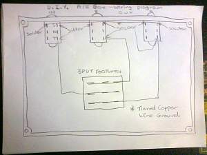

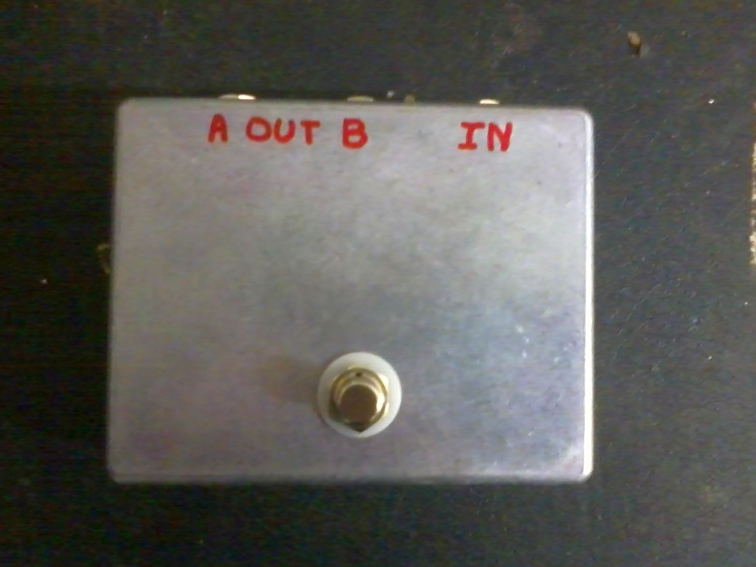

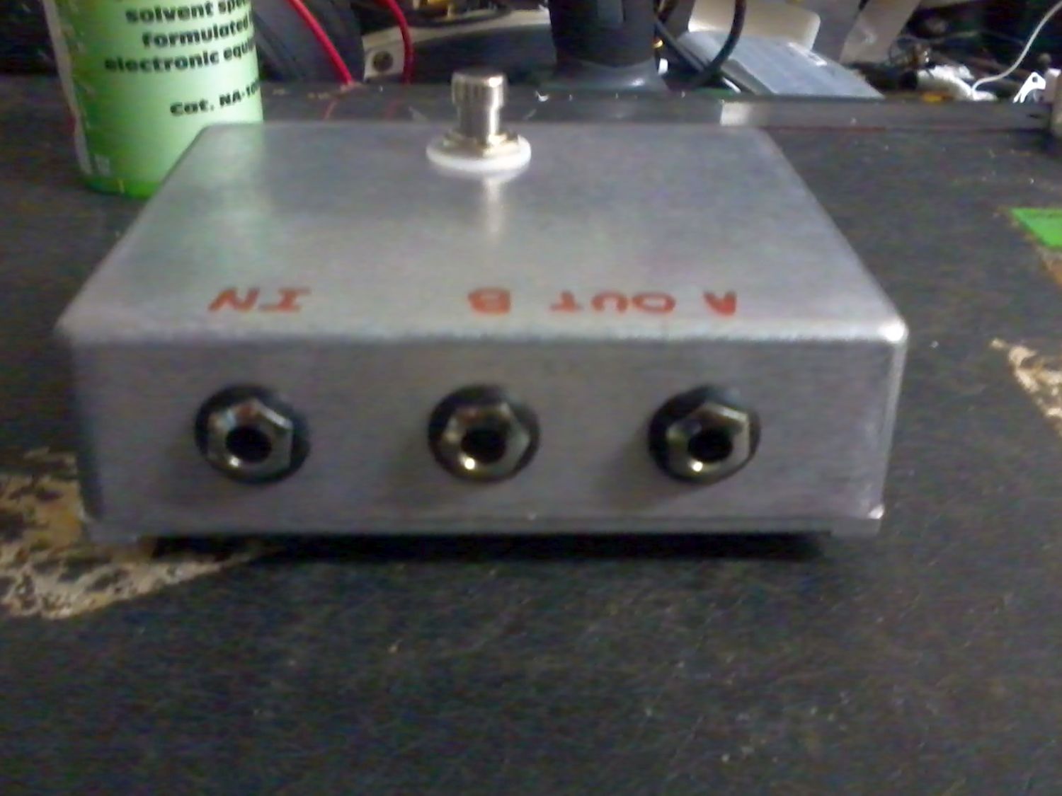

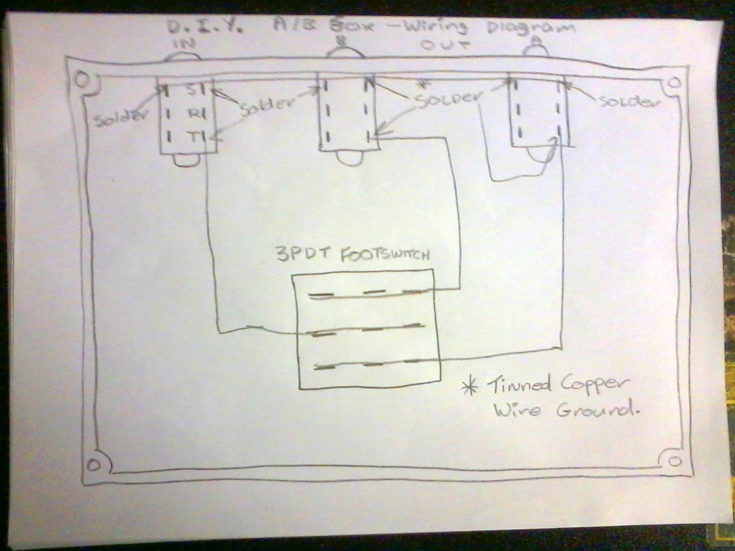

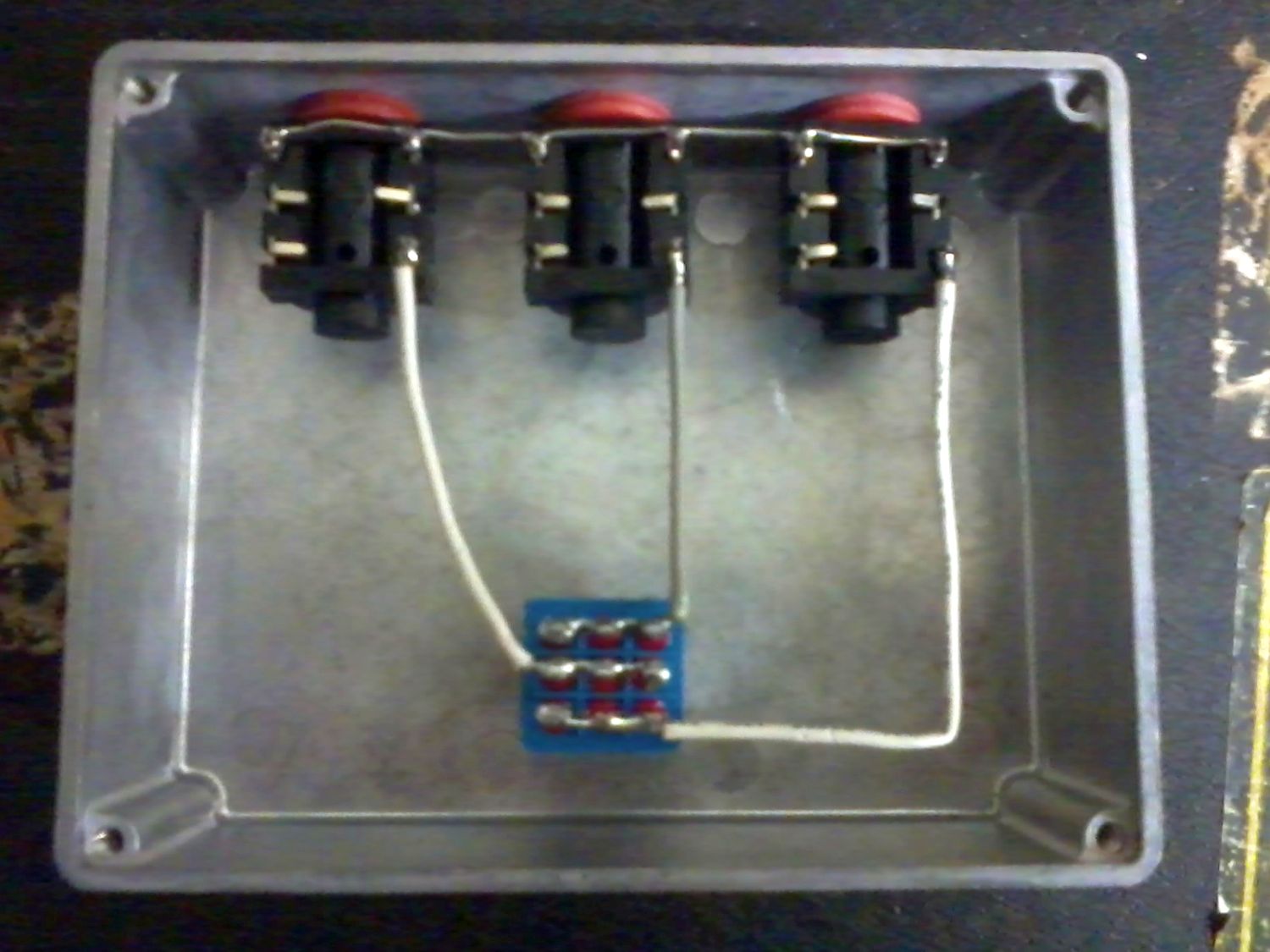

    I'll be uploading a couple of pics of my A/B Box build together with a wiring diagram and will also do a write-up of how I built mine, so stay tuned for more updates.
    Update:
    Here are the pics and the wiring diagram:
Name:	AB Box 1_resized.jpg

Name:	AB Box 2_resized.jpg
Name:	AB Box Insides_resized.jpg
Name:	AB Box Wiring Diag_resized.jpg

    Here's how I built my D.I.Y. A/B Box:
    1, First thing to do was to mark-out the positions of the three 6.35mm sockets and the 3PDT Metallic Footswitch, I used a metal ruler and a red CD marker pen, you can see in the pics I posted where I chose to position them, although the positions are not critical to the operation of the A/B Box you do need to make sure the soldered connections don't come into contact with the lid of the box, feel free to use the pics as a guide.
    2, Once all the mounting holes have been drilled in the Diecast box, install the 6.35mm sockets and footswitches ensuring that all mounting nuts are tight.
    3, Using some tinned copper-wire, I linked all the S lugs on the 6.35mm sockets together and soldered each of the lugs to the tinned copper wire as shown in the pic, the tinned copper-wire is the ground wire for all the sockets.
    4, Referring to the pics, using some stranded-wire connect the T lug of the in socket to the centre solder-lugs of the footswitch, make sure you have the footswitch oriented as shown in the wiring diagram, I soldered the wire to all three centre solder-lugs but you don't necessarily have to.
    5, The two outer solder-lugs of the footswitch were then connected to their respective T solder-lugs on the other two 6.35mm sockets using a couple more pieces of stranded-wire, again refer to the pics I uploaded.
    6, Once the wiring-up was completed I put the lid back on the Diecast box using the 4 screws that came with the box.
    7, Lastly I stuck one of the square rubber adhesive feet to the lid of the box next to each of the four holes for the screw that attaches the lid to the box.
    That completes the assembly of the D.I.Y A/B Box.

    Here's how to check if your newly-built D.I.Y. A/B Box is working as it's supposed to:
    Using a Digital Multimeter set to a low Ohms range, touch the tip of the Black probe to the T lug on the input socket, then touch the Red probe to the T lug on each output socket, you should get a very low-ohms reading on one of them, note down which output socket gives the low-ohms reading, and an infinite ohms reading on the other, next press the metal actuator of the footswitch so that you hear a clicking sound and repeat the test with the Digital Multimeter, if your A/B Box is working correctly you should get a low-ohms reading for the opposite output socket to the one you noted down, if so, your new D.I.Y A/B Box is working correctly and is ready for use, if not you might have gotten the footswitch incorrectly orientated.
    Hope that helps.
