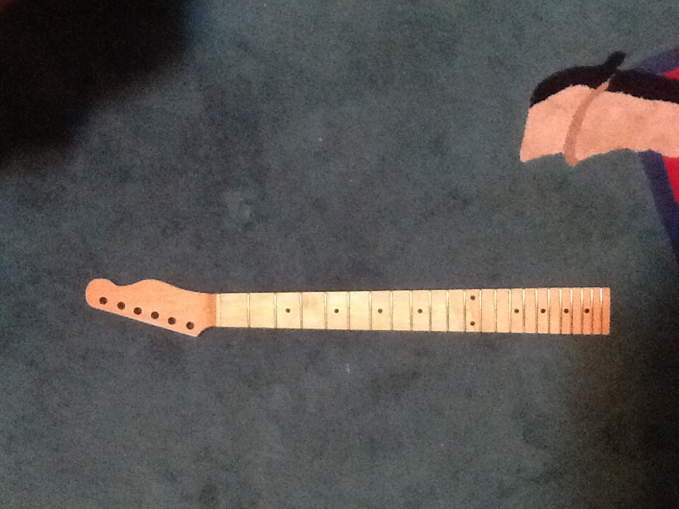

    I wanted to build a Tele style guitar as a base to hot-rod :-)
    I pick a 67 headstock shape from the shapes on the inter-web, it fitted the paddle pop with the least modifications .
    The headstock is cut and the neck has a few coats of Tung oil.
    You have to wait 24 hours in between coats so it's an exercise in patients.
    1st pic

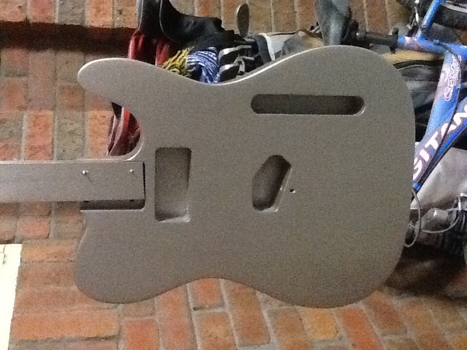

    Here's a pic of the body with a Champagne Metalic Glow top coat ( Holden car colour )
    Early stages

    ah didn't see this build diary.
    Body looks great Bruce.
    so clear coats going on that now ?

    Yep, Woka the clear is going on and then I will sand and polish it.
    I'm a beginner at this and it's been great fun.
    But it's a continuous learning process ;-)
    Cutting the headstock was a buttock clenching moment, I was really pleased with the results.
