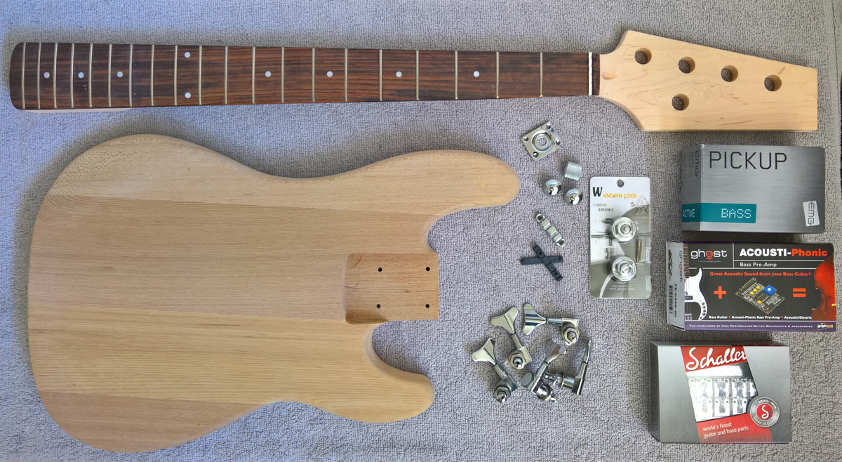

    The plan for this build was for a reasonably stock P bass, but to add some mods that I've been thinking about for a while ... namely a Piezo bridge. I've been a fan of Ned Steinberger for a long time (still own a Steinberger bass I bought in the 80's) and thought that the inclusion of a Piezo pickup in his later instruments was an interesting idea ... thought I might give it a shot and see what the result sounds like. I was also interested in ditching the scratchplate and doing the routing for the pickup and at the back for the electrics myself. I contacted Adam and, after a couple of back-and-forward emails he helped me decide on a 5 string P bass, with the body made from Ash, with no routing apart from the neck socket.
    While I was waiting for the kit to arrive I also acquired all the hardware that I wanted to use on the build:
    Schaller Piezo bridge, GraphTech Ghost pre-amp, EMG P5X active pickups, Warwick Just-A-Nut and straplocks and replacement Tuners (not a big fan of the flappy paddle stock ones)

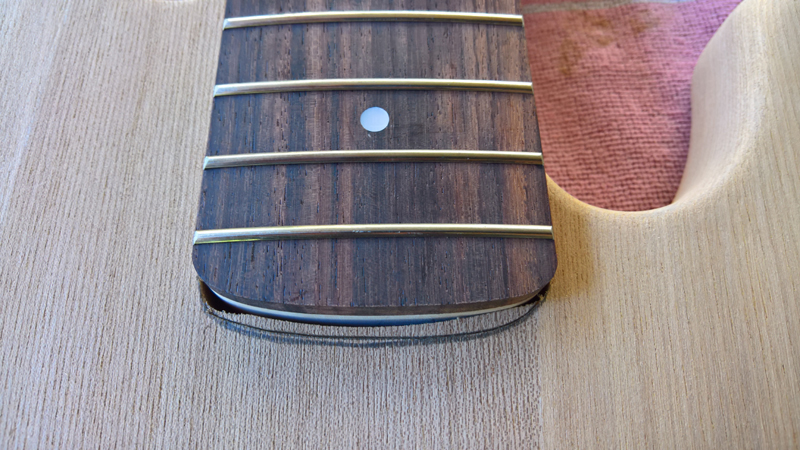

    I spent some time today working on getting the shape of the neck pocket right, attaching the neck and measuring out the location for the bridge.
    The routing for the neck pocket from the factory wasn't shaped properly and I wanted to get it as good as I could, since the plan is not to use a scratchplate, which could possibly hide any imperfections.
    I marked out the shape and used the Dremel ... pretty happy with the result ...
    Before and After ...

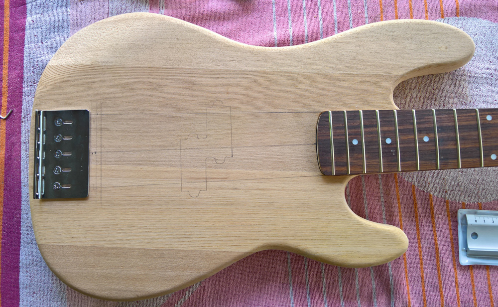

    Once the neck was on I measured out the placement for the bridge and split pickups and then attached the bridge ...
    I spent a lot of time making sure the bridge was perfectly square with the neck ... the pic below makes it look a bit squonk because of the camera angle ...

    Are you 100% happy with your bridge position, because it does look a touch orientated towards the treble side to me? The Schaller bridges do allow for some side-to-side saddle adjustment, but it's best to double check now, before you go any further. As you say, it may just be the camera angle.
    I'd also just mark out the position of the magnets for the EMGs (they are shown in the installation instructions), to make sure that the strings fall within their boundaries with the pickup locations marked on the wood. The B/E/A side has a wider magnet than the D/G side. At the moment it looks like the top and bottom parts of the pickups are symmetrical about the centre line, and it may be necessary to offset them a bit in order to get an even magnetic coverage, and not have the middle A string being picked up by both halves and so producing a louder signal than the other strings. The EMG drawings say they show the magnet placement but state that you should be sure ensure to align the magnets with the strings in order to ensure even pickup. I'd imagine that ideally, the ends of one pickup's magnet should align with the end of the other pickup's magnet (but EMG don't state this, so it's hard to know if this is correct or not). However I'd have thought that the E string should sit fairly centrally on the B/E/A magnet, whilst the D and G strings should sit the same distance from the centreline of the D/G magnet. Passive 5-string P-Bass pickups typically have a much larger B/E/A pickup than the D/G so you can see the offset. With the EMGs they've made the housing the same size, but have a mismatched magnet size, so it's less obvious as to how they should be positioned.
    If you've already done the above, then great and all's well. But if not, then it's worth a quick double-check now, before you've started routing out. Just want to make sure by asking questions now, that there aren't any nasty surprises at the end.
    Thanks for the great advice Simon ... I'll definitely get the EMG diagrams out and do some more measuring before I commit!
