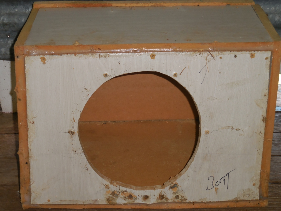

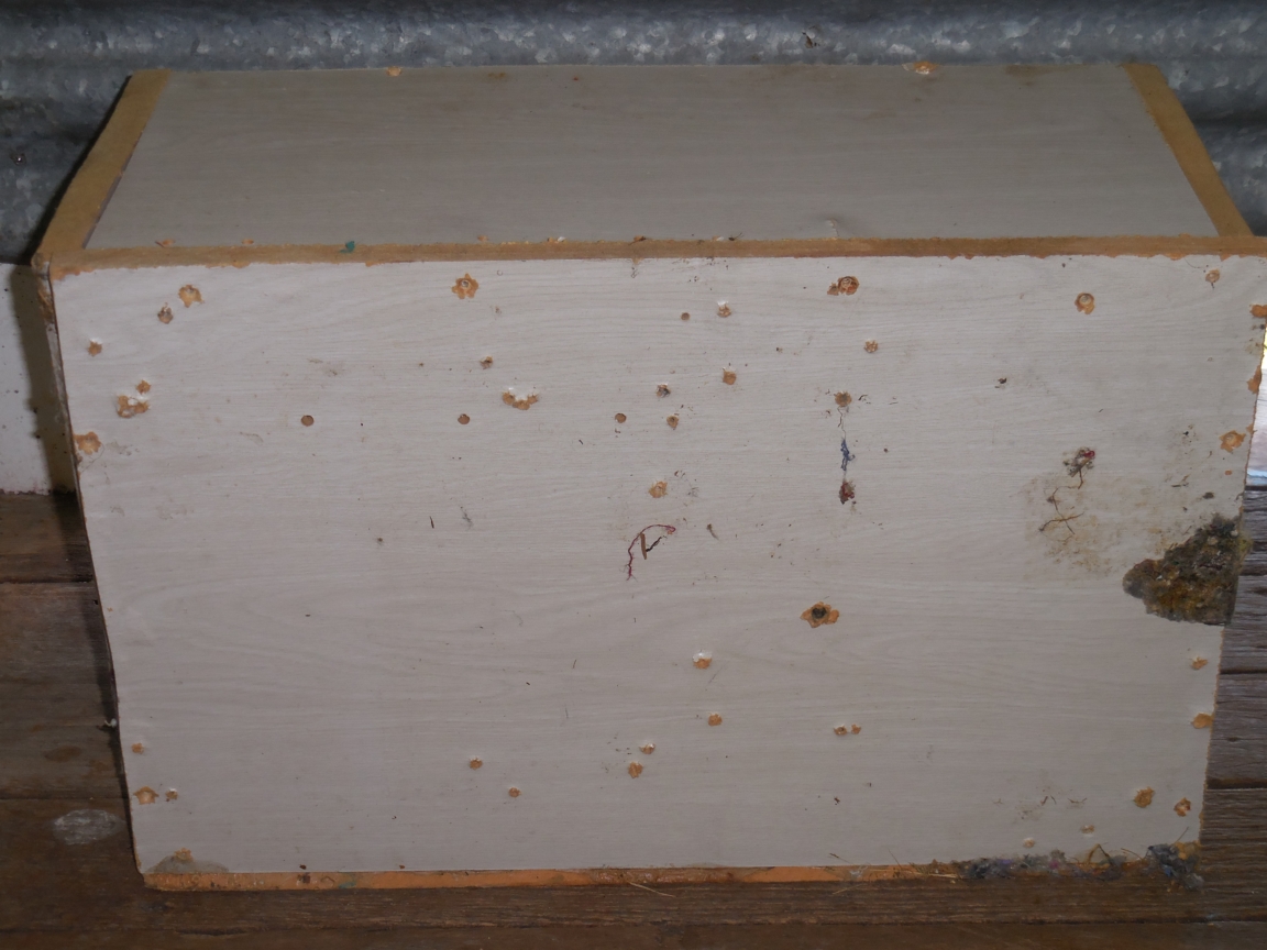

    DrNomis - I just pulled it out of it's "cabinet" - 10mm MDF, silicon all around the seams. Those are screw holes too, btw. Not bullet holes. Thankfully the unseen part of the speaker looks like it had more love. As for the details...
    500W max, 250W nominal. 4 Ohms. Free air use sub woofer. model TS-W254F. Made in Mexico.

    should make a good guitar amp Ndroid, plenty of power. The cabinet could use a bit of tidying up, maybe fill some holes and a paint job !
    Being a subwoofer will probably be more suited to a bass amp so it won't have the high frequencies of a guitar amp
