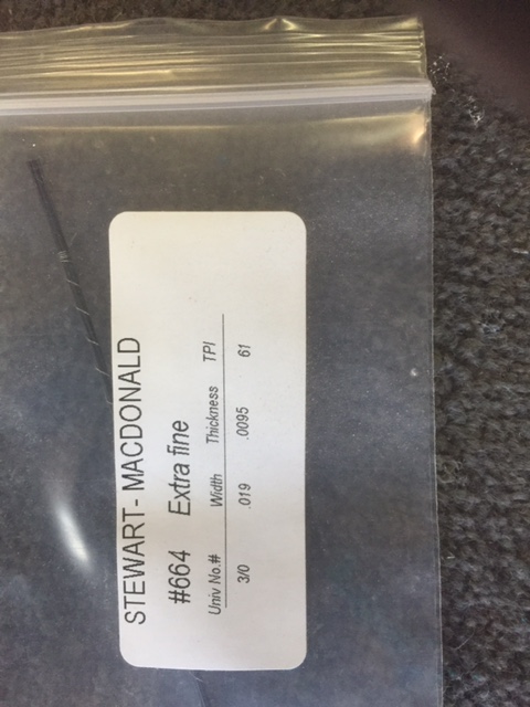

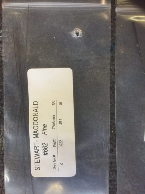

    You need some Jeweller Blades. These are the ones I get from StewMac. As you can see they are very thin. Comes in pack of 10. And they have around 50 to 60 teeth per inch that you will use to cut on the DOWNstroke.
ID:	5280   Click image for larger version.

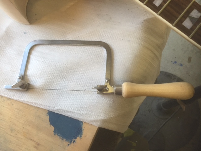

    Now, if you have some Jewellers blades you naturally will need a Jewellers SAW! (Go figure!)
    Here is mine acquired from Australian Luthier Supplies.

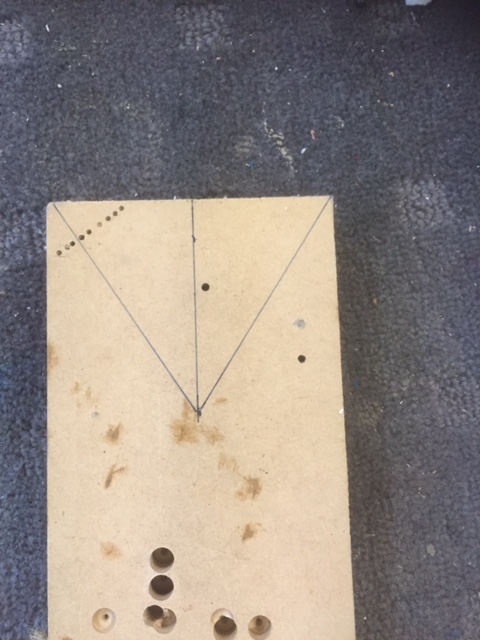

    Next up, we need to make a 'birds beak' out of wood. This apparatus will be used to position the MOP on top of the jaws of the beak so that you can begin to cut your MOP.
    Below I have marked out roughly the shape of the beak on the wood. (I have used a scrap piece to show this.)

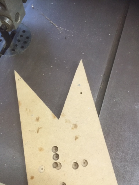

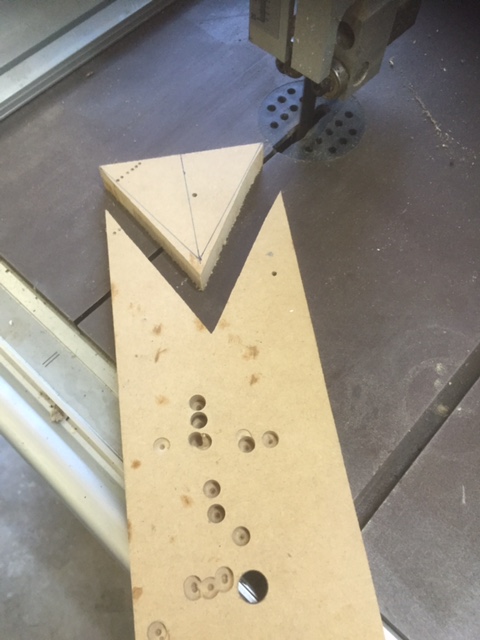

    Off to the band saw, but any saw (other than your brand new Jewellers saw will do). And cut out the beak like so!

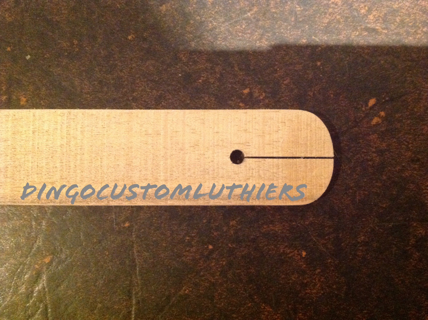

    This is my shell cutting doovalacky, a different take on the theme but it works well.

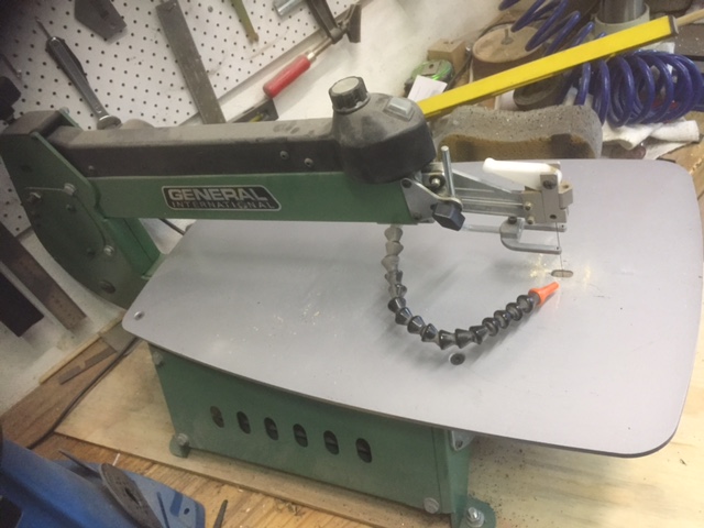

    MOPsupplies are indeed terrific and the only ones I use! Of curse I mean of course the USA wont supply anyone outside of America so really great we have a local distributor!
    This is my Pearl shell cutting doovalacky...... (Having an issue with my picture uploads all of a sudden... apparently unless I took them with my phone they are not formatted correctly....
