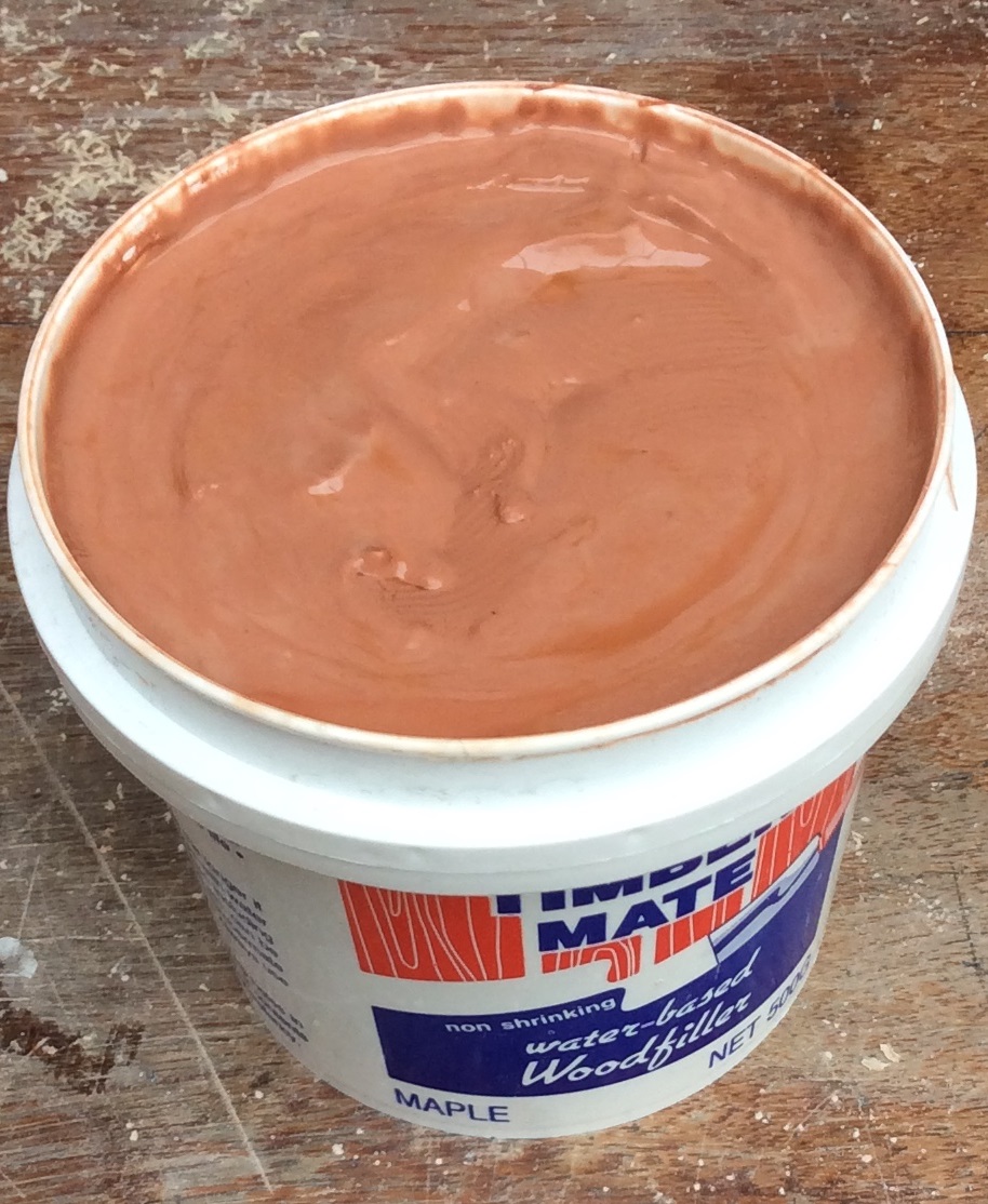

    A word of caution that Maple TimberMate is not very maple-ish in my experience. WeirdBits has suggested that Pine TimberMate may be a better alternative in my IB-6S build thread http://www.buildyourownguitar.com.au...ll=1#post86643 .

    good tips Sarge I remember your post now about maple timbermate, colour looks way off although it should lighten a bit when dry but woudn't be any where near maple colour by the looks
    It tends to dry to more of a salmon colour. Similar to Maple grain lines, at a stretch, I suppose. There is a rather bad image of a patch attempted with the maple TimberMate in the post that the image above was originally posted in.
    Black is my happy colour
    sure Sarge, salmon colour would look terrible between black inlays and the maple fingerboard

    You may want to stabilise any Timbermate with some CA glue as well. Apply after the Timbermate has dried.
